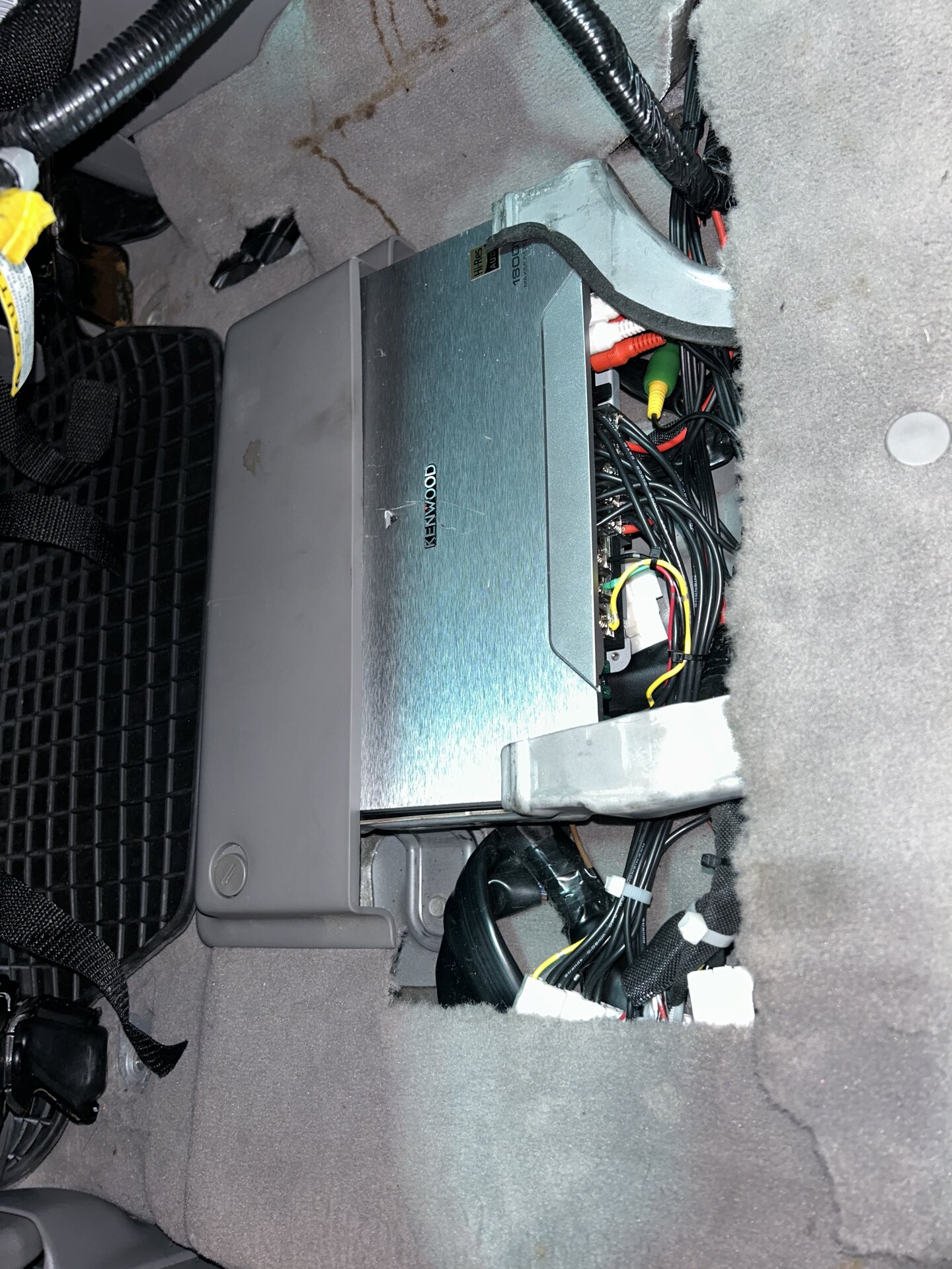

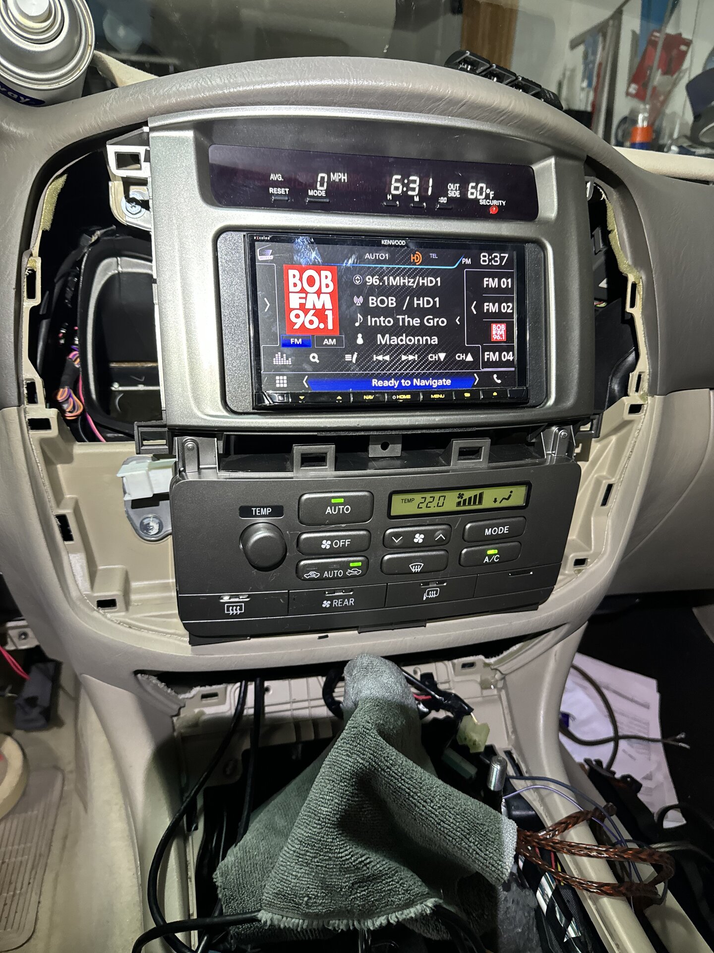

Kenwood X802-5 or XM802-5 is the perfect selection for the aftermarket amp. It can fit to factory navigation brackets. You can even reuse the cover for it.
Do you have a write up on how you wired/connected the amp?? Im getting ready to swap out radios to a 10" android (i have a factory non-nav truck and previous owner swapped in a double din already)

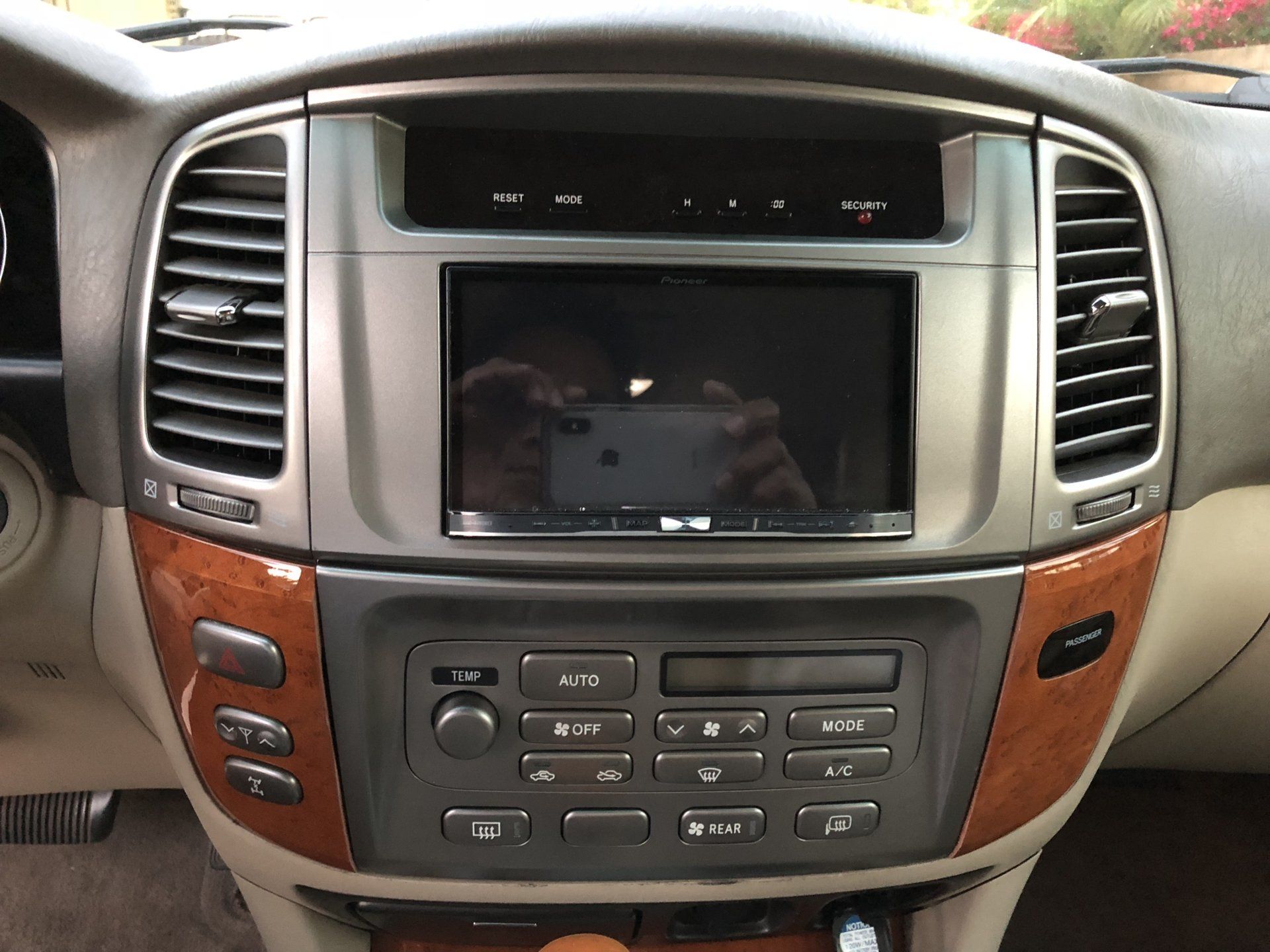

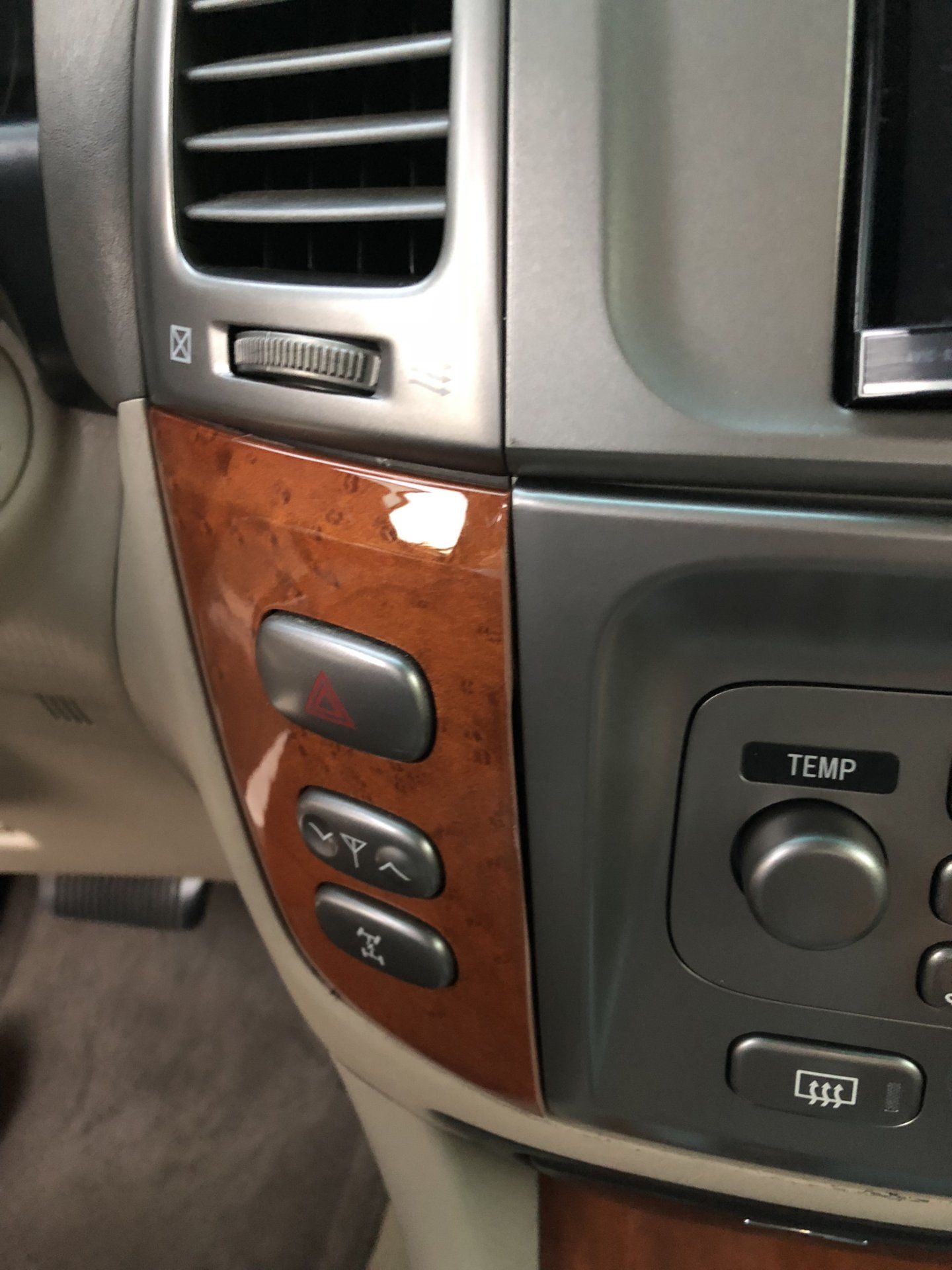

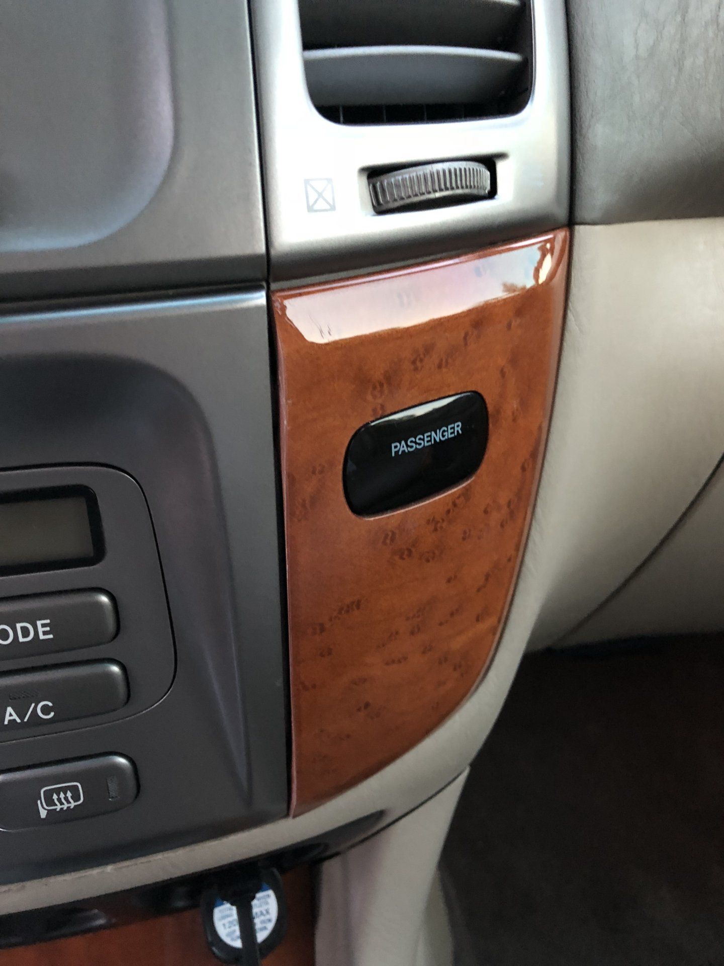

Got the spare wood dash from e-bay and carefully went to town with the hack saw. Here are the results. Not to bad..... I wonder if I can return the side vents.
I love this. My side trim for the nav delete weren’t fitting great and i like this look better anyway. Nice job. As soon as i work the kinks out of the nav delete to make sure i don’t have to convert back to the old stuff, im doing this. Nice job

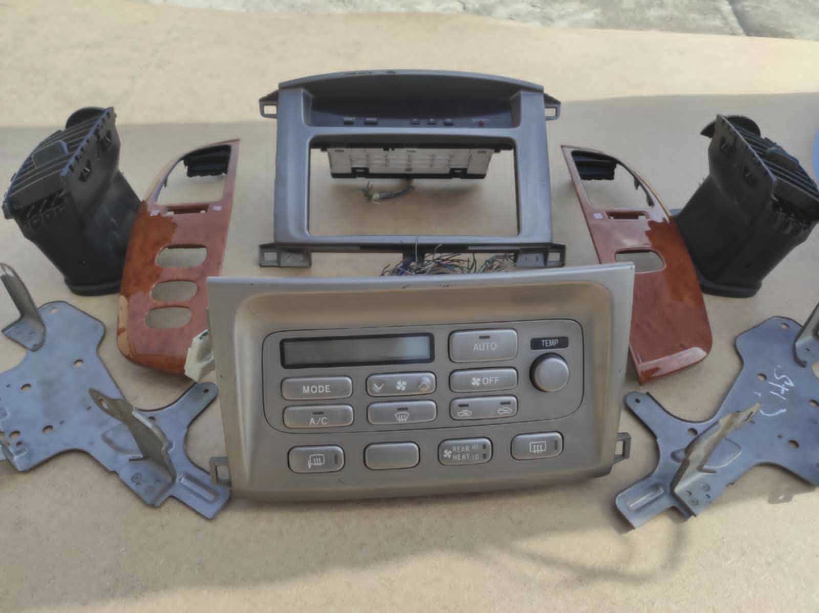

I can get all of the parts shown in this pic for those wanting to do a swap. These are of course used parts since new stuff isn't available any longer. The parts will come with the plugs and wire pigtails. Send me a PM if you're interested and we can chat.
Does that include the elusive AC amp?
It includes all of the electronic parts needed for the swap.
