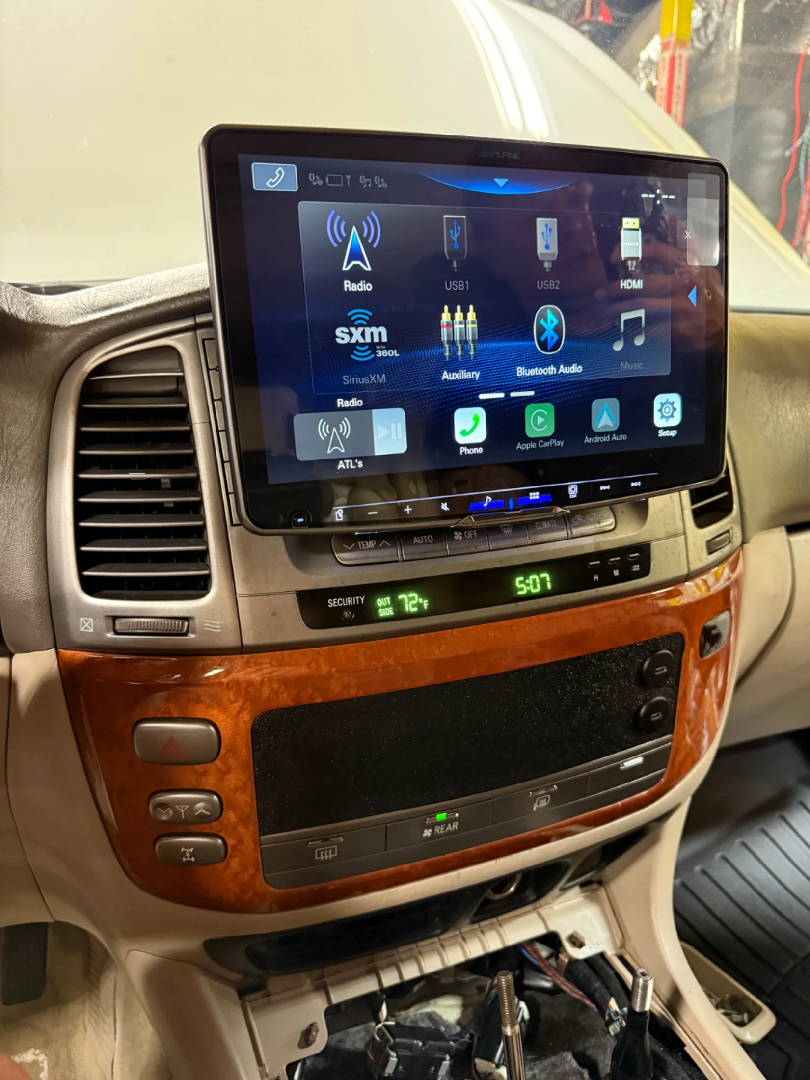

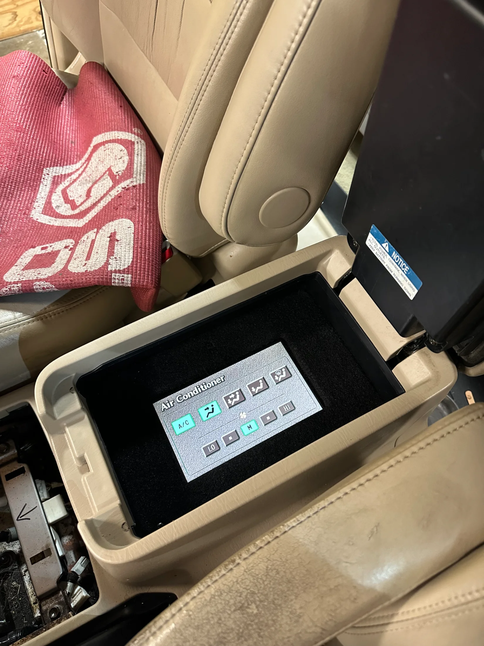

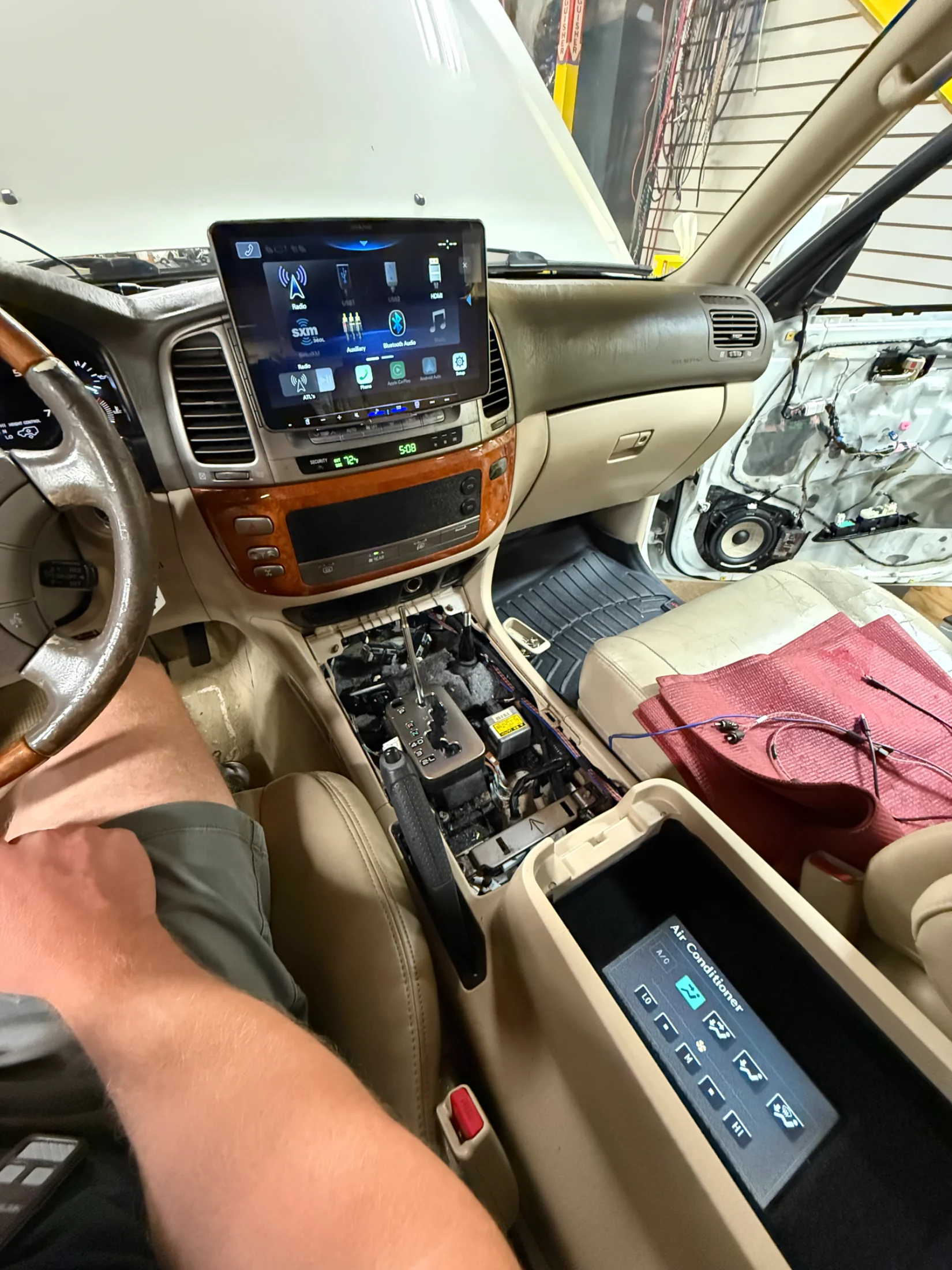

Gentlemen. I present to you a relocated screen. CarTunes in Atlanta just knocked this out of the park. Not done yet. Alpine Halo going in a few days. Just deleting the entire factory audio. They got this far in a day. Pretty impressive.
So to adjust your HVAC you have to open your center console. The side push buttons are to remain in their original locations and are to still b e functional, just the screen was relocated? What about the GPS? will the screen in the console default to the GPS and still pop up the "Agree" screen you have to hit every time you start the vehicle. Assuming then that your new stereo will go in the old screen location
I haven’t gotten that far yet. I’ll keep you posted. But also for HVAC, it’s insanely rare that I actually need to adjust it, I’m almost always just using the temp buttons.

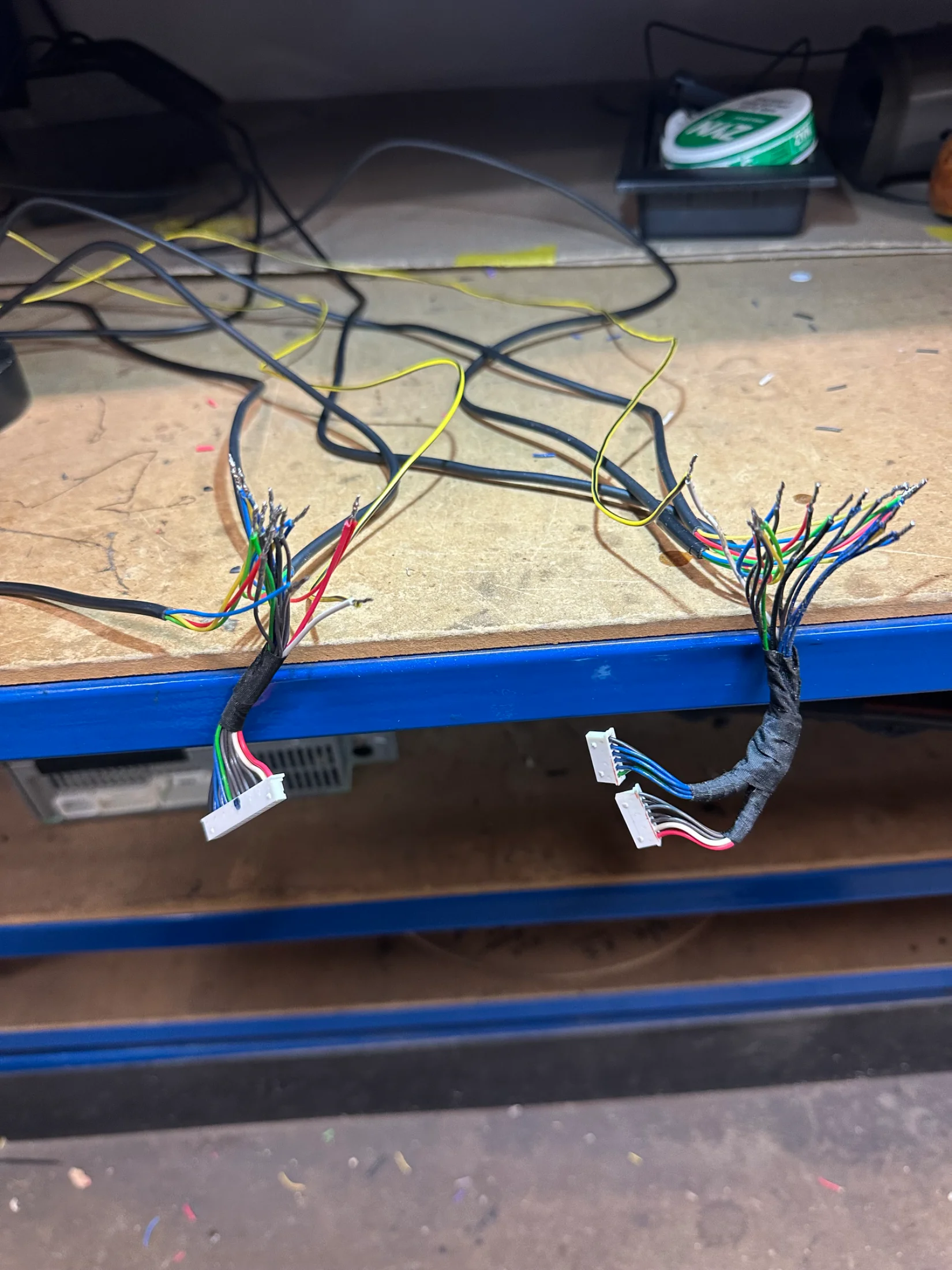

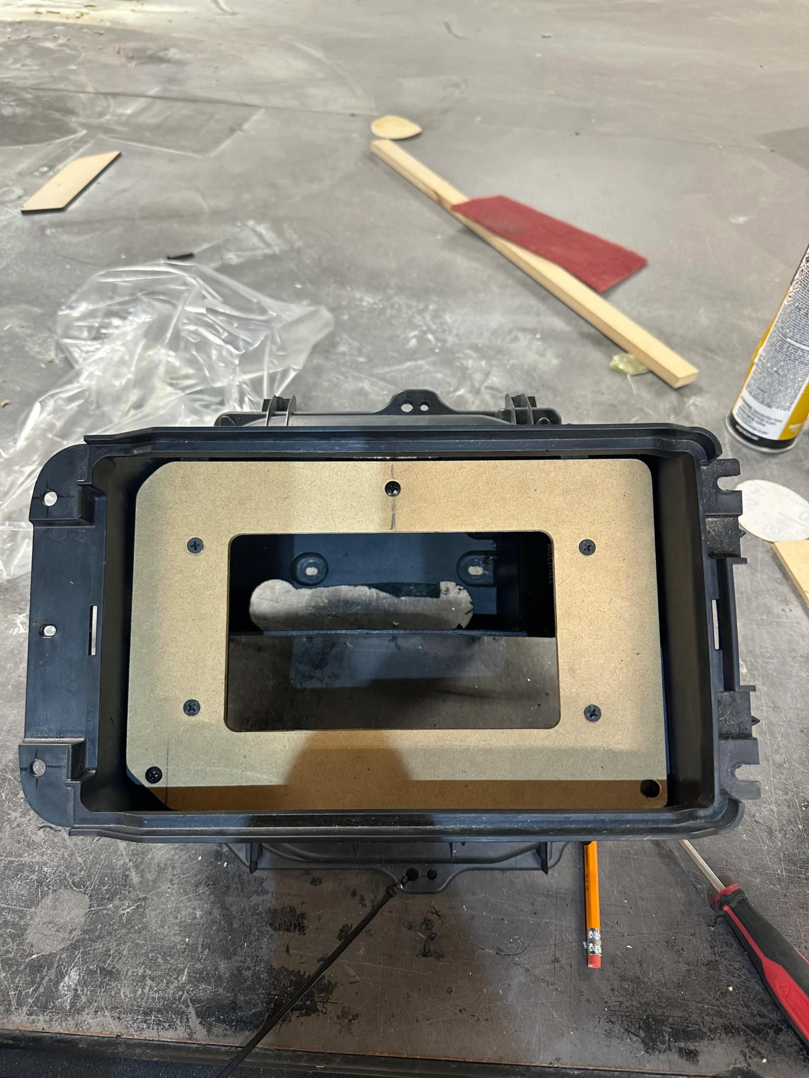

Hi All - I recently sold my 2003 LX and have the full kit available for those interested. See pictures below, I have the:
  • AC Amp, housing and controls from a RHD vehicle
  • Brackets
  • replacement LH/ RH AC vents for a Tan interior (new)
  • Wiring adapter harness from Jerryb for an LX with 4 connectors in the back of the screen
  • Front facia
  • Center console w/o DVD player
I purchased these for a TAN Interior 2003 LX. You will have to cross reference the part numbers to ensure it will work with your exact year. I do not have the clock/ computer, however these are still obtainable.
Located in Northern NJ. Local pickup is preferred but can organize shipping.
DM if interested.

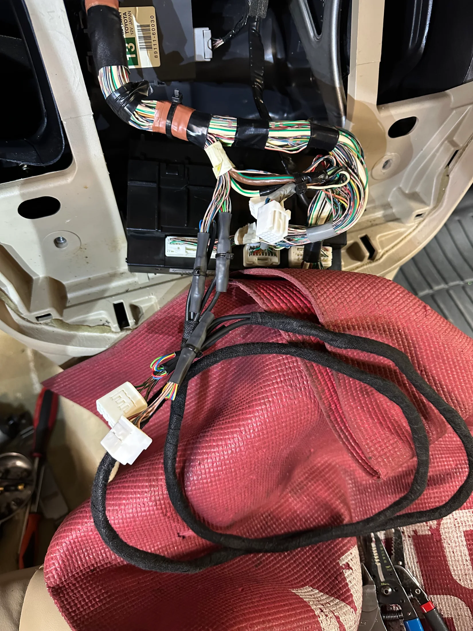

Squ1dward, I watched your conversion video and as I recall, you mentioned that the 03 LC and the 04 LC have a different connector(s) on the back of one of the components. One component had two connectors vs one I think....This would mean the Jerryb harness may not work for an 04? Does that ring a bell?
yes...that does ring a bell. I believe the connectors jerryB sold were for 04 and beyond. The LX uses a different connector. The LC uses an M9 connector out of the trip computer whereas the LX uses an M12. That is one difference.
The other one, and this is the one I think you mean, is C28 connector that comes primarily out of the A45 connector. My 03 required me to splice into the factory wires, whereas the 04 and beyond should be able to use the C28.
Hope that makes sense.
The pin outs are updated from Jerry's on the google drive link I have in narrative below the Youtube video. That should take away the mystery.
Here is the link: Nav Delete wiring and component list
Good context. I clarified my post above. My nav screen had 4 connectors.
