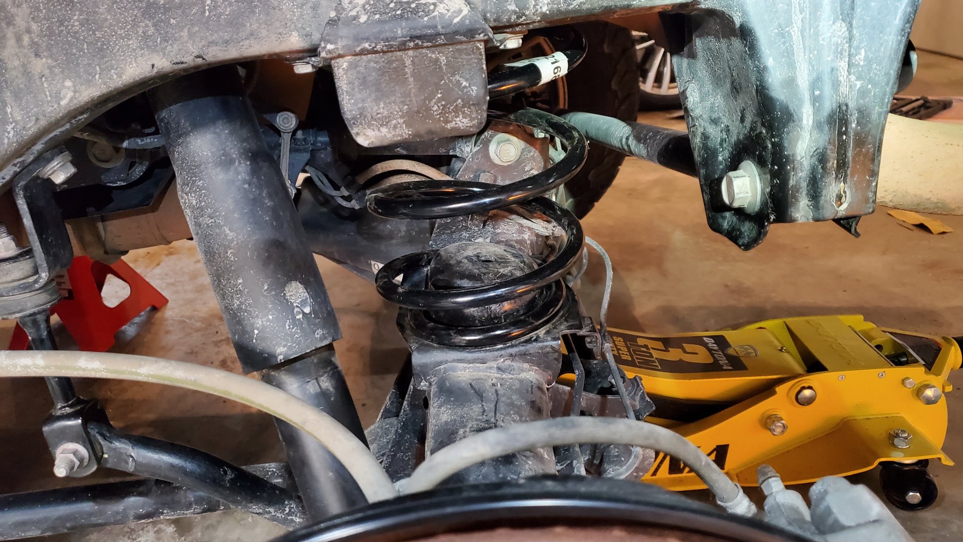

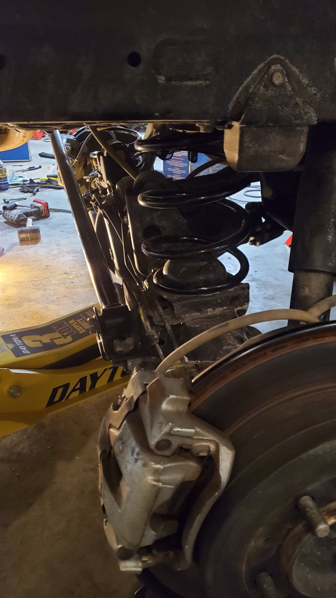

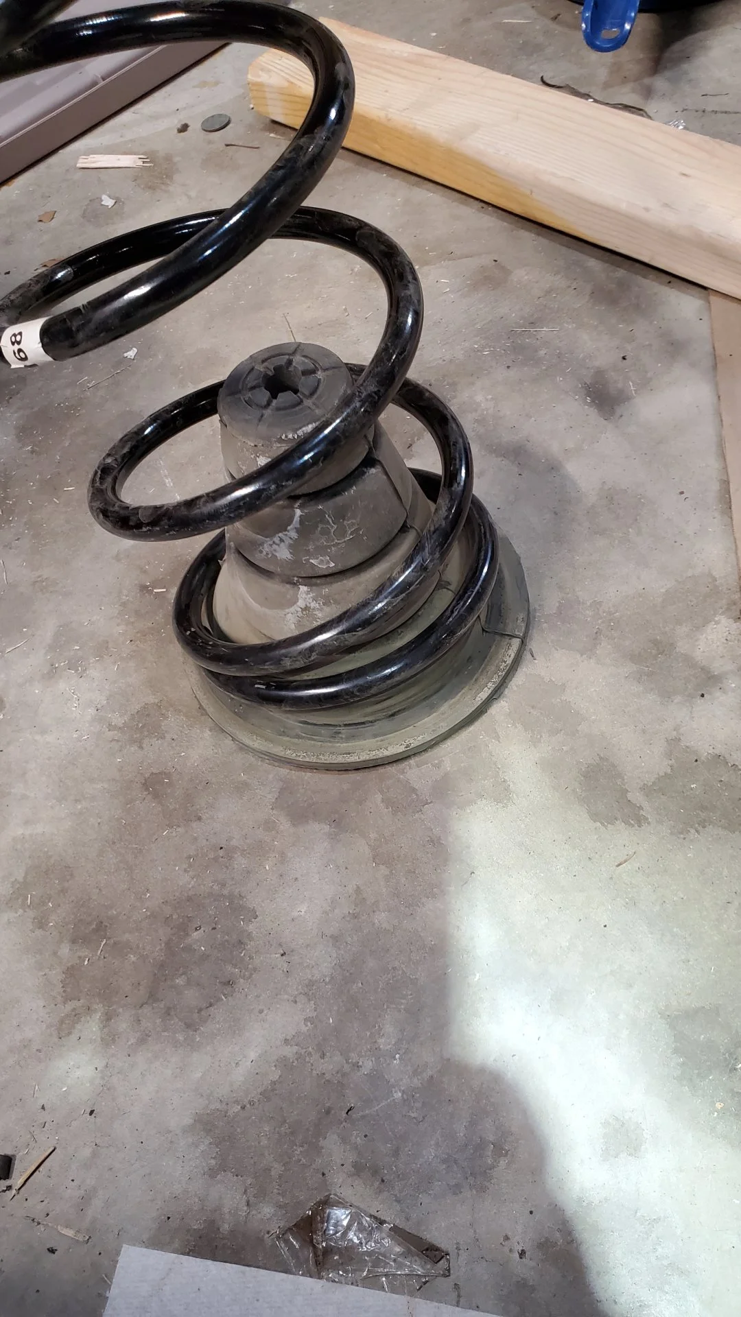

So I am installing TrailTamer springs and I ran into some difficulty.
The mounting cap that goes on top of the spring is a tad larger in diameter. It fits the stock springs nice a flush, but it is slightly large for the new springs.
@1world1love did you have this issue? I suppose once it is in place the weight of vehicle may push it in, but due the slight gap I am having a hard time inserting the spring Into the vehicle. I would like to have it sit flush before inserting it
Here are pictures of driver side stock and the new spring.
Yeah, I believe the diameter is just slightly smaller. In full disclosure, I had a guy at a local shop help with mine and when I noticed this I started freaking out a little but he just used a little white grease and it took a bit of effort but they seated.
Ic. White grease it is then. Wish me luck because I was freaking out a little. I have a 1500 miles round trip starting tomorrow so I wanted to get it installed and tested during a long trip.
Good luck. Of you can get the springs in then they will naturally seat, but it is a task. I should also mention that I immediately had my alignment checked and it was spot on, and you will probably be fine too, but there is a chance that you may need an adjustment at some point.

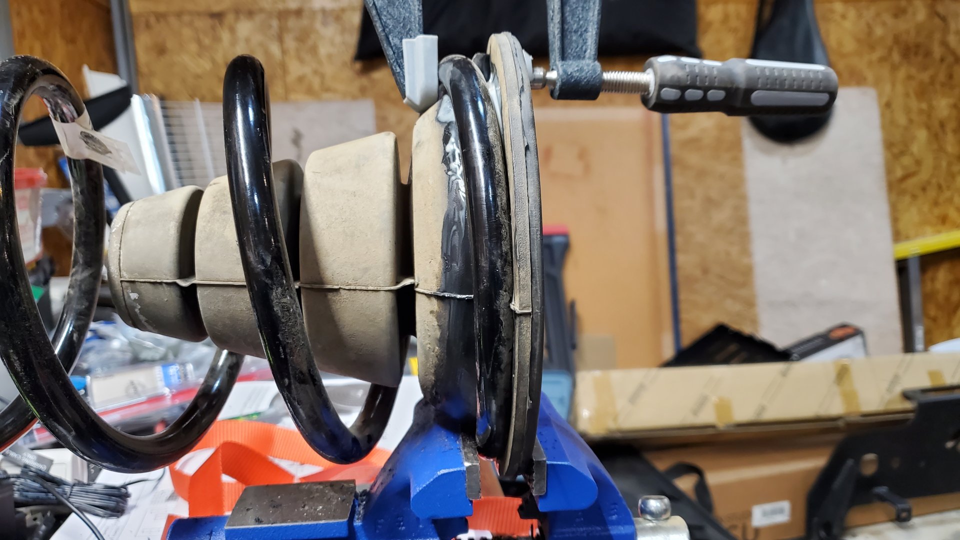

This is how I got it to sit. It worked for driver side.
Did not for passenger side. May be its too new.
I suspect as spring compresses, it should slightly increase the radius and with compression it should go in. I just hope it won't crack the plastic.
Weird. Mine was tight but it fit. Are you in a cold shop? It was 95 degrees when I installed mine. Maybe contracting slightly in the cold? Maybe a combination of tolerances plus the cold?

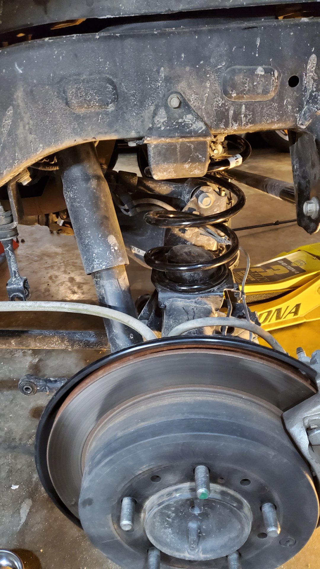

Just finished installing. It was like 50 degrees in the garage so that may be the reason why it was so much harder. This is a new vehicle so may be the rubber mount was not as pliable. Combination of both I suppose.
Just went for a 20 mile test drive. It drives really nicely
It's not harsh at all. It does not bounce as much as did before and seem to corner better as well. I am very pleased.
AHC seem to operate quicker to go to H, but I will have to test some more.
Going to L did take longer, but it did reach to L. I don't use L, unless I need to get into a garage with lower ceiling.
Overall I am very pleased so far. Tomorrow I will be going for a 10 hour drive through some twisties over mountains so that will be a test. I will have to take it offroad to see how it handles there, but I think it will do fine.
@1world1love thank you for the recommendation. This has worked rather well.

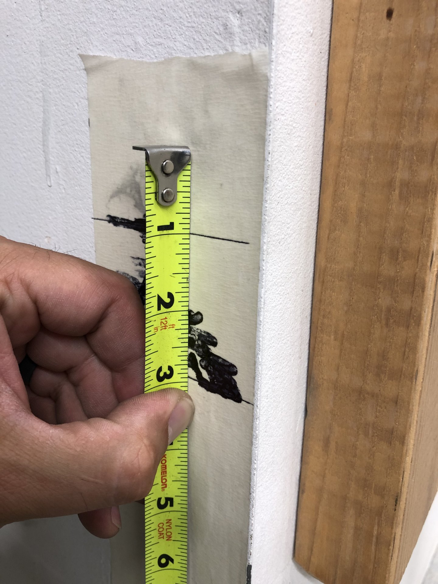

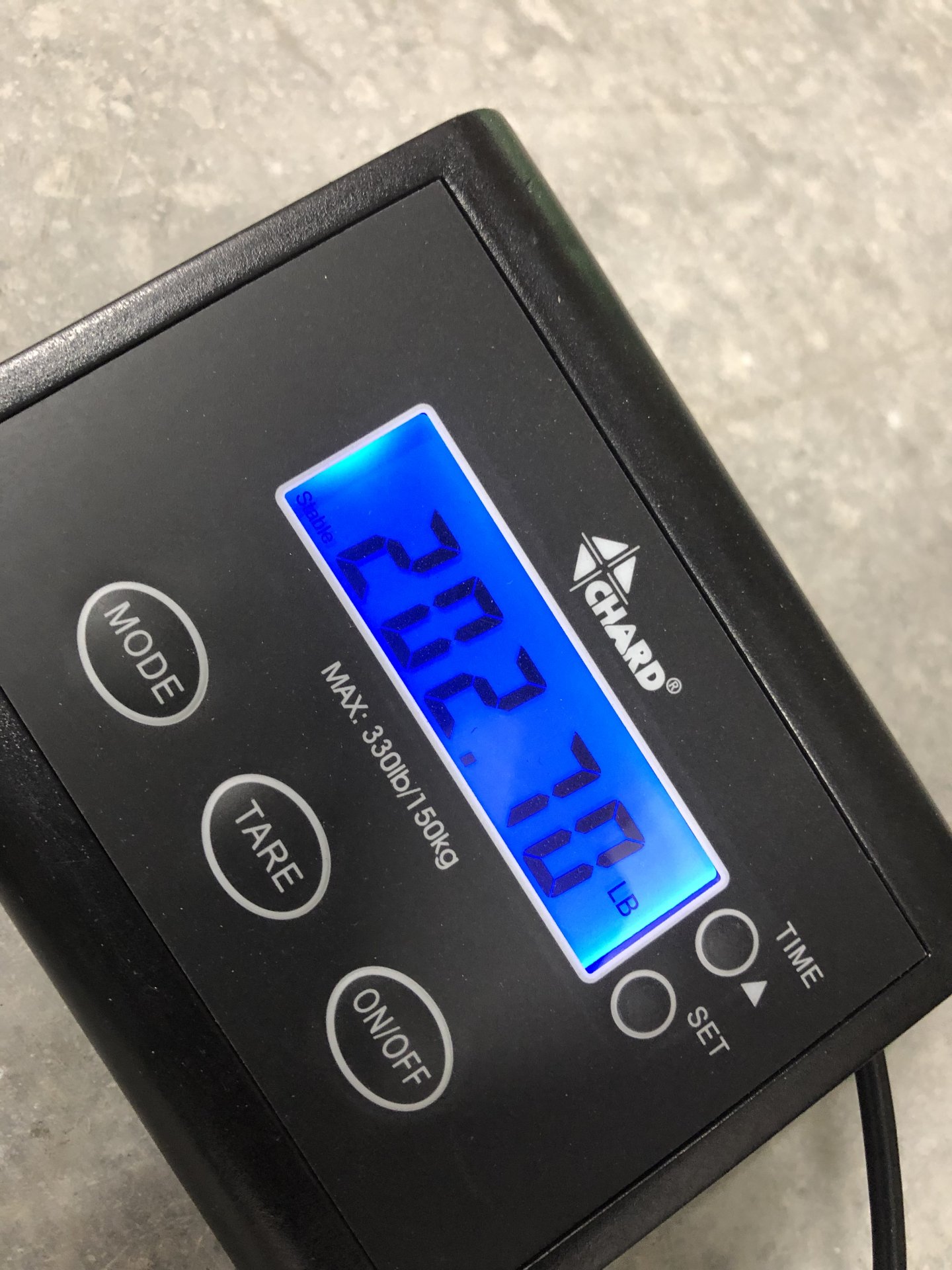

My 202.7lbs compressed this stock (218k mile) rear LX coil 1 15/16”
Practically 200lbs & 2” and definitely some room for error in my little foot attached permanent marker 🤪 but hopefully something to work with.
