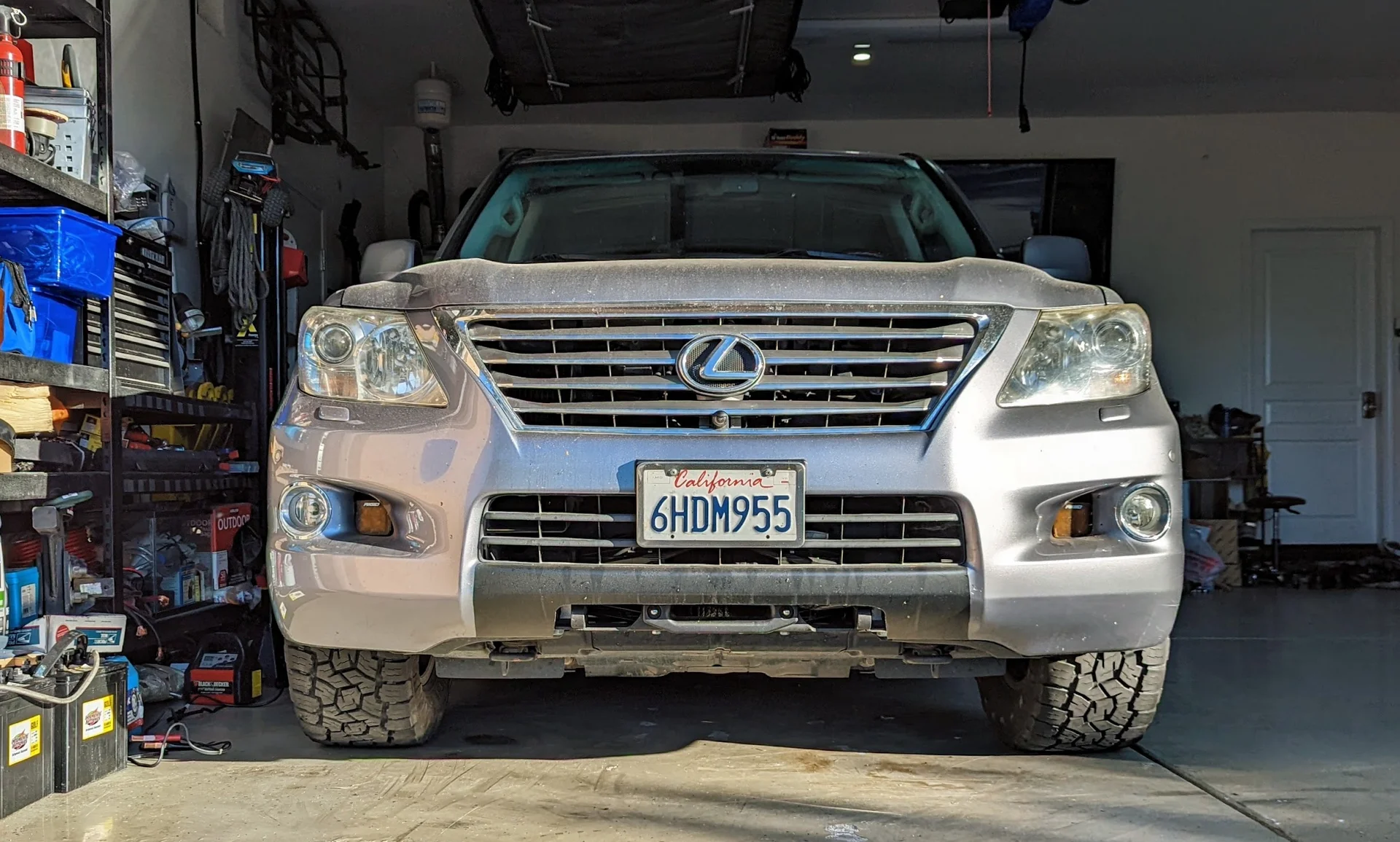

May be not. I installed the LX570 rear springs on LX470, the rear end rode on bump stops without AHC. LX570 is heavier than LX470, the chance of a LX570 not on bump stops without AHC is slim.
That boy dont have a clue what hes talking about...
Falls to bump stops. This would be 2" lower if she were on stockies (instead of 35s)

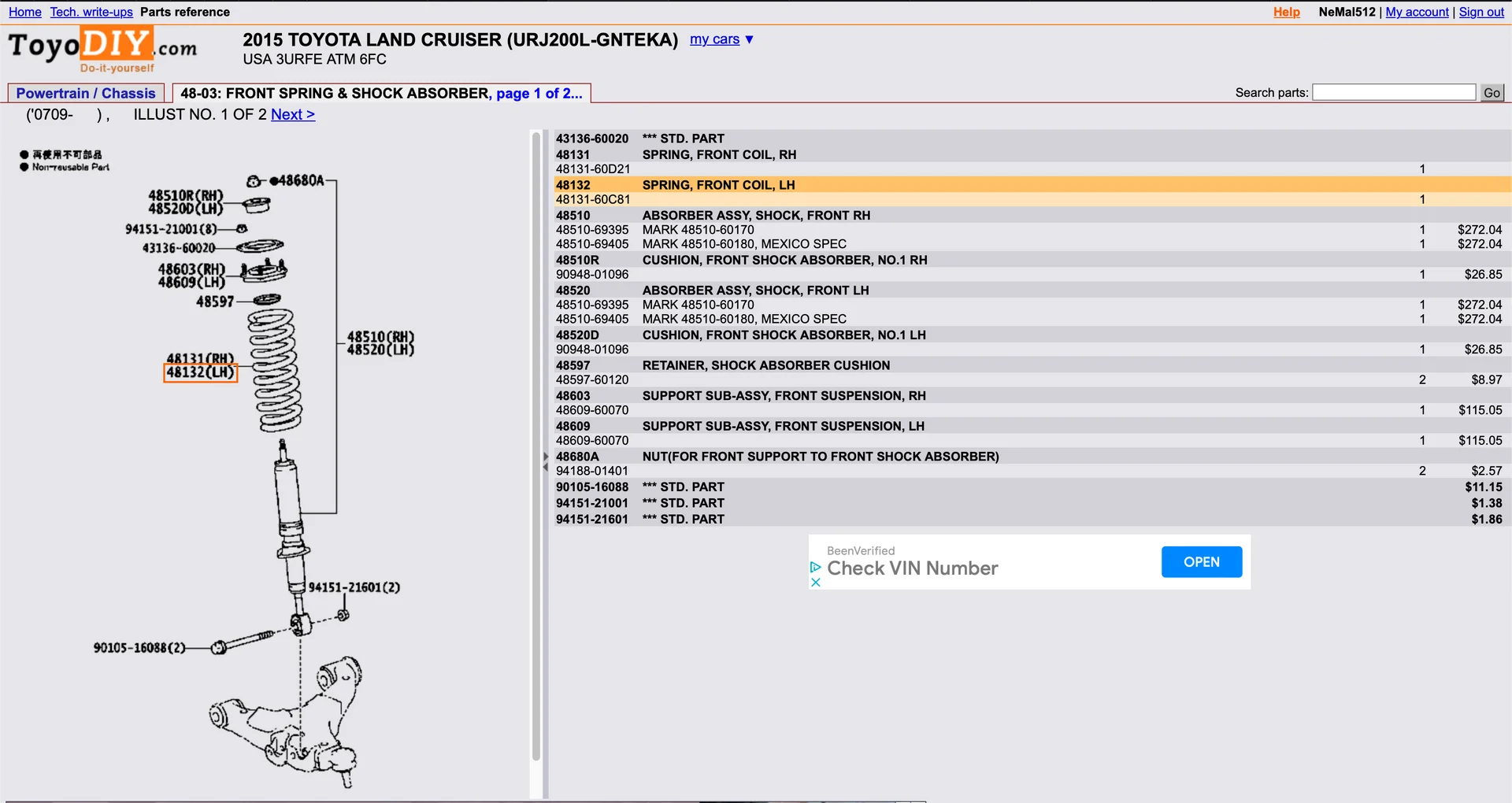

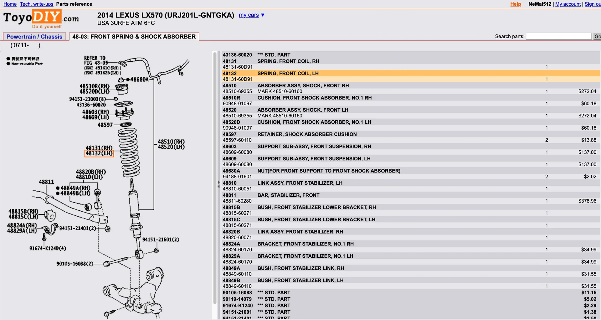

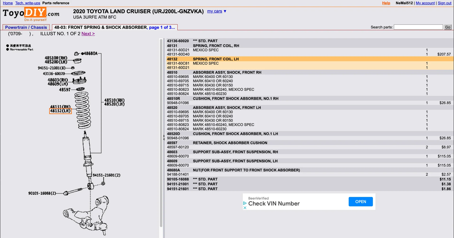

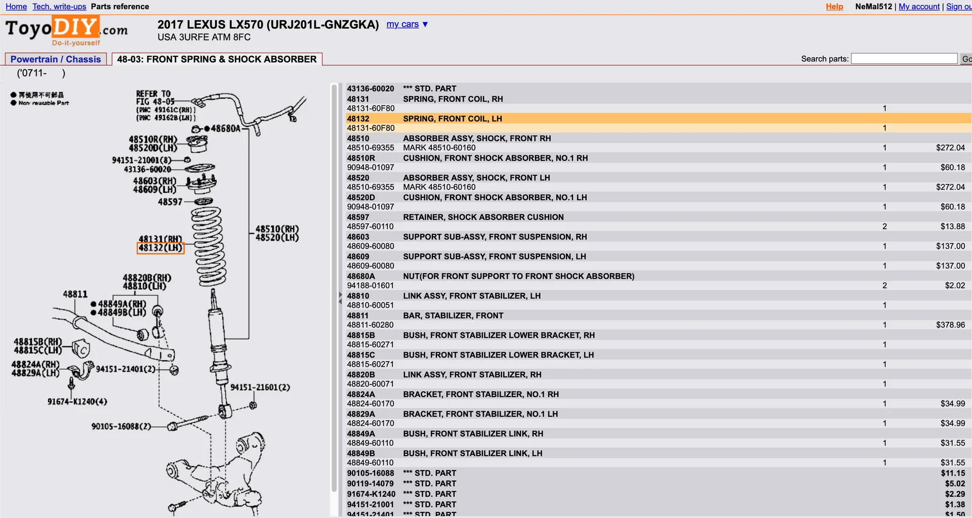

2014 LX - 60D91
2017 LX - 60F80
Same on the LC:
60C81
60D21
Can one of you forum losers show me your struts?
screenshot-2022-12-10-at-4-19-07-pm-png.3190159
Something did change. The 2016+s are just so different... Never drove anything prior though so maybe your coils are indeed softer???
Or is it just a part number update? Cant be if it happened on both 200/201 with the redesigns.
From what i can see, curb weight didn't change in the LX. But the 6,000 lb. even number makes me think its not real.
I scaled at around 6,300.

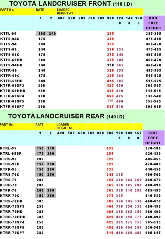

What about these King KTRS-95? Stock height replacement 80 series rear coils. I can't find a spring rate though, slightly more than stock 80 I am guessing.
Depending on the year, the 80 rear springs seem to be in the 130 to 150 range.
If there was both a taller and slightly stiffer spring set i would probably be interested down the road.
Currently like my setup but ideally, the compression would continue past where my preload stack would limit travel upwards. Not that ill ever use it, but maybe one day 🤔.
