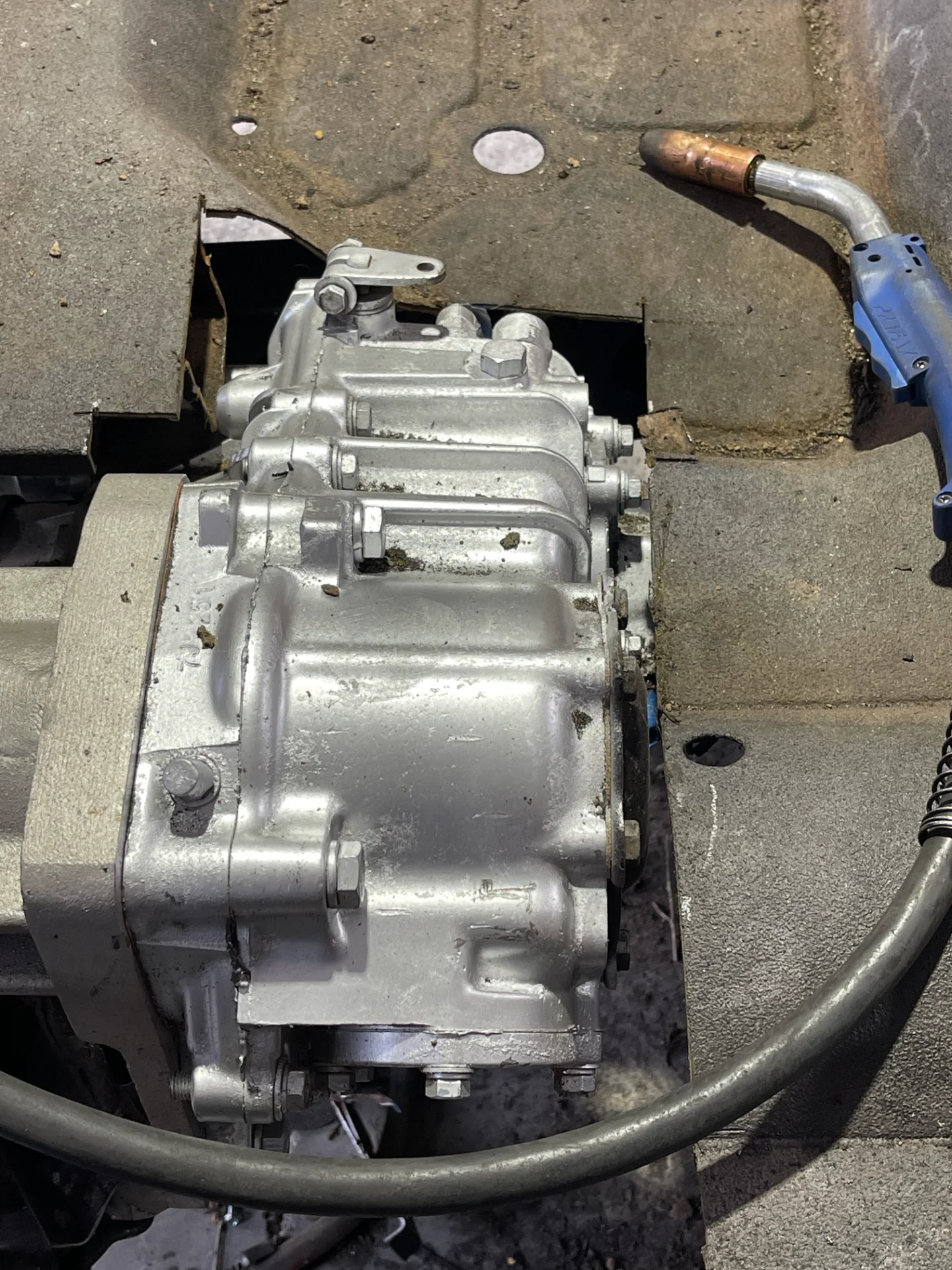

So, with doing the LS & automatic transmission swap (4L60E) and the electric power steering and using the original steering column and box, the LS & transmission had to move over to the passenger's side about 1" to clear everything. With running the vacuum style split case, the vacuum actuator sits too high to run my OEM stock gas tank in it's original location. If we drop the t-case below the frame rails then it's only about 6" from the ground. Anyone have any solutions? @cruisermatt have you run into this problem before? Or @Jdc1 have you run into this before? Did you guys get a different gas tank and relocate it, or did you drop the t-case lower and reduce the ground clearance, or another solution?

Just replied to the last thread. - For the way you’ll use your rig- look into adding the S10 blazer tank in the rear of the frame. It even has the spot for the GM FI pump module which will save $time$. You’re metal guy looks capable enough to relocate the fuel fill.

This is a great thought. I forgot about that option.
I actually have this setup for mine and decided to go in stock tank due to the fact I really wanted to move my rear axle back eventually.
