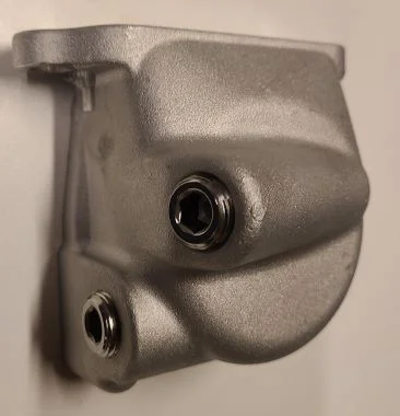

within the last few weeks someone posted up replacement for the lower with the sensor holes
here it is:

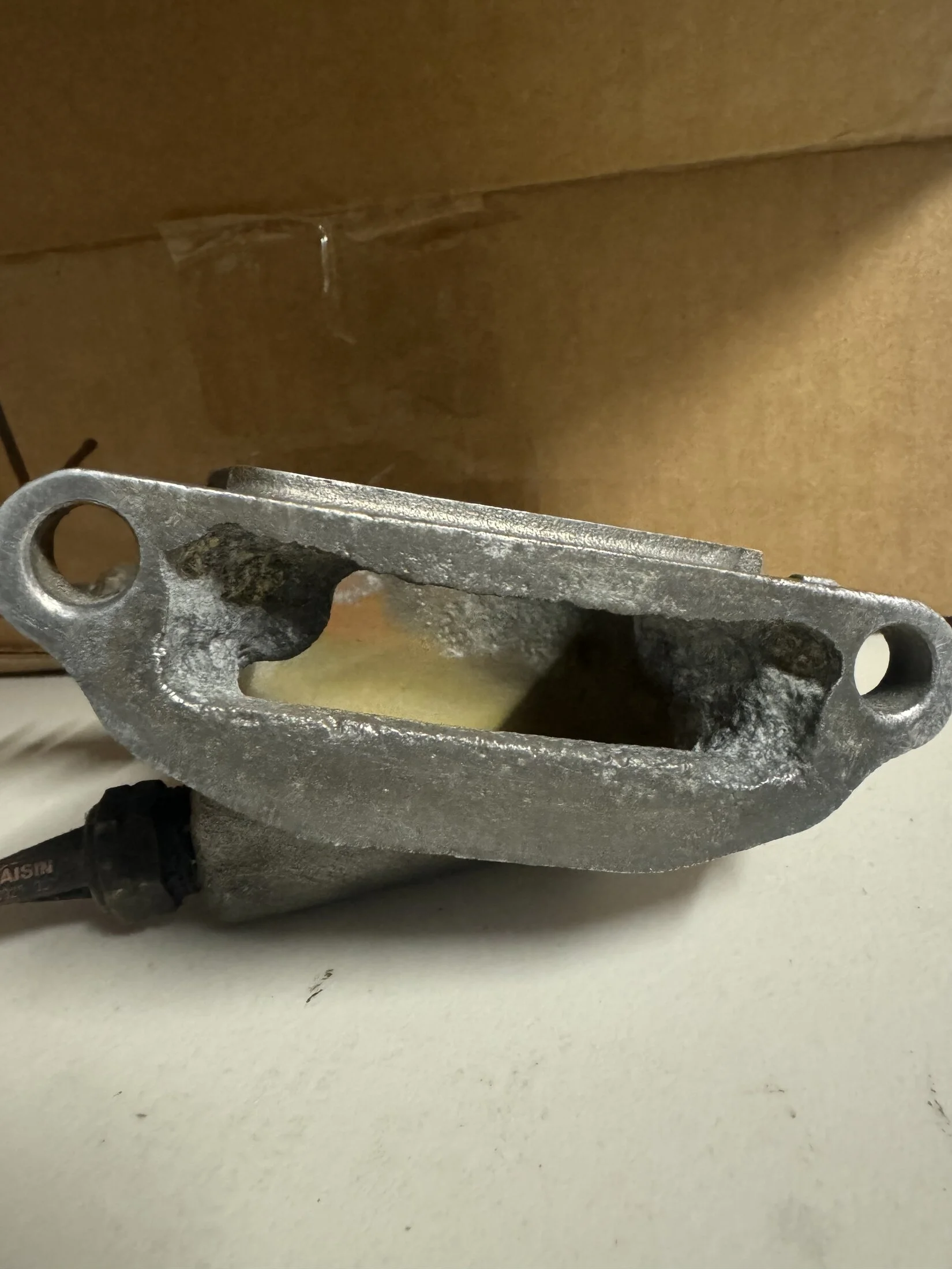

From what I can see in these pics, those housing halves are totally serviceable. Clean the ugly off and drive on.
Mark...
Find someone with a vapor hone, that should clean up nicely.
Replace the upper housing.
The thermostat rubber sealing ring that seals the top of the thermostat to the upper housing requires a smooth contact surface on the upper housing to make a tight seal.
No matter how much you clean it up, the sealing groove in the upper housing is so corroded and pitted that the rubber ring won’t be able to make a nice seal.

Not really. It requires a "smooth-ish" surface. It is rubber. It is compressed between the thermostat and the housing. It will seal just fine *if* the surface is less than optimum. *If* there is a minuscule amount of coolant seeping past between the seal and the housing surface, that is really irrelevant anyway if it is not full pass through. If need be, a very badly etched surface can be reconditioned with a bit of epoxy. Or simply use a bit (not a lot) of good quality sealant/adhesive between the upper housing and the rubber seal prior to installation.
From what *I* see in the pics, that is the crud covered seal that is still in the upper housing. I personally can not discern the condition of the aluminum surface underneath it. Even if it is in fact the housing surface, there are such a large amounts of deposit on it that I would not guess the condition until that is all cleaned off.
Most of the "corrosion" in the pics is additional material that has developed/accumulated, rather than erosion and removal of the original underlying aluminum.
Mark...
I cleaned it up and not much surface left at all. I ordered a new one from Rust Farmers. I ordered a new Toyota upper. There is little trim to create a good seal. 39 years was a good run I guess.
View attachment 3616011View attachment 3616011
Okay NOW I see crazy corrosion ;)
