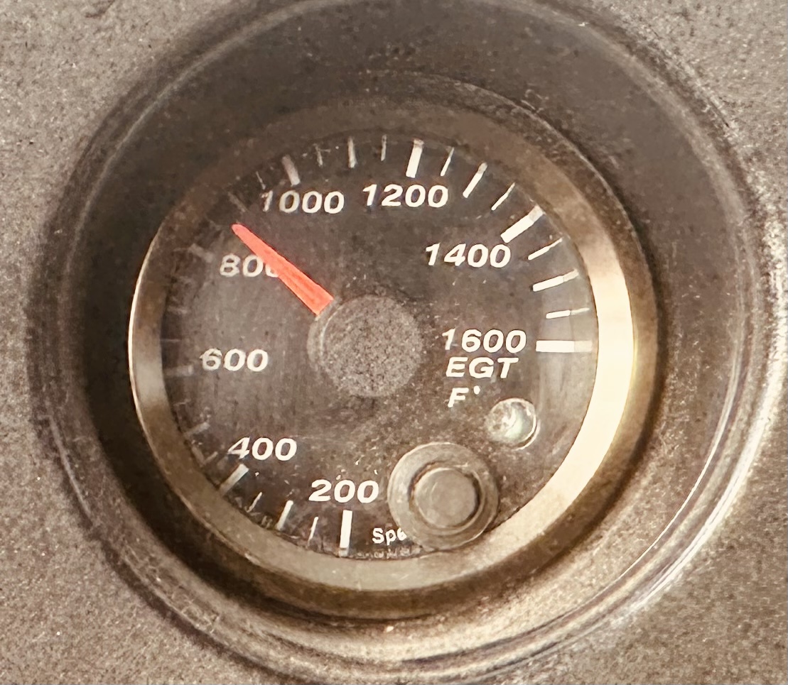

Im alive. All good news. BOMBED it over cameron pass today at 60mph almost the entire way and EGTs only went up to 1050 once for a short time but held. I was pushing it pretty hard. (FYI Cameron pass is 10,000ft on altitude)
Hit 14.1 boost on the 392 hill westbound. EGT’s didn’t go above 1000. Seems really happy with the new hose.

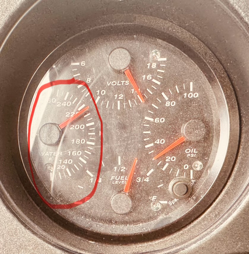

Took Hwy 25 North past Owl Canyon exit yesterday. 70mph. All good on boost and EGTs however I’m still getting higher engine temps than I would like. Was at around 218 when I returned southbound. Temp dropped immediately to 180-200 downhill.
So flogging and bombing sustained = 14.1psi and 1080 egt.
i envy those egt's

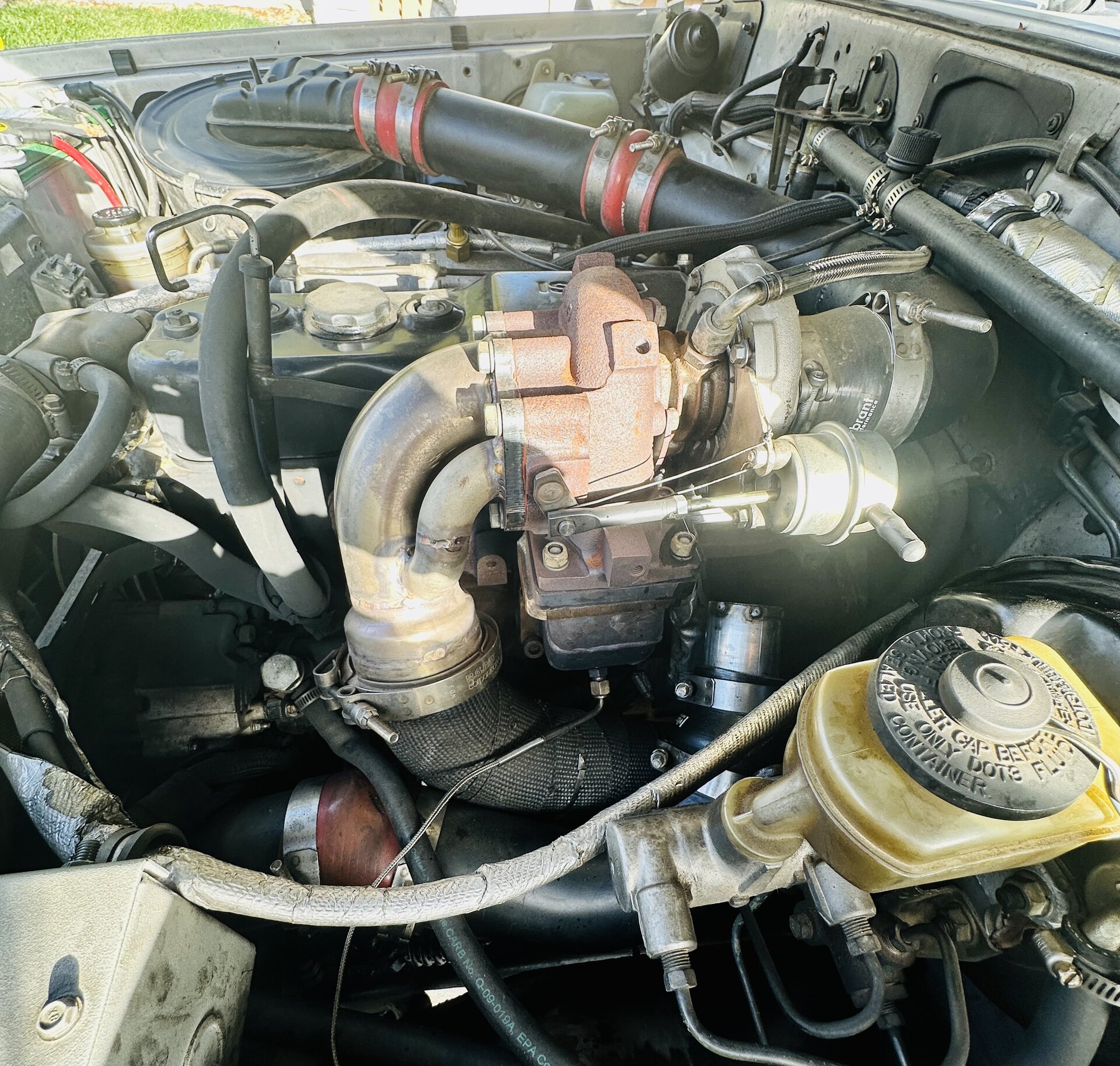

Yeah I still think something isn’t quite right. Maybe he can turn fuel up more, seems like it with the egts. It’s just hitting that wall at 12-14psi with the wastegate wired shut.
I think the cooling issue is mainly the electric Ford contour fans. He is also running 4.88s which I think are making the 4bd1t turn too high of rpm, that in combination with those fans causes the temp to rise.
could be a leak on the intake manifold gasket or exhaust manifold gasket or turbo flange gasket....
wired waste gate could still be leaking past a bit...

The radiator is a new aluminum unit, contour electric fans. He said on hills is when it heats up, coming back from New Mexico to colorado it was pushing 230 non stop. However egt are cool.
My thought was ditch the electric fans, go manual. See what changes that makes.
As for gearing, he could get a 10% overdrive for the split case so he’s more like 4.56 gears if that’s available. Not sure if it’s a big enough change but certainly cheaper than doing 2 diffs.
230⁰F is still OK if that's a peak temperature.
A good radiator cap that keeps things pressurised, and good coolant should still leave a margin of safety at 230⁰
You could call it good, and set up an engine temperature monitor with an alarm if coolant temps go beyond that

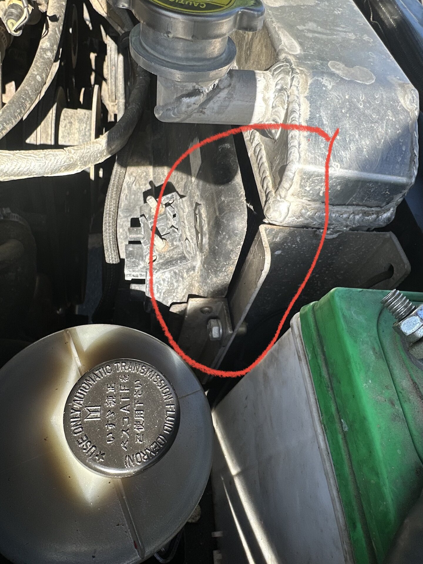

The fan/shroud is just a ford contour dual fan setup. Not the best fit.
My red markings were to have him measure room for a mechanical/clutch setup.

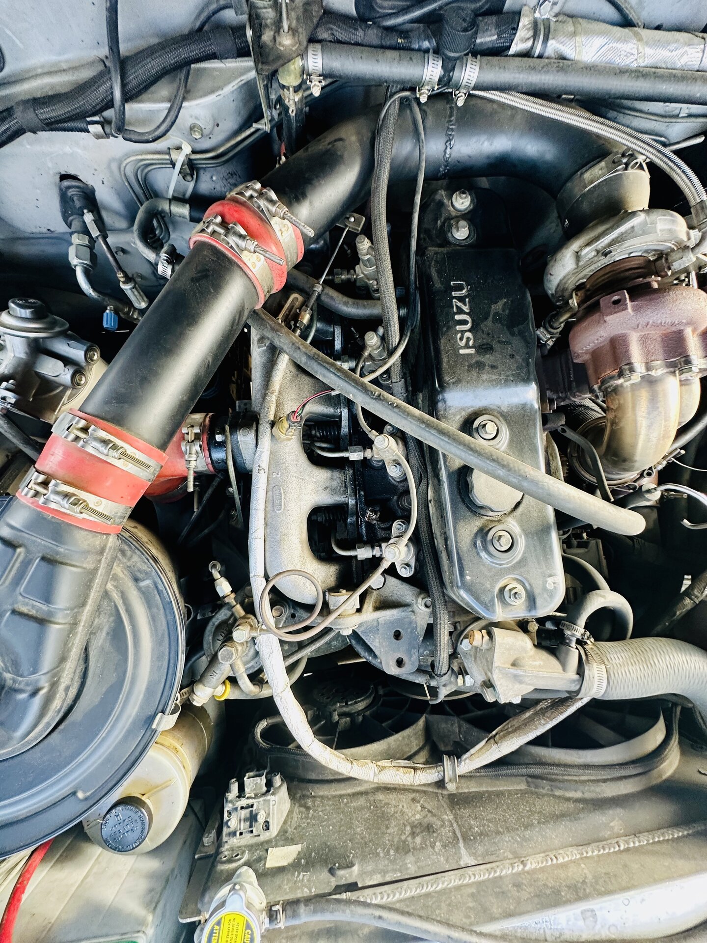

Engine bay:
As far as I know that’s peak, but he usually pulls over or slows to cool at that point.

Here’s the scenario. Driving Northbound on i-25 towards Cheyenne. Holding about 65-68mph. No cargo and about 15 gallons of fuel. It’s 60 degrees Fahrenheit outside. Boosting around 6 and hitting 13 on uphill acceleration. Plenty of power. My temp gradually climbs up to 220F. Same as if it where 100 degrees outside just took longer and didn’t exceed 220 as it commonly does in the summer.
