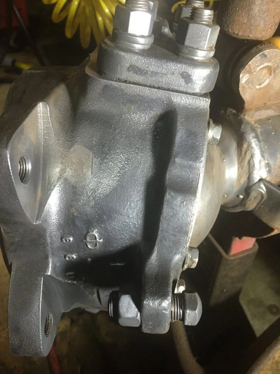

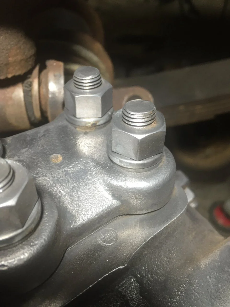

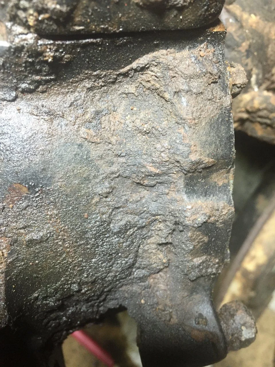

This thing is cleaning up nicely. Waiting on a few seals and gaskets for this front axle and some more detail work.
Probably need to pull the 3rd members just by looking at the s*** that poured out of the hubs......smh. 'Just a clutch'.
I agree with Grogan on this. Don't pull them unless they are leaking. What you gonna do other than clean them up while you have them out? The new gear oil will do that for you. Drive a little then drain and fill again. A lot less trouble if you ask me. We've pulled a ton of them and it's always kind of a pain.
