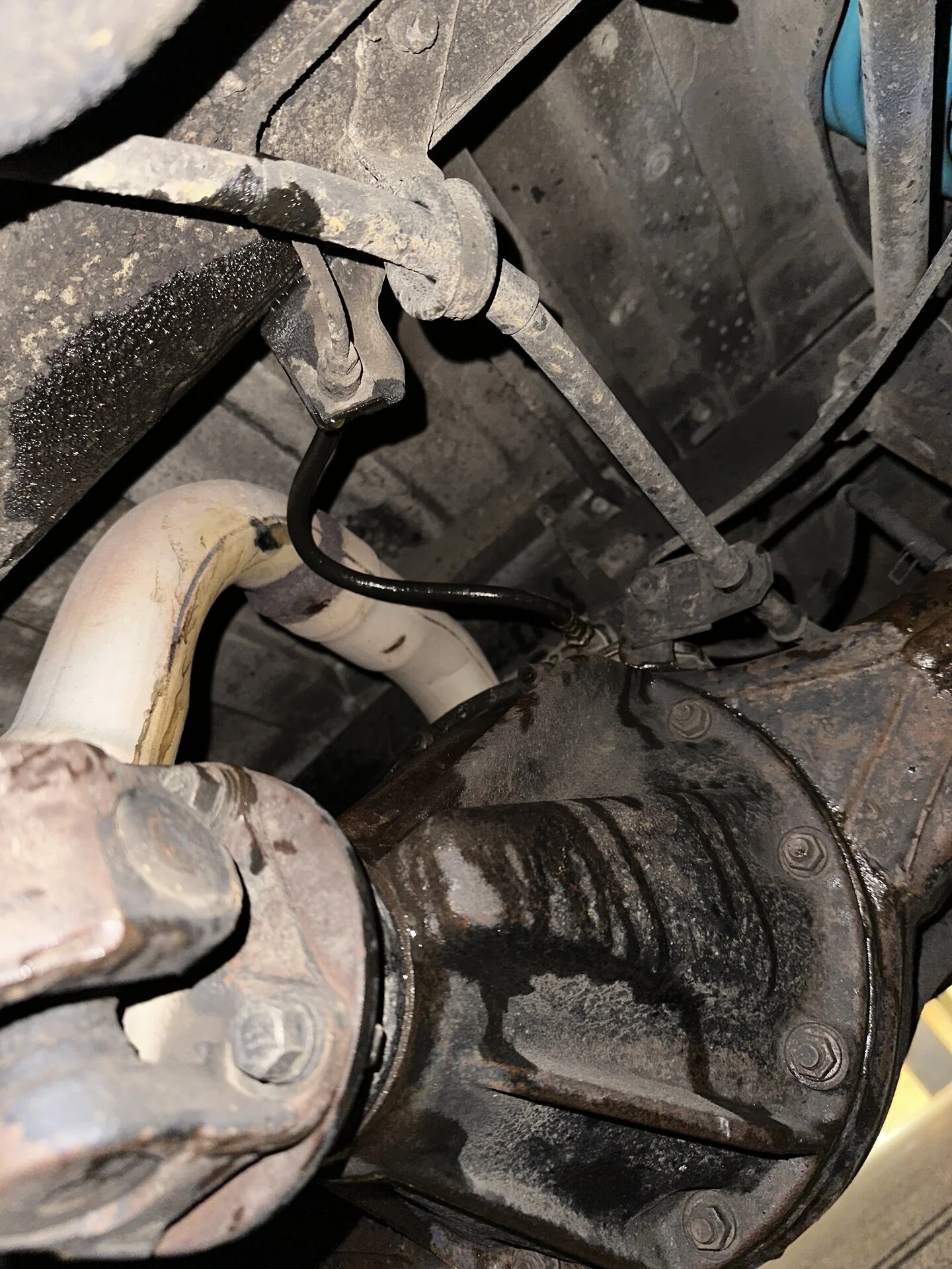

I was on the highway at about midnight and felt my brakes go to the floor as i was getting off the highway. I could still stop it by going to the floor. I pulled into a parking lot and saw smoke (probably brake fluid that came off the exhaust) and saw that one of my brake lines in the rear went out. It looks like it's the one sitting above the rear diff. The rear end was very loaded down with a full group of people when it happened. Is this just a brake line replacement or should i be worried about more? I was gonna take it to a shop soon anyways because my rear brakes are at 2mm so i was worried it was that at first but it doesnt seem like it was that.
It might be a good time to look at all the flexible hoses to the calipers and from chassis to the axle housings.

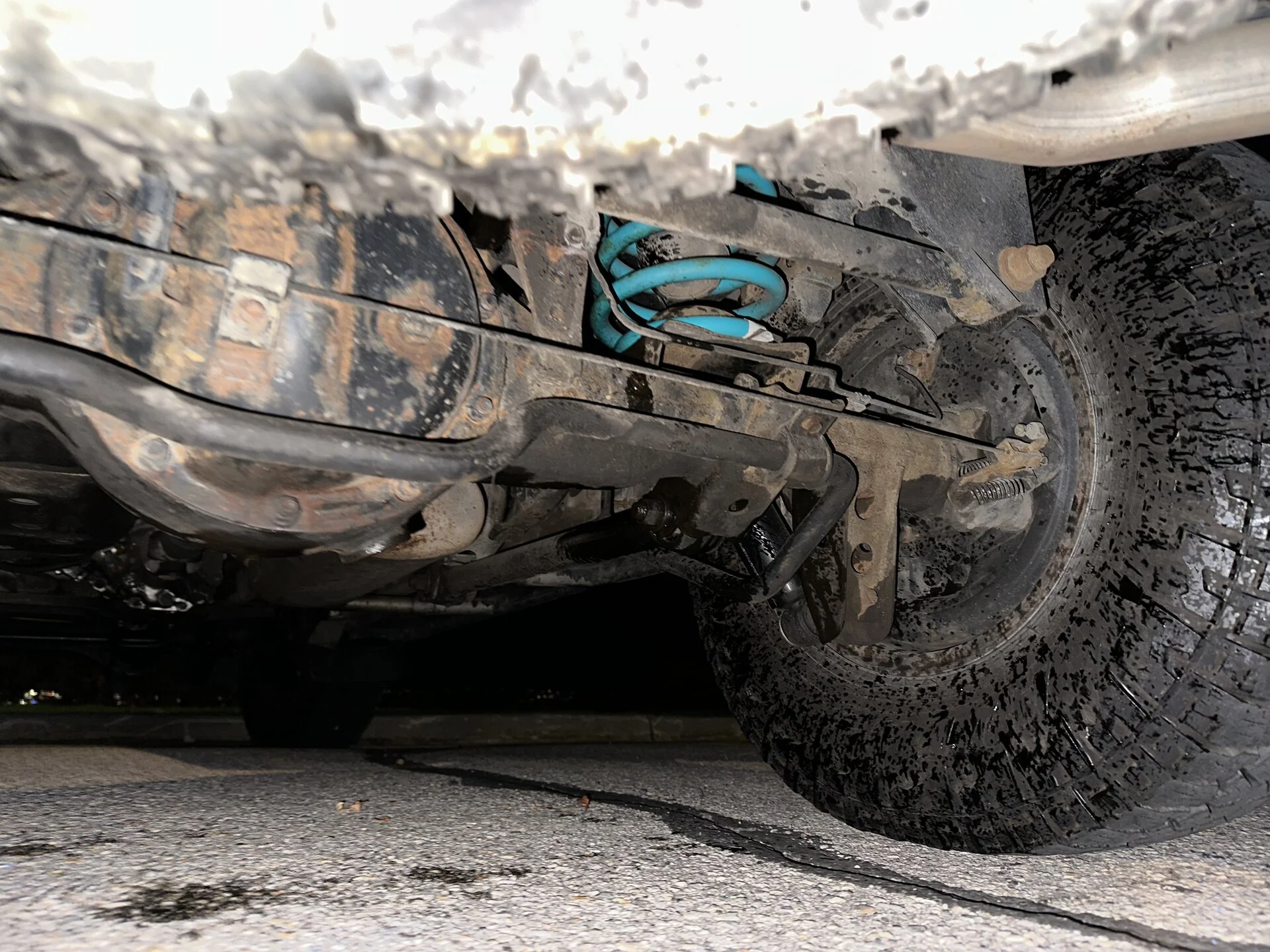

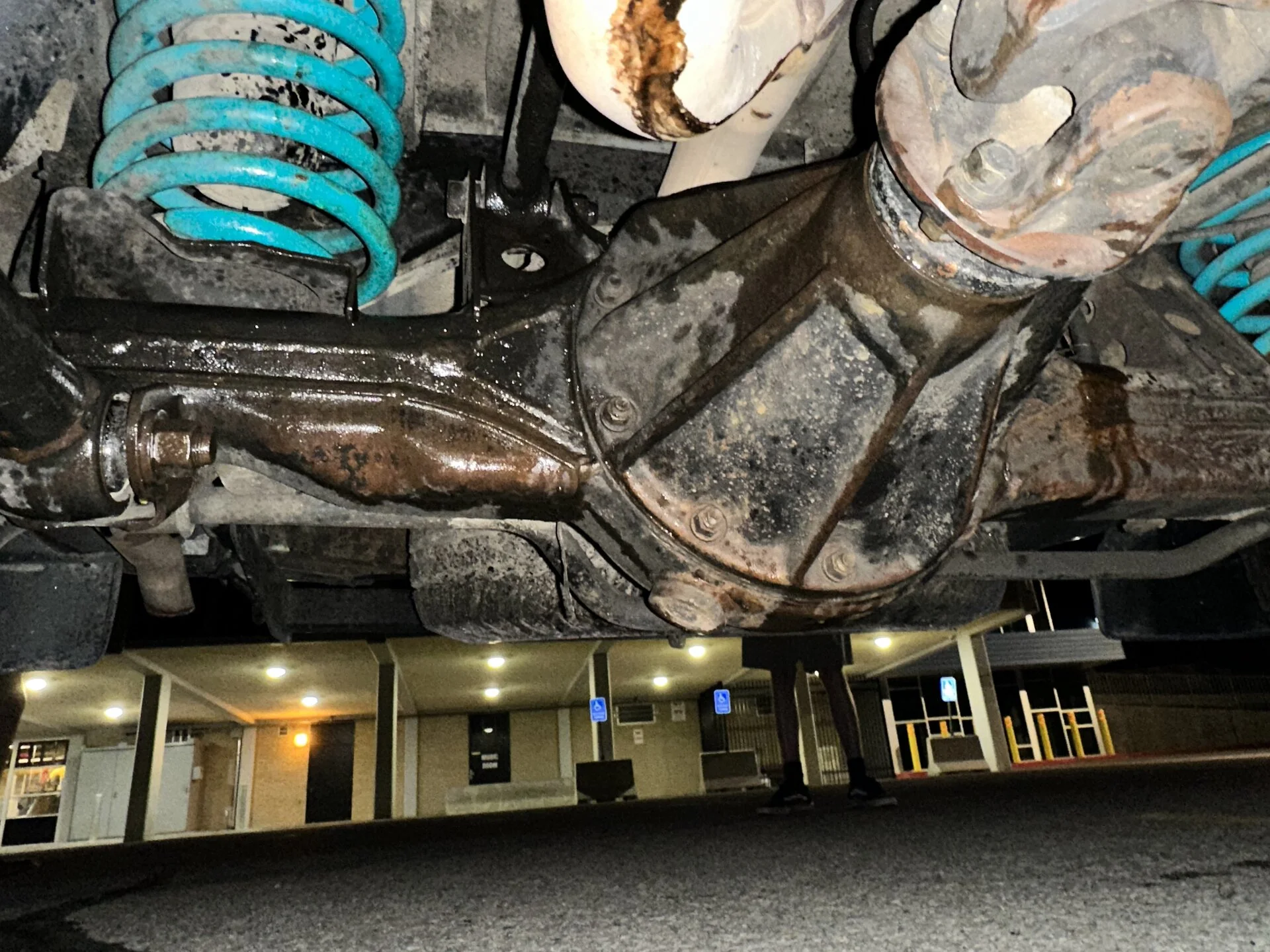

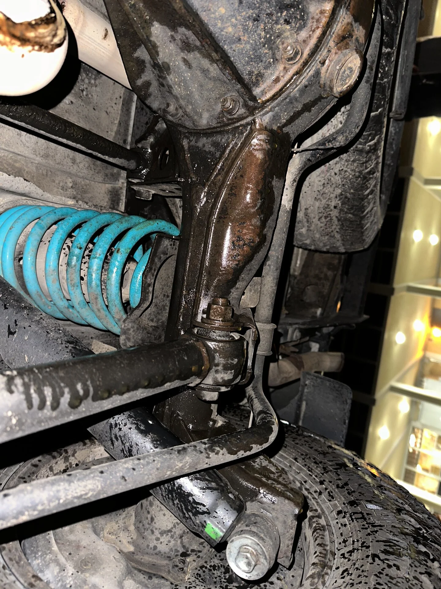

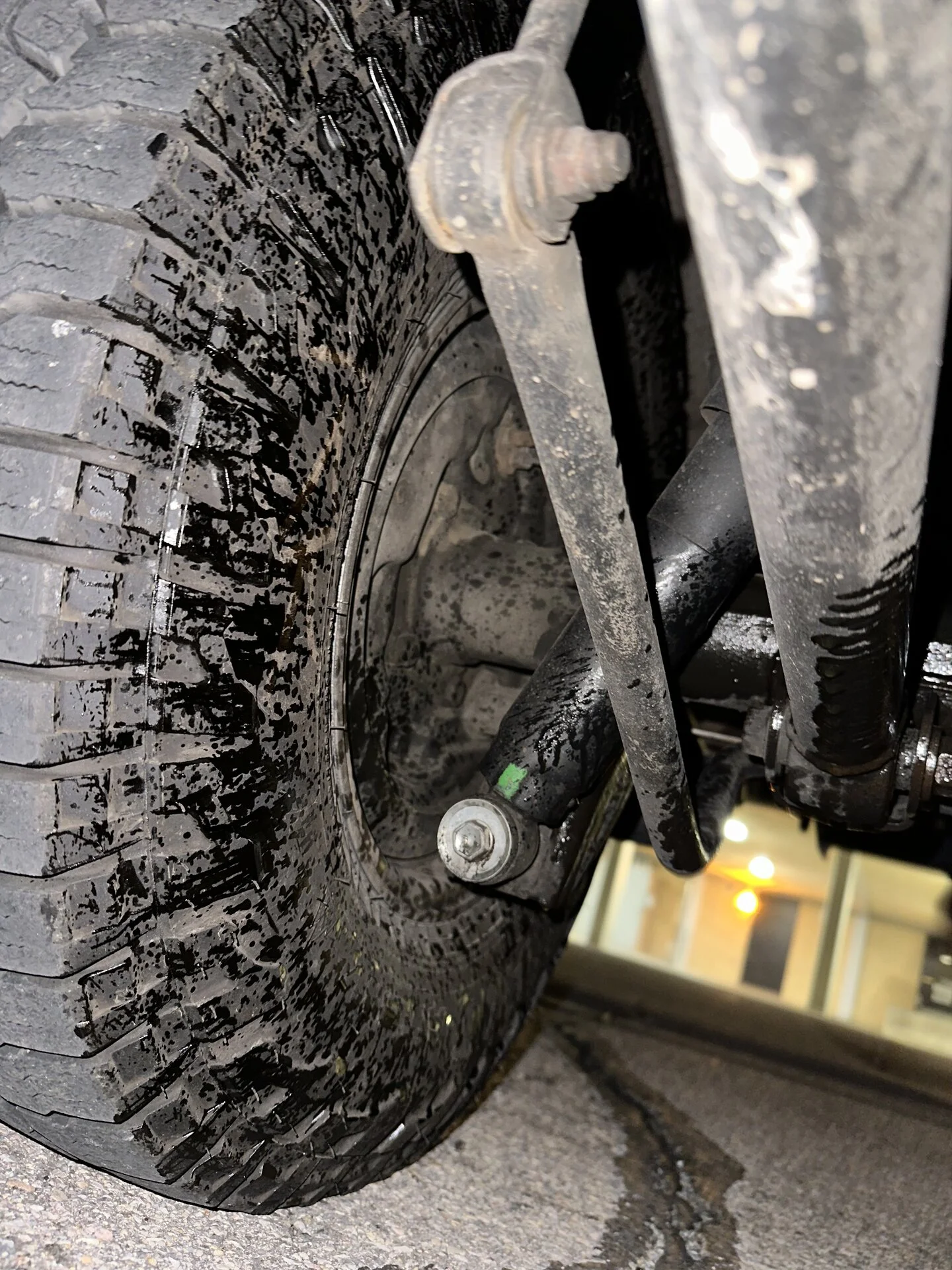

Agreed...by the pics, looks like you just lost the flexible line from the chassis to the rear axle and not a rusty hard line. I'd definitely plan on upgrading your fronts too, maybe go with stainless as they really aren't that much extra. Looks like most of the mess came from hitting the drive shaft and flinging everywhere...glad that you were able to get off of the road safely, especially with passengers on board!
Also plan on a fluid flush, but know that bleeding can be a little tricky on the 80, so be sure that your mechanic is somewhat toyota knowledgeable and not just a generic brake & muffler type shop.
Based on the curve of that line, you had a load of people in it and the line sat against the exhaust and burned through.
Install a new hose, bleed the system, and get on with life. Make sure when you install the new hose, it is routed and curved so it will not come close to the exhaust under full compression of the suspension.
Also consider a set of air bags for the rear springs for the next time you're going to haul a load like that. They're about $100 from Airlift.
Oh, and make sure you pressure wash that underside sooner than later.
Brake fluid will eat paint off of anything and will begin the rusting process.
Agree with all of the above and will add that if the brake hose is getting that close to the exhaust that a shield on the exhaust may be worth considering. That hose will last a long longer if it's isn't heat cycled any harder than it has to be.
Brake fluid readily combines with water so if pressure washing isn't an easy option simply spraying the area with water from the hose will help flush away the brake fluid.

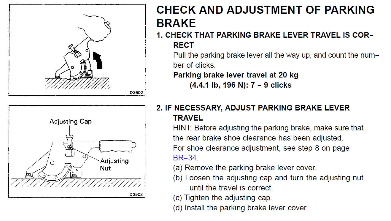

There is no "break in period' for brakes. If your brakes aren't working like new, meaning they plant your face on the dash, the work was done incorrectly. FWIW, the parking brake handle is supposed to go up 7-9 clicks and then stop.
This is from the 1991 FSM, which is in the 80 series section of the Resources Forum on this site, for free download. It's a searchable (CTRL+F) pdf file. The brake section starts on page BR-1.

I will add that proper adjustment of the hand brake with the rear drums makes a big difference in brake feel. The FSM specifies 7-9 clicks, however I have found that this is a bit too loose. I would aim for 5-6 clicks as long as the shoes don't drag.
