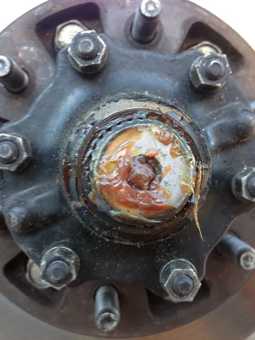

Loss of drive problem. Front axle service?
Well at least it looks like you will get off easy at least from the point of view of parts $$ So what are you trowing in there?
If you decide to resurface the disks remember you have to take them in with bearings and all so they can put it on the lathe..
I might be getting cut some slack on parts but I damn sure spent that extra money on tools - I didn't have that much of a tool collection to start with so I've already spent a nice little chunk of change in that area. Still need a few more tools too Arghh!
I will most likely stick with an OEM front axle rebuild kit, possibly from one of the many people/vendors on this site.
I would also like to replace the rotors and was leaning towards an aftermarket brand - one that is slotted or has holes. I like the idea of sticking with original parts but the so called benefits of the slotted/drilled rotors is persuading. Not 100% sure yet though, I'm still looking into this issue.
- newb question about rotors: if purchasing new rotors, I read something about having to get them indexed? I'm not sure what that means or if it is needed. This is ONE THING I have not researched yet over the past few weeks.
Lastly, I'm still not sure if all of those parts/components being replaced would solve my problem. I still need to check the brake lines, calipers, and master cylinder.
I would like to go ahead and knock out the calipers while I'm messing around with this area since mine are looking a little rough. I've read threads and the FAQ about replacing the calipers as a whole or performing a caliper rebuild. Not sure which would be a better choice - probably more time consuming doing the rebuild and more expensive replacing the whole caliper.

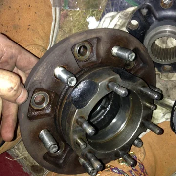

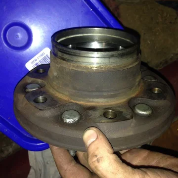

You can use your tire/wheel as a jig next time to remove hub bolts from rotor. Will give you a little more grip.

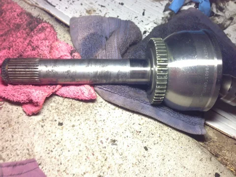

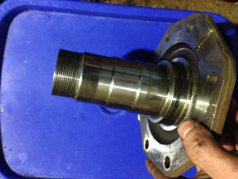

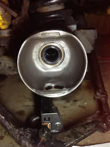

I think your spindle on the first set of pictures looks worn as well. I would replace that with a good used from cruiseryard.com or an oem replacement. Inwould also separate those birfs to get them nice and cleaned up.

I still have to separate the hub/rotor so I'll give this a try for sure! How can you tell the rotor is worn? I noticed some slight discolorations but what are the indicators? Gotta get that pvc pipe to separate the birfs - I was at home depot earlier today DAMN!

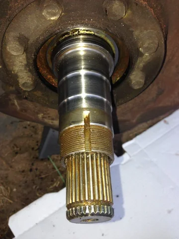

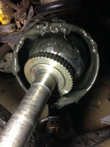

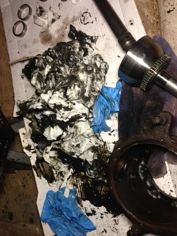

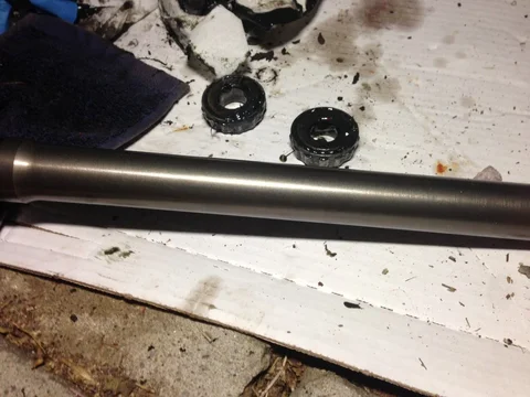

Hornd, thank you for all of the info! After finally getting everything taken apart, time to inspect and see what needs to be ordered. I'd like to be placing an order sometime within the next day or two! As far as ordering the calipers, how long did those take to come in? Cost? I was leaning towards ordering calipers from one of the vendors on here but this may be a better option. AAA 10% off sounds enticing as well!

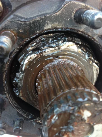

Here's some pics from yesterday! At least this side still had some grease - not as bad as the DS. A lovely picture of the extremely messy soup. How does the spindle look? Any signs of wear?
it is the spindle that looked worn to me. Discoloration and looks like a possible indentation where the bearing rides. Your finger and a dial gauge will tell you if it is or not, check fsm for spec. Read up on the sealing surface of your axle shafts as well. Looks like a good groove where the seal rides.

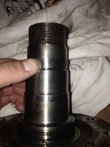

Thank you grizzlygibs! Now I know what to look for in a worn spindle...I just finished cleaning all of the DS parts tonight so I'll have to go back and check out the spindle. I was definitely planning on getting new spindle nuts but its nice to know that I can buy a kit with all the parts I need. Mine were all chipped to hell. Gotta get that 54mm socket too - at least I didn't have to worry about damaging the nuts any more using a brass drift and hammer to get them loose!
If you can not feel a groove and it dials out within spec, i would just throw new bearings in. But def check with a gauge.
$120 for a new spindle from cruiser parts :eek: dear god I hope I don't have to replace these too! Are you looking at the end of the spindle where the outer bearing would sit - I do see the discoloration/marks where it could be rubbing. I will check tomorrow for any grooves near this region.

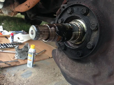

the first pic is of the PS spindle. Last pic is of the DS spindle after being all cleaned off - dark discoloration near the end of it.
DS hub and spindle all cleaned up - any suggestions on getting off that rust. They soaked in gas for a couple of days and I just got done using brake cleaner, pb blaster, paper towels, and a metal brush to clean them. Couldn't get that damn rust off. They weren't this rusty to start with - I left them outside while I was at work and we got hit by rain one day. :doh: Rain in SD....really??? Learned my lesson on that one - now all the parts are inside of my truck or under an umbrella. Damn I miss having a garage
Run that spindle mine looked the same.
Worse thing that happens is it trashes bearing ( I can send you replacement as mine was fine but I replaced anyhow) and you have to buy spindle. I bet it will go another 200K.
Thanks Hornd, I most likely will stick with these spindles...I still haven't checked to see if there are any ridges/indentations but nothing stood out to me when it was inspected - only the slight discolorations in certain spots. I think my bearings may be fine also but I'm going to replace those too. At least I'll have spare parts!

I did check my spindles for wear and I was able to feel a little ridge on one half/side of the spindle where the outer bearing sits. I'm going to take a chance and use the same spindles. Hoping this doesn't come back to bite me in the:moon:
