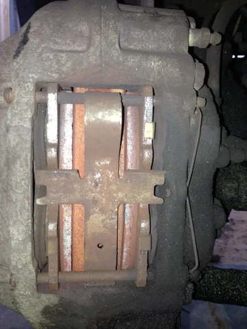

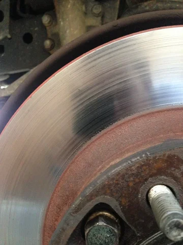

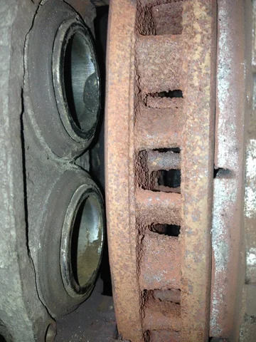

I did take some pics of the progress so far. In my inexperienced opinion, I believe that everything looks fine so far. That rust/buildup on the inside of the rotor is pretty normal, correct? Since I will be doing a knuckle rebuild, I'm fine with replacing some of these other components at the same time if needed.

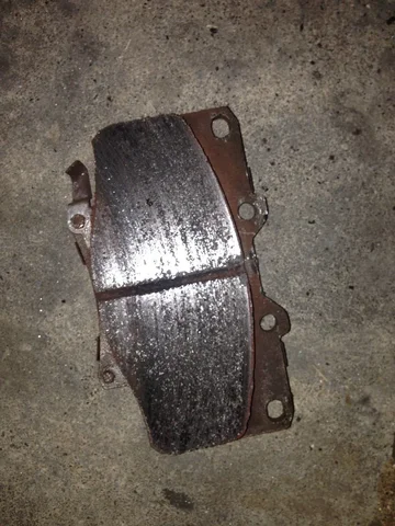

That is some serious lack of maintenance - in terms of the buildup of grease/gunk that's leaked out. A lot of the 'smoke' is probably that grease/gunk burning off as the rotor heats up.
That brake pad looks like it has been abraded on rocks or something... You like driving in the ocean or along the beach or was that 80 from a more rust prone area - that rotor in the vent area looks pretty rusty, pads too and also the picture of the hub area? More than I'd expect from a Cali vehicle.
What's the history of your 80?
You'll need to get into those knuckles/birfields and pull them and replace seals/felts/bearings etc. Then you'll get an idea if stuff inside is cooked - maybe no grease left in there since it's all oozed out... I'd say you have a bunch of $$ to spend on parts... Hopefully you have the FSM or at least download the electronic copy of the birfmark one for the '96 so you can pull things apart. There's quite a few writeups on this forum for the front end maintenance you'll need to do. I'd include checking all the brake parts/system. Probably pay to get a caliper re-build kit etc.

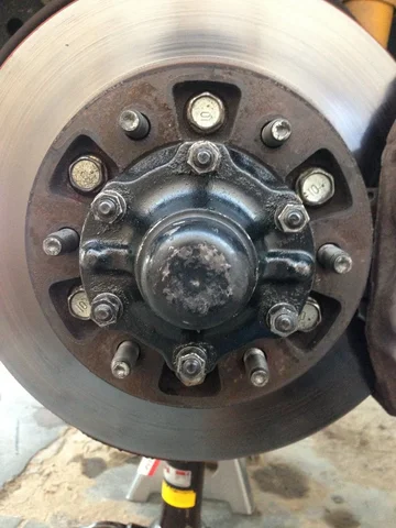

So I'm back after a 2 week long hiatus - after being away for thanksgiving break, I had some catching up to do for school and haven't had a chance to get around to my front axle until today. Took me about 3 hours to get all of these parts off. I took my time just to make sure I didn't misplace a part or mess something up. One guy stopped by to ask if I needed any help, even though he didn't know anything about my problem when I explained it to him. I told that kind fella, "hell, neither do I. I've learned all this from a website online!"
On a side note, I did not have the 54 mm hub nut socket (none of the auto parts stores around me had it) so I used a brass drift and hammer to knock it loose. This I didn't mind since it had already been beaten up by someone before me, as you'll see in the pics.
I was finally able to take everything apart - all the way down to just the knuckle. I knocked loose the bearing races and called it quits there (we had a holiday parade to watch in OB). I did try using the hammer and a screw driver method to try to get out the oil seal inside the knuckle but I kind of put a stop to that real quick - I didn't feel comfortable banging around in there and probably will get a seal puller from harbor freight or amazon.
Tonight I need to soak all the parts in some gasoline that I have saved from our road trip up north. After doing all this, I know that a front axle rebuild is much needed. As far as my problem with the front wheels smoking and the weird loss of power issue, I'm leaning towards something to do with my brakes - whether it involves the caliper pistons, brake pads, or the master cylinder. Time to browse some more threads ;)
Please take a look at the photos and let me know if anything stands out to you or is worth mentioning. This is an awesome site! The front axle rebuild FAQ came in handy today :cheers:
