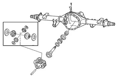

I was under the impression the full time diff used in the GX is the same diff used in the part time 4runner OEM Tacoma, the difference is in the extension tube on the passenger side having ADD or not. But looking at the parts diagram for both only the Tacoma shows the needle bearing. I installed the bushing on my old Tacoma, it only solves for the drivers side where the CV comes out of the diff. It isn’t difficult to swap with the right tools.
tacoma
GX
I am not sure this means it doesn’t exist on the GX, it may just be included in the carrier part number/ pre-installed in that part.
