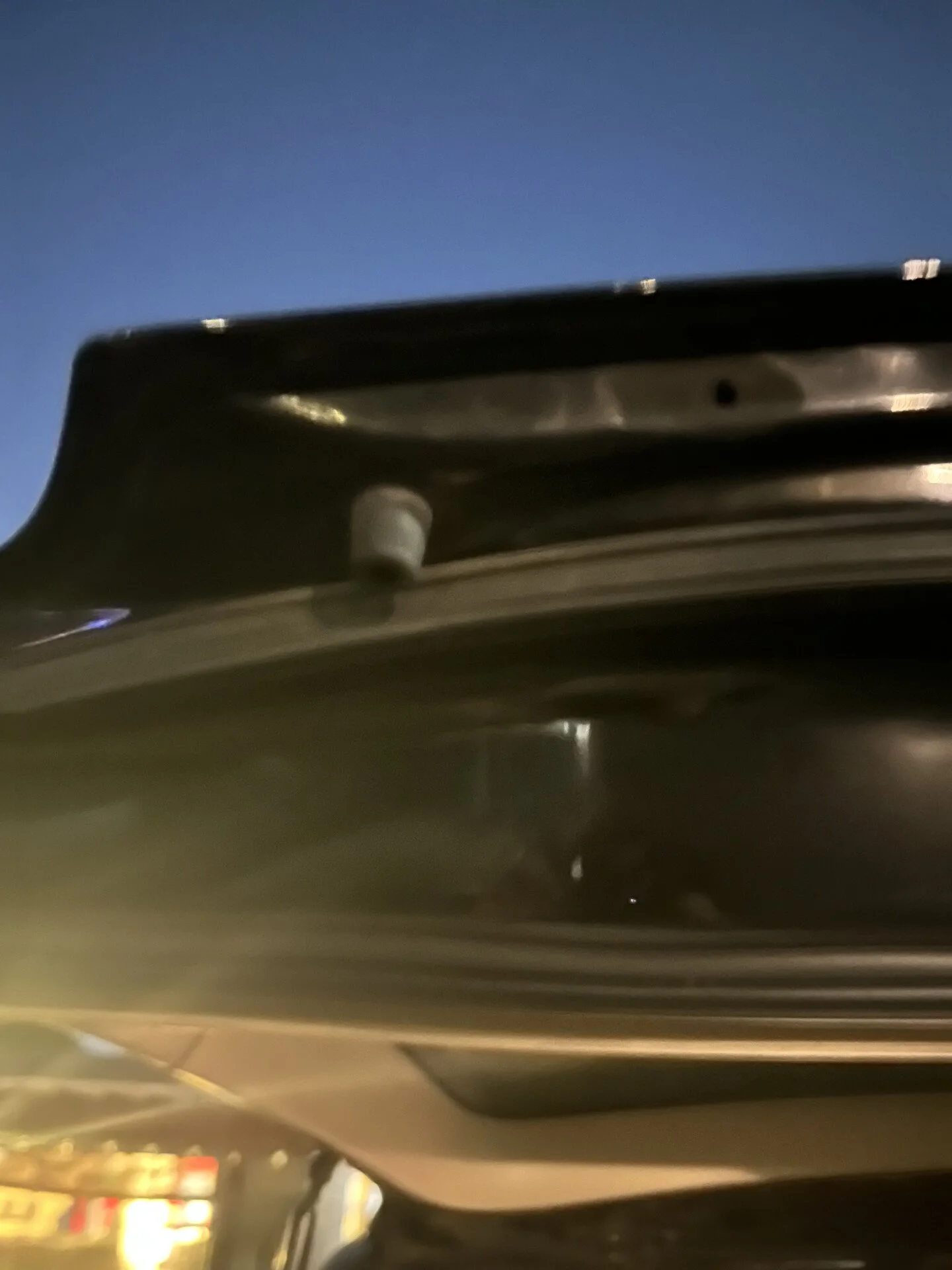

There are two bumpers on either side of interior facing glass hatch. They are located in such a way that they will apply pressure against the tailgate and latch when it is close and prevent rattling etc. I’d be willing to bet you are missing one or more and/or they have been distorted to such a degree that they no longer serve their purpose. I believe they are about 7$ each. Still available from Mr Toyoda

Thanks everyone. I have ordered some new weatherstripping. I have the rubber bump stops and they seem to be functioning properly. After I have the new weather stripping installed I’ll report back.
