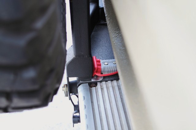

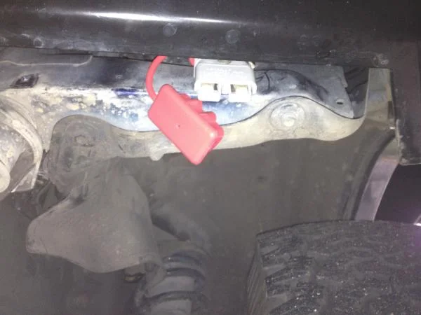

Have the large Anderson behind the DS side bumper going to the main battery, and a smaller plug on the PS for the house battery. Mounted to captive nuts in the body, so no drilling or cutting needed. Both are switched, so only live when I want them. This is the DS side with my jumper cable plugged into it.

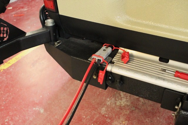

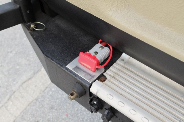

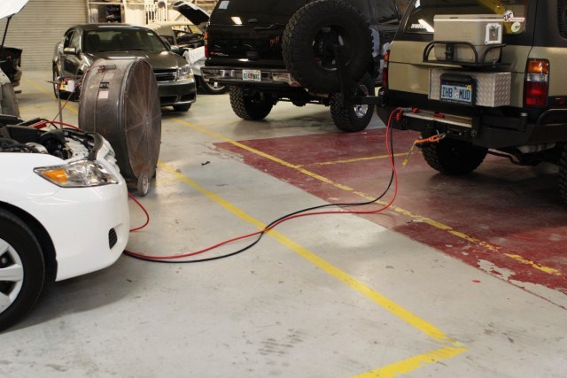

I mounted mine on the rear bumper wing cause it's mainly for jumping other folks (no need to go nose to nose, just pull in front)

Here is what I did for my jumper cables: HOW TO: World's Most Expensive Jumper Cables
