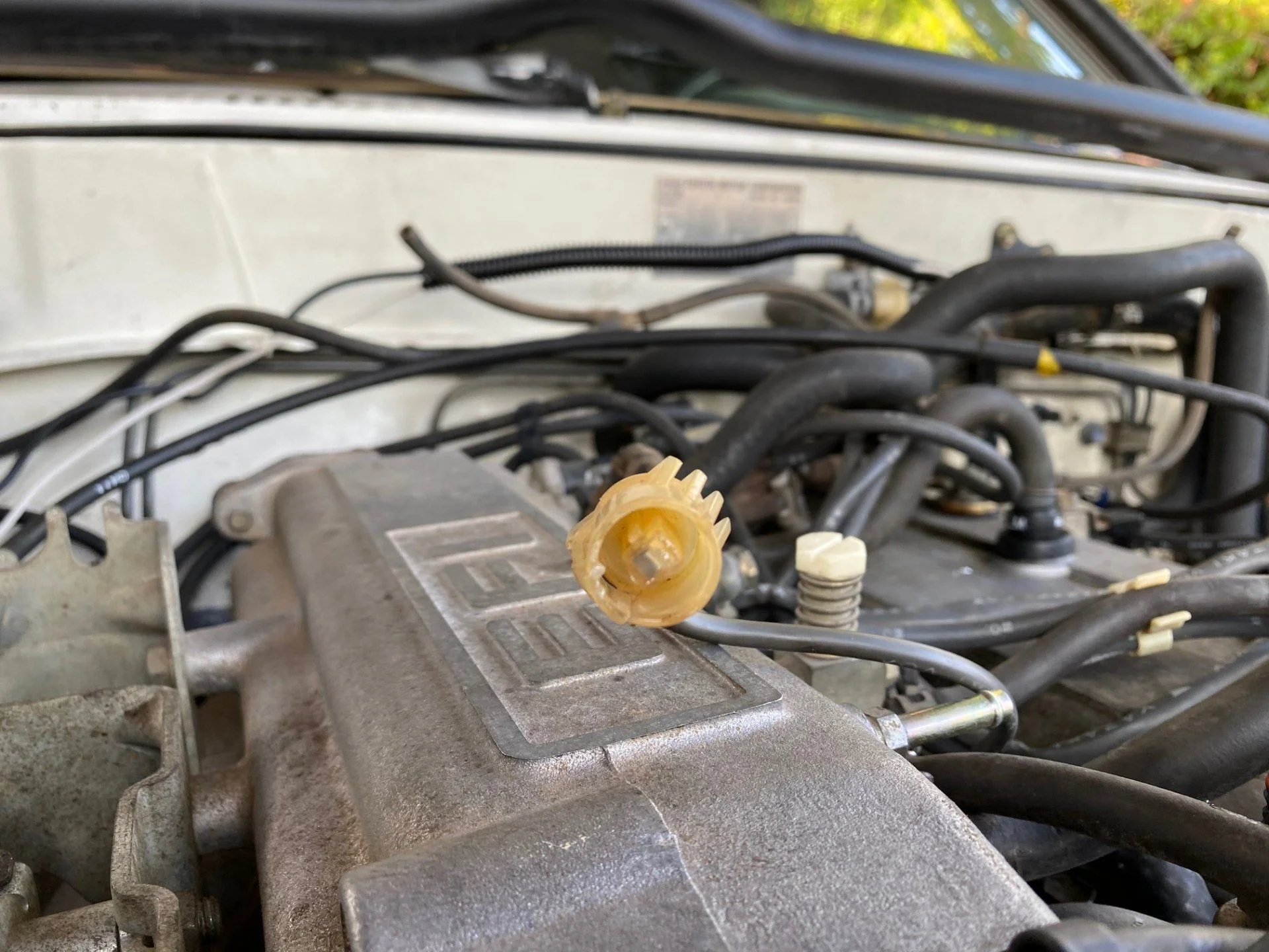

On a 1986 22RE engine in mini truck.
Looking for wire connector.

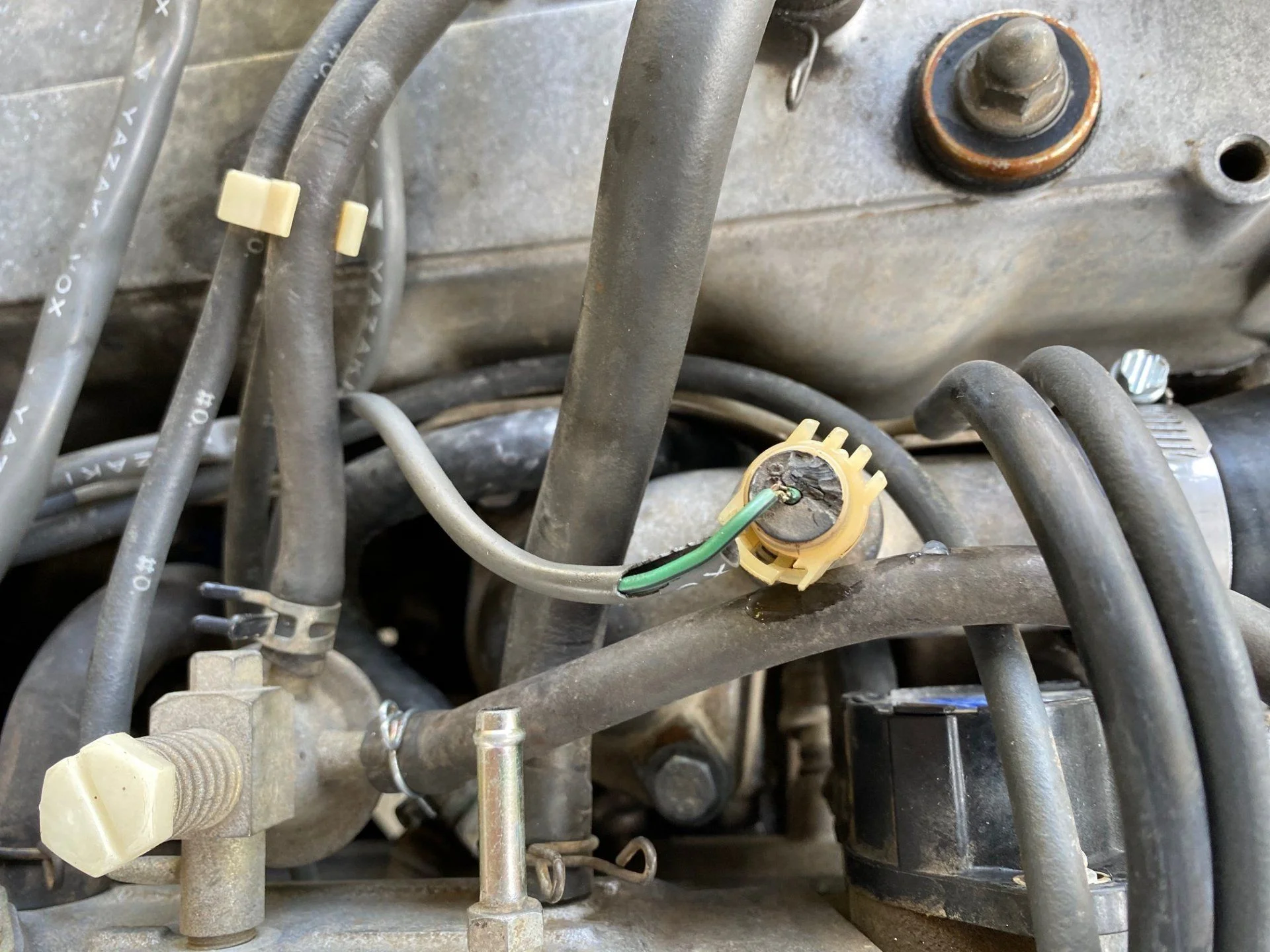

wire is broken right at the base so can't splice.

That is for the AC. I think everybody has a broken wire at exactly that same spot. I think I bubba'd something using a 1/4" spade. But frankly, as long as you pay attention to your engine temp while running the AC, I wouldn't worry about it.
Yeah. I had one fall off in my hand yesterday, so I went looking for it. I don't think they're really that rare, but there must not be much demand so you don't find them advertised. They weren't on the site I posted, but he will add them.
WHAT!? You mean there is a way to correctly fix this?
Your link took me right to it. A little much at 18 bucks to my door, but still ... ordered.
I agree, but I was not having much luck matching up the connector body with the correct terminal and environmental seal. So ordering the pigtail pre-made seemed the way to go.
I just went though this on my 2fe. Sure enough its also the same connector on my ‘86 22re (which had broken years ago and was replaced with a spade terminal.)
I ended up purchasing two connectors from Toyota, and repairing on my my FJ40 and Mini.
Heres a link to the thread where I talked about this and found part numbers.
