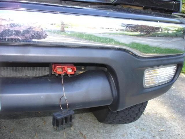

I went the SB175 quick disconnect route as well. You will need the same type cables to go from your battery (HD cable lug on this end) to a bracket that you will make and install that holds one end of the quick disconnect.
attachment.php
One little lesson learned with this setup: attach clamps to the vehicle to be charged first, then slide the quick disconnects together. I found myself one day holding the loose clamps enroute to the stranded car, after I had slid the quick disconnects together. BZZZZZZZZZZ went the clamps as I accidentally touched them together.
With the SB175 connector in place, it is also a great way of keeping the battery in shape via a Battery Tender. I made an adaptor that goes from the two prong power cord from the Battery Tender to the SB175.
