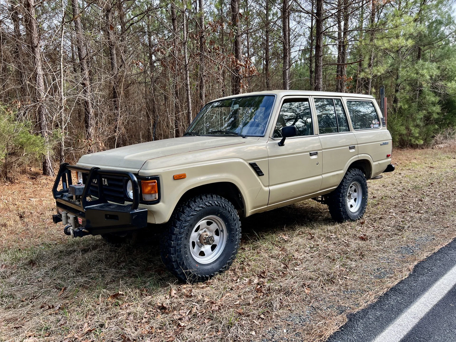

Yea they would fit..81-83 came with a “wagon” style wheel. Like the ones below.
Another cool wheel is the 70 series 16” wheel that will give you more tire options. While retaining the “stock” look.

I got that picture above off mud from I believe @HemiAlex to show the op they work. I’ve seen them in person on a few fj40’s and they look good!
Considering that the 60 and late 40 share parts from the knuckle out I’m guessing they work just fine.

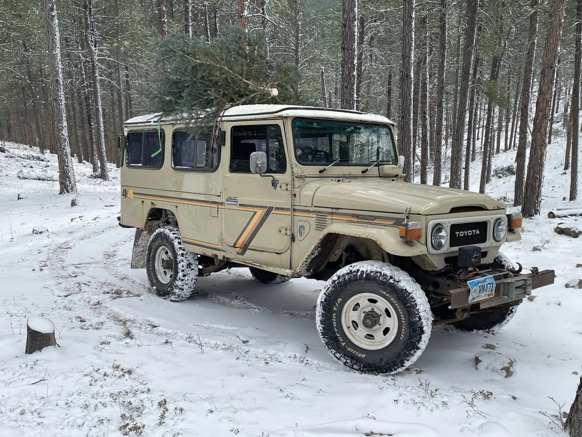

When I wear out my BFG’s I’m gonna go with the 70 series wheels on my 45 troopy above…
I know you can buy aftermarket wheels but I like the looks of the factory wheel. It just looks right.

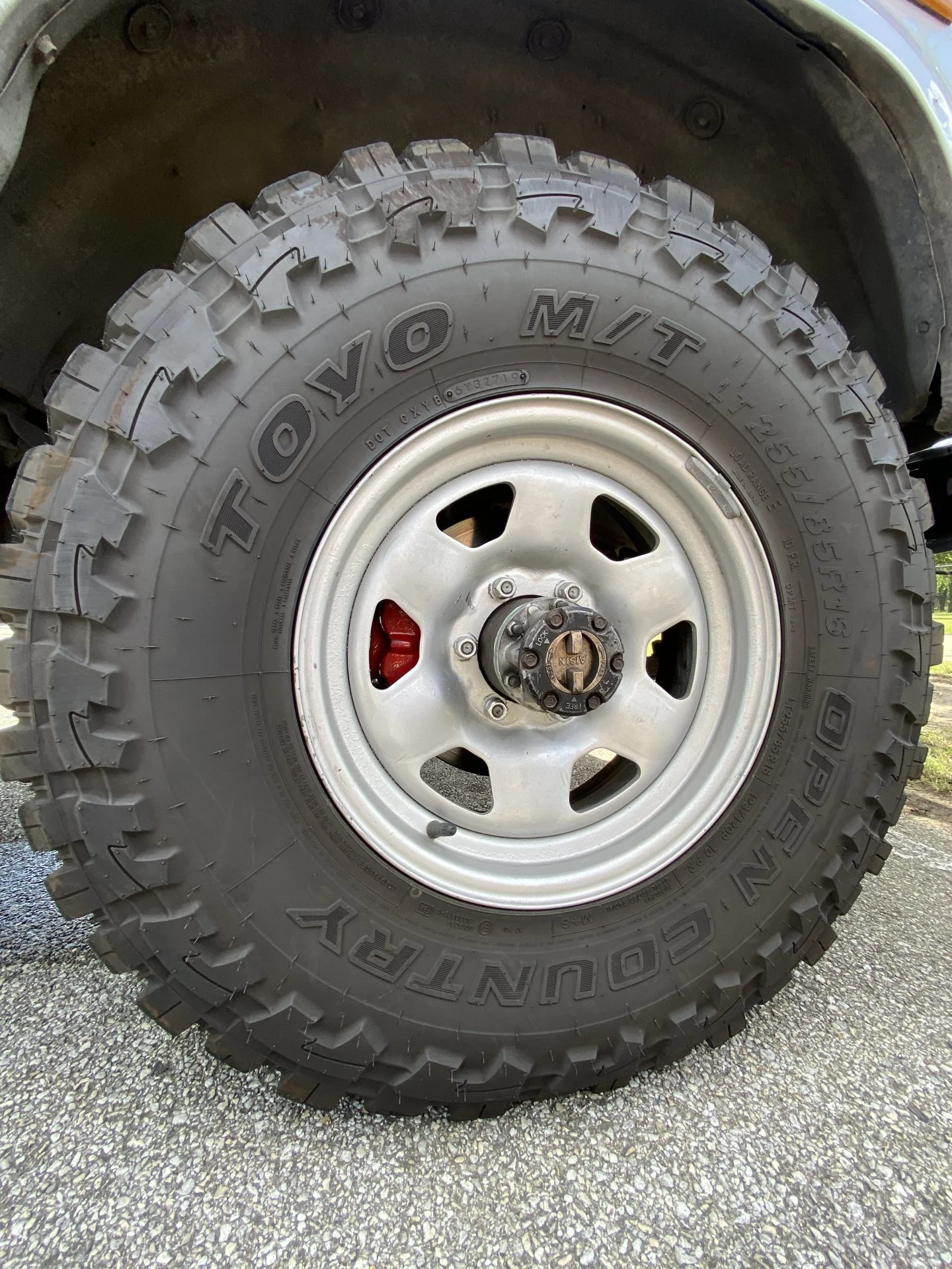

I have a set on my 60 but my axles have deviated from stock. Front with Tundra brake mod and rear an 80 series FF. 70 series wheels fit without issue or need for spacers. These were powder coated a dark color
before I bought them.
