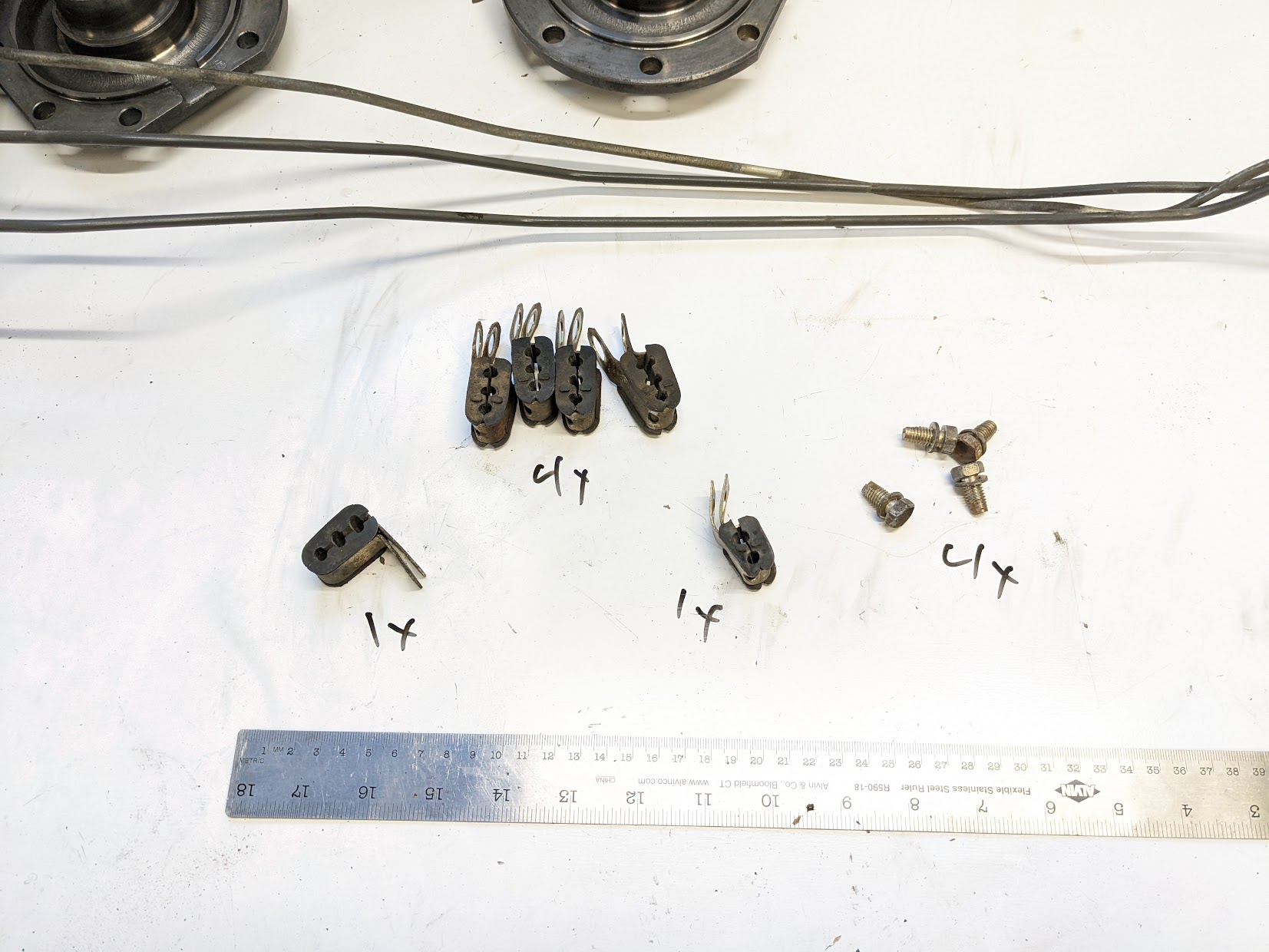

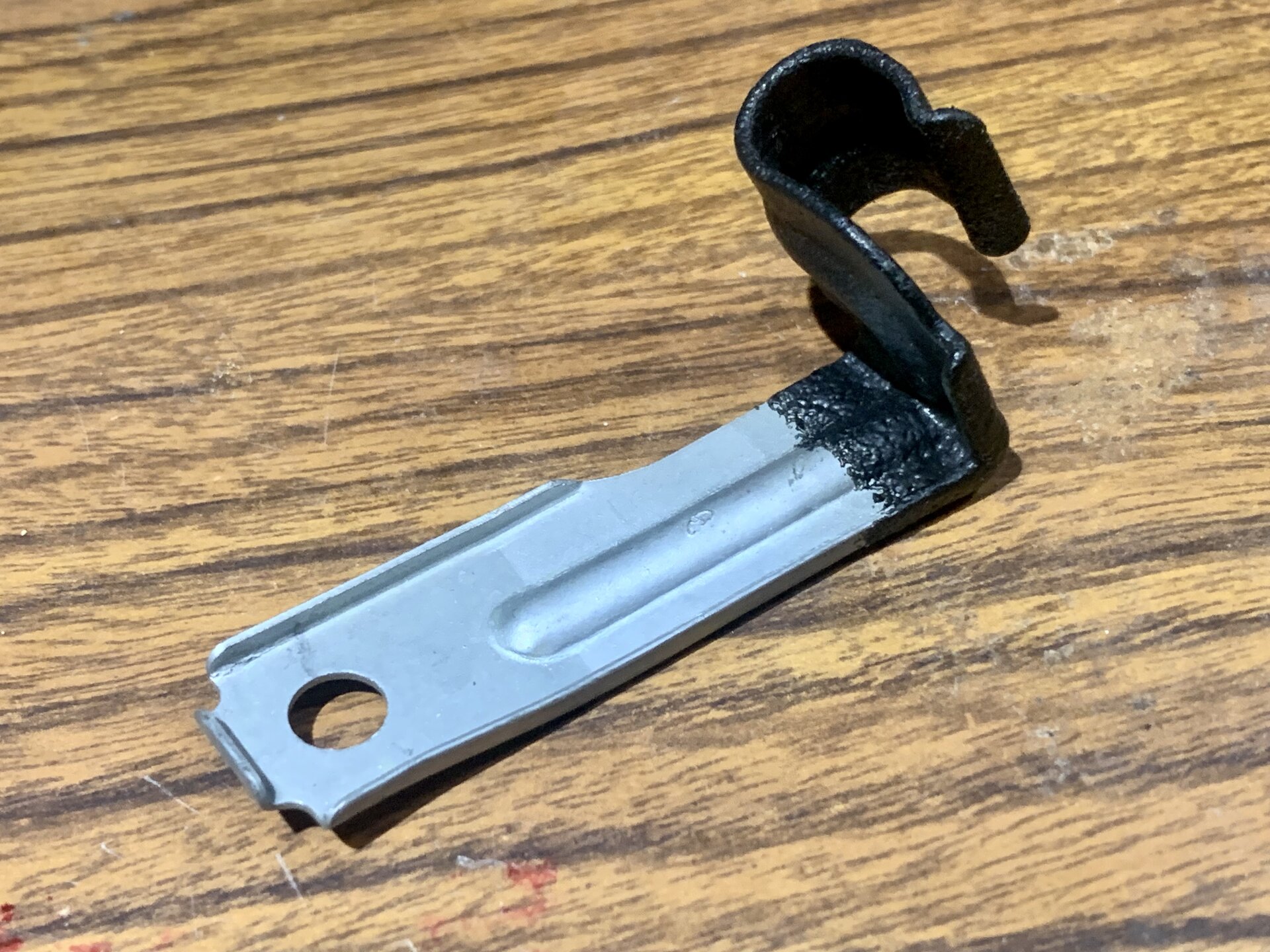

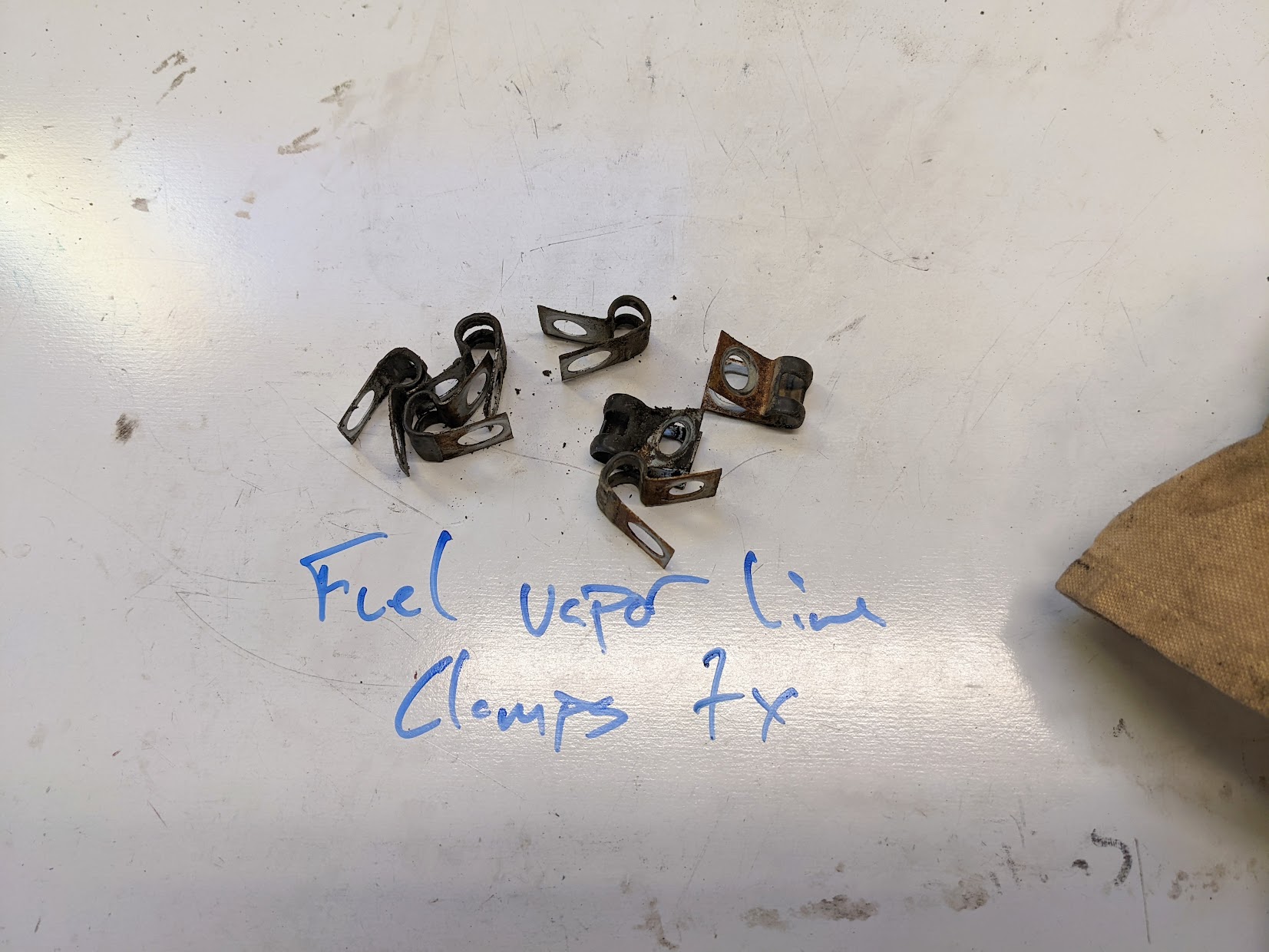

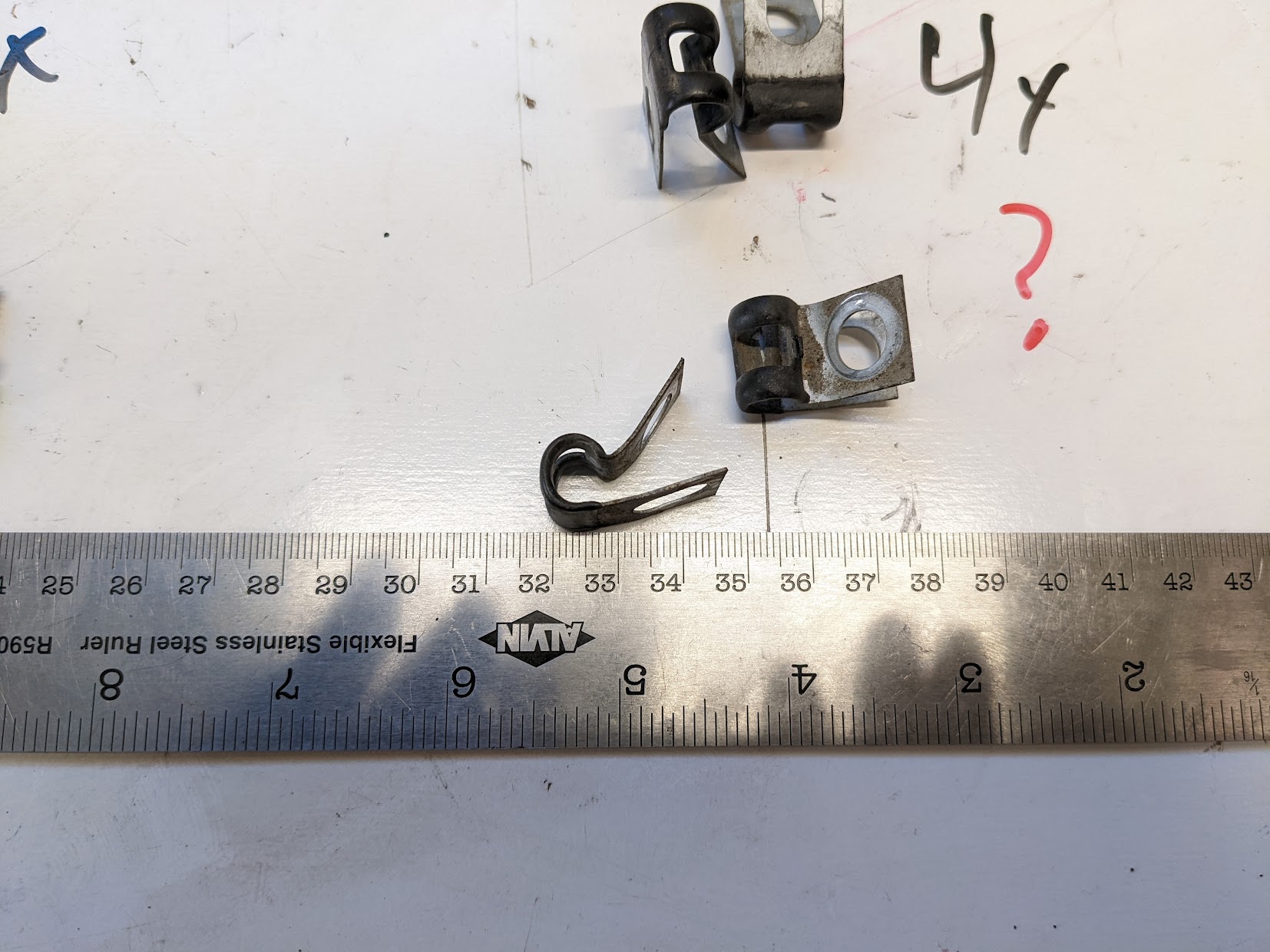

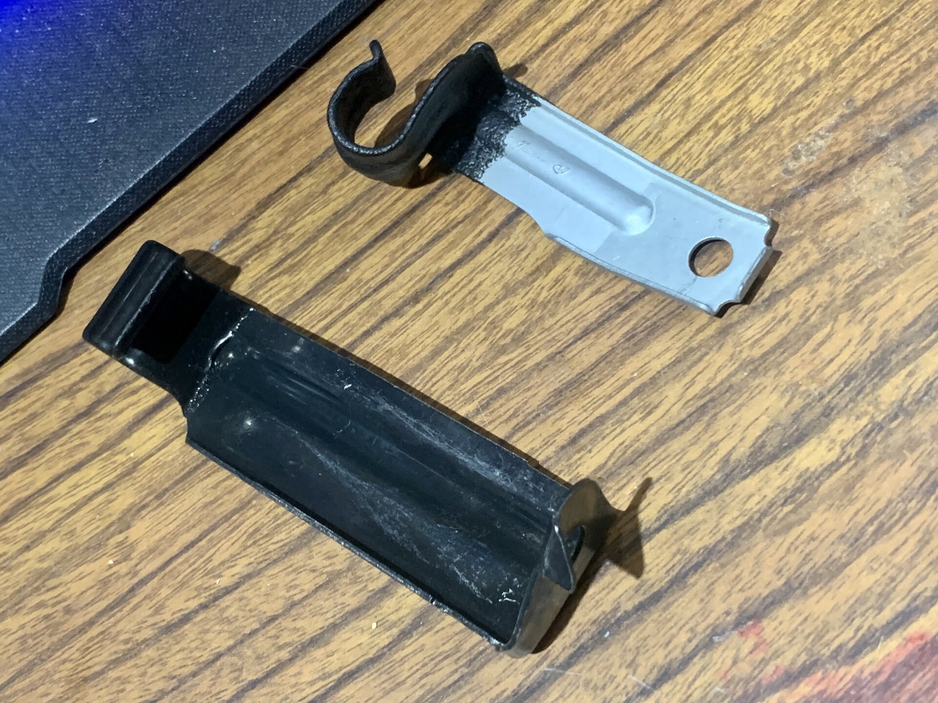

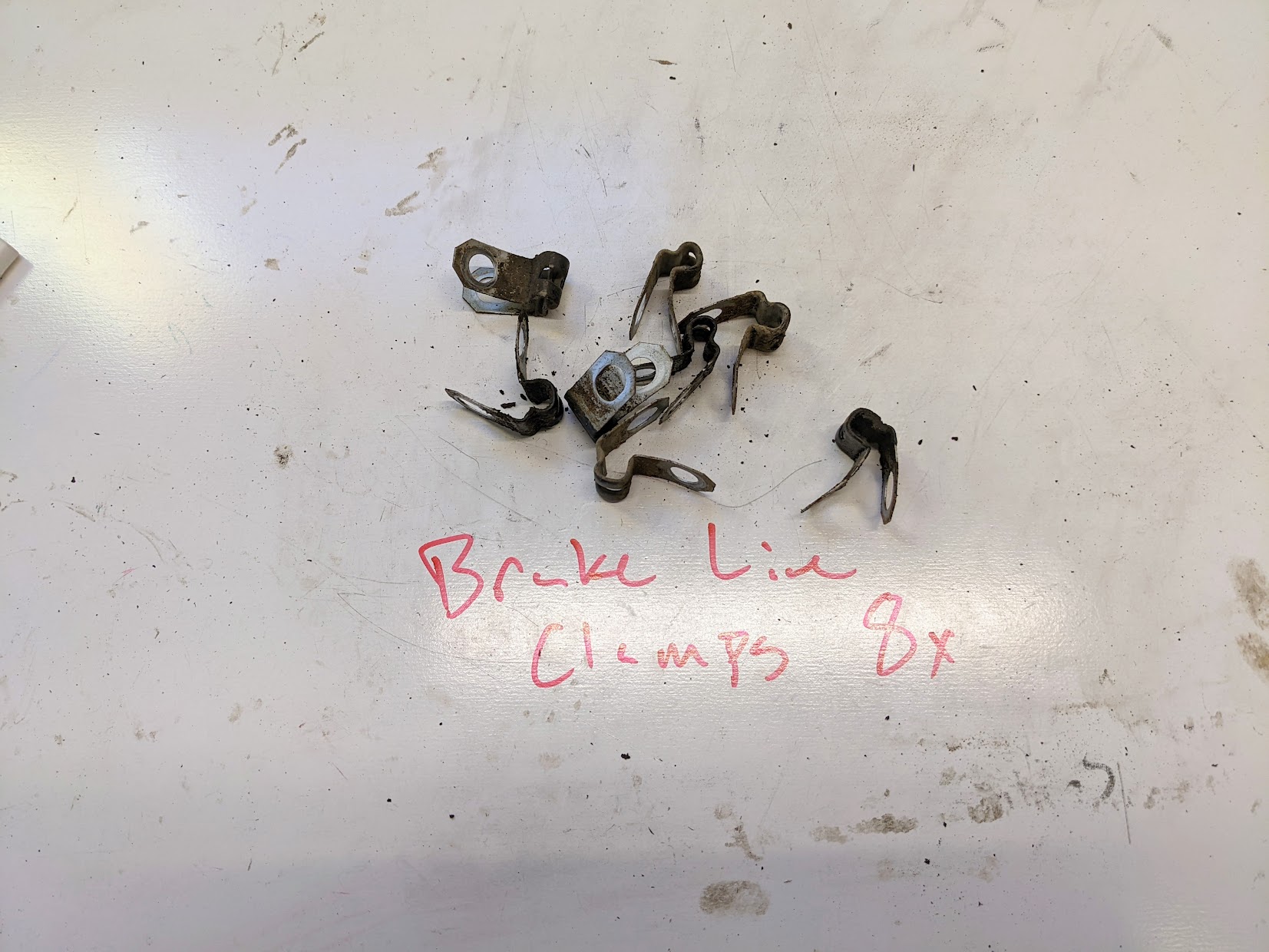

Pretty much the last parts I need to source or refurbish for my frame-off restoration are the fuel and brake line clamps and grommets that are used throughout the truck. Online sources say these are either discontinued, or no pics are available to verify what the part number represents. While these specific 60 series part numbers might indeed be NLA, I'd like to believe that Toyota has used the same or similar clamps on later models. For those clamps that have a removable rubber grommet, I can re-plate the clamp but replacing the eroding rubber would be great
Does anyone have part numbers handy for p-clamps or the dual/triple line clamps used throughout these trucks? If so, please help me out and let me know. Here are some pics of some of the different types I've pulled off.

this is everything i have as far as clamps ,
until later this evening ,
the below ones will be discussed more in depth ...
