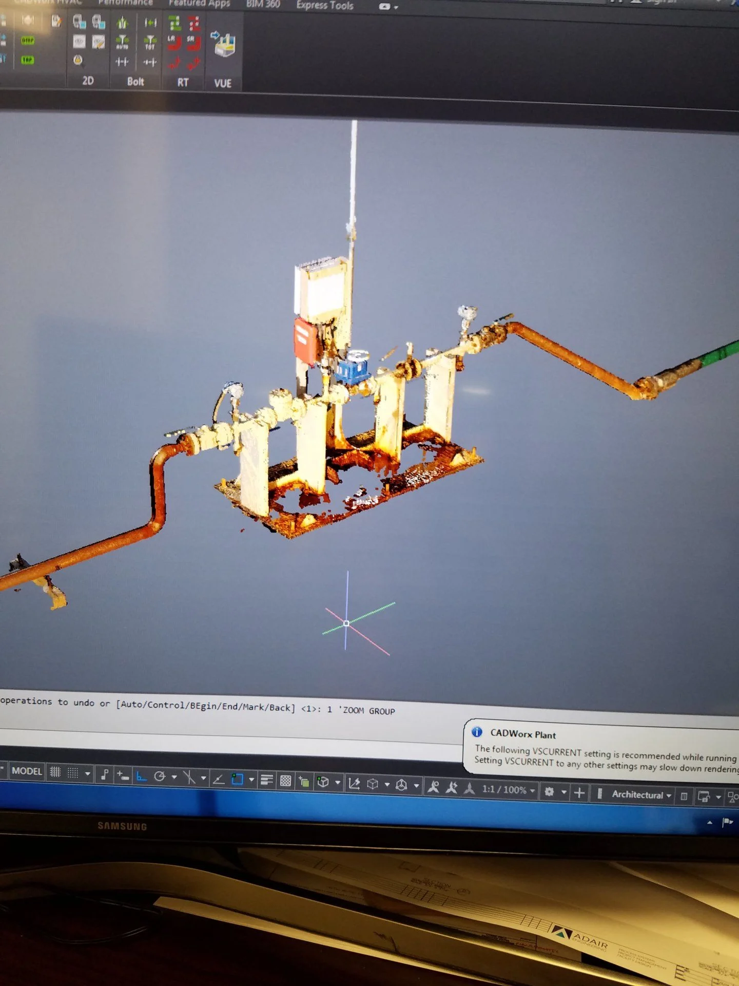

Hi all.. I am starting to design a new 2L-TE inake & exhaust package complete with 3"exhaust & intercooler.. I need an old "useless" head to 3D laser scan & knit into my completed engine bay laser scans.

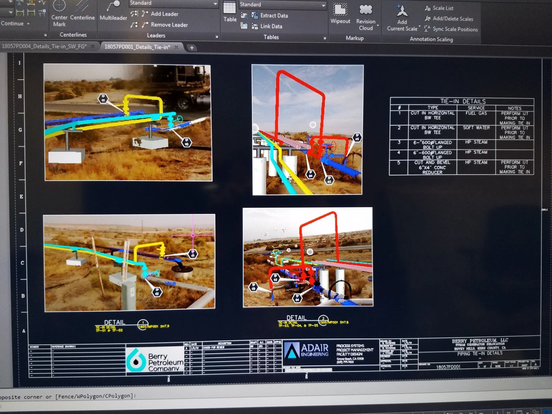

Gents.. I'm 3D designing a complete power upgrade system for the 2L-TE... my LJ78 is the guinea pig... so here's the concept:
1) tuned exhaust manifold
2) tuned intake manifold
3) upgraded throttle body
3) CT20 T/C
4) 3" exhaust
5) top mounted intercooler air in and out ducted to a shaker hood (kind of a cross between a Camaro rear opening & a hemispheric front facing opening)
6) integrated cng system
7) upgraded sensors with piggy back ecu
Before you guys start slashing. I'm a mechanical & controls designer by trade..
