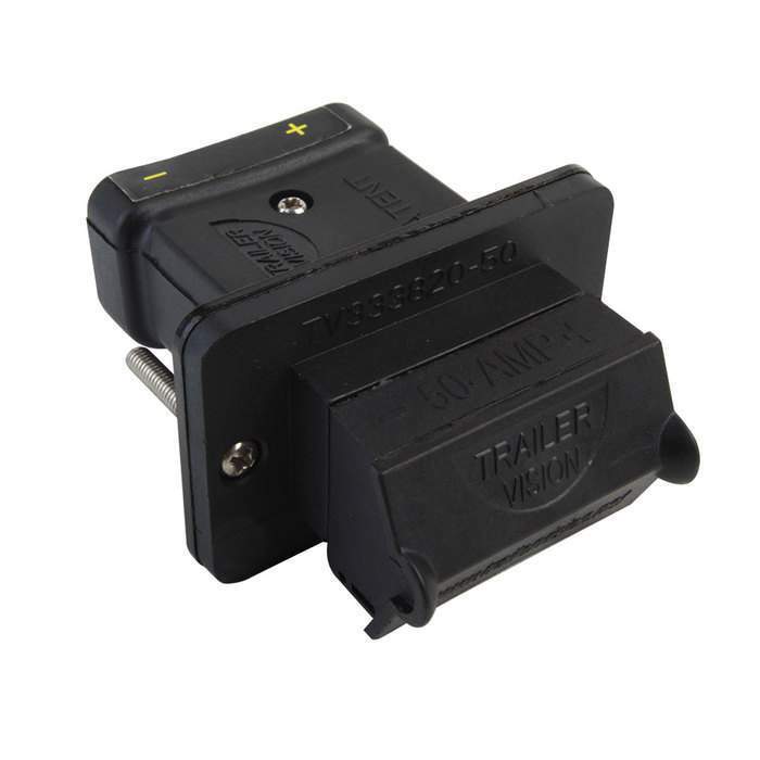

IM WIRING UP MY FRIDGE In the rear, Ive wired it up to a factory switch one of 6 ive installed, but for the fridge Id like a factory push button for the fridge or should i just hard wire the anderson plug for the fridge and let the fridge do the thinking??
I can't think of a good reason to have your fridge controlled by a switch. It's not like you are turning it on and off a ton. I can think of more reasons not to run it through a switch (like accidentally hitting the switch and turning it off while your fridge is full of food) than I can for doing it.
Also consider that your switch has to be rated for the current draw the fridge produces, otherwise you need to run it through a relay.
I ran mine straight from the battery and just leave it plugged in. I turn it on and off using the buttons on the fridge. Worst case if I forget to turn it off someday the fridge will shut it self down before the battery gets too low. I regularly leave it on overnight when traveling and it hasn't been an issue.
yea Im going to hardwire to anderson plug.

Yea Im thinking to straight up wire to the fuse block and then leave it off at the anderson coupling I just ordered. Nothing wrong with that right?/

yup, thats the switch I got from you and Ive also installed 5 more total. but again I think im going to wire straight to fues off aux battery to the anderson coupling set up from wits end.
