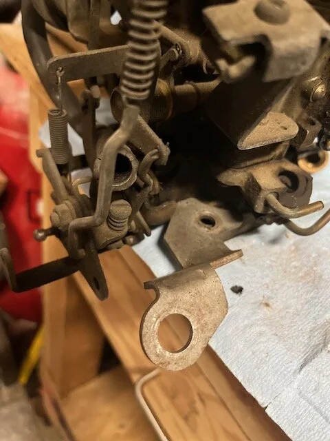

This bracket from 1F carb on 2F carb. It is too short, cable won't line up, and mounting hole for carb mounting stud doesn't line up.
Put the bracket in the right spot and you also need the correct bracket on the linkage for the cable throttle....unless you are deviating from factory.
What you're looking to do needs to become a hybrid F/2F carb. Totally doable you'll just need the bracket off the butterfly, I don't believe I have any spares. Buzz me direct if you need help sorting it out.
