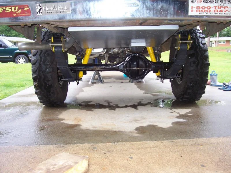

Here is a pic of the Opposite Locke 50 gallon tank. And the full floater rear end too.
TB

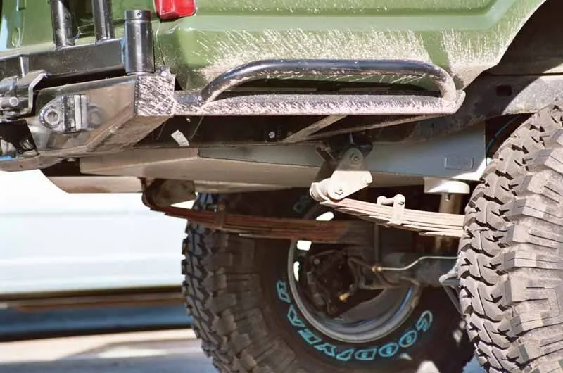

thought i would just update the thread with my tank installation. a little while back i installed a 38 gal long rang tank form man-a-fre. my factory tank rusted while my rig sat for 5yrs on jack stands awaiting for me to rebuild the drivers side after a t-bone:crybaby:. the stock sending unit and tree are used with this tank. if yours are as rusted as mine was than i would recommend evap-o-rust. i can not say enough good things about it. soaked the part in it over night and it was bare metal in the morning.
you have to cut and extend the float arm and the tree. the neccessary parts and pieces come with the tank. if you have a welder and a ruler that is in mm's than its a :banana: job. the only thing that i would caution someone about is, the tubing on the top of the tree needs to be manipulated slightly so that they do not contact the tank. i put a little to much meat into it and cracked the pressure line. i didn't know that is was cracked until the install was done and i turned the key. i didn't realize it pumped at that much pressure either. also the sway bar mounts (to the frame) have to be removed to take out the old tank.
i don't have any pre-intall pics, just post pics. i like not having to fill-up as often. i hurts the pocket when i do but thats my choice. i hope this helps someone down the line.:beer:
OH! i forgot this one little thing. the forward 4 mount holes did not line up with the mount holes in the body from the factory tank:o:mad::censor:. it took forever to elongate some of the holes so i could mount it (dremal):bang:. Man-it-ain't-free cost to much money for the mount holes not to line up and one of the bolts for the rear mount not have the right nut to tread on it.
