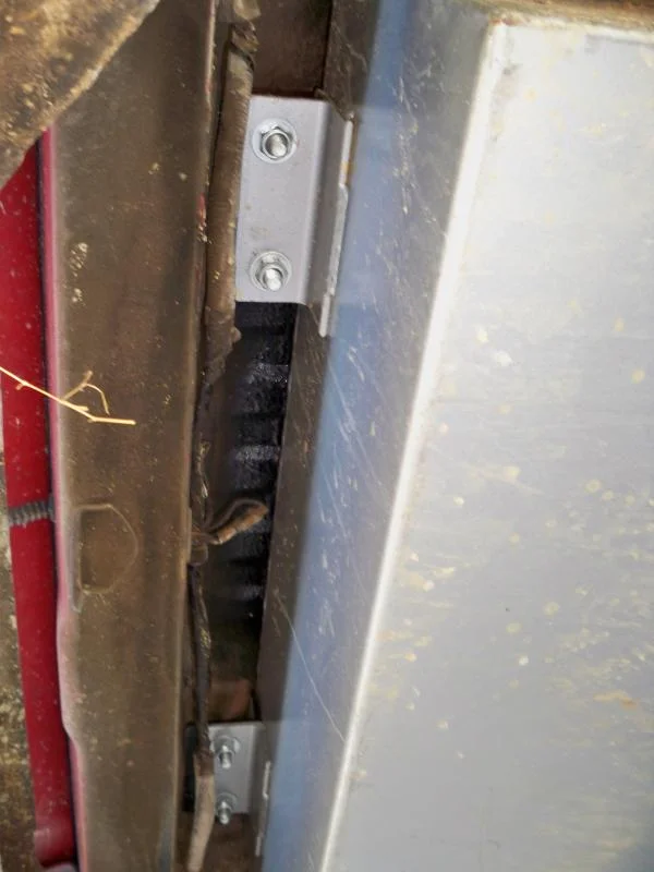

Looks good! So Man-a-fre has these in stock now? Been considering this mod for some time. JT outfitters had a better price but no stock.

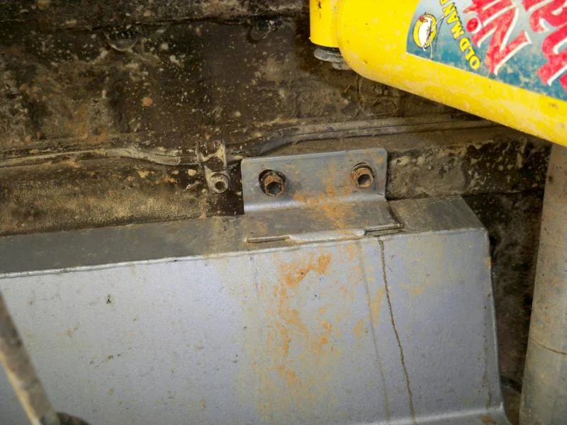

Oh, I think your shackles may be on backwards (?).
I have the LongRanger tank from MAF too, same as PismoJim's. So far I'm impressed, range is pretty darn close to 900 miles if driving conservatively on the highway.

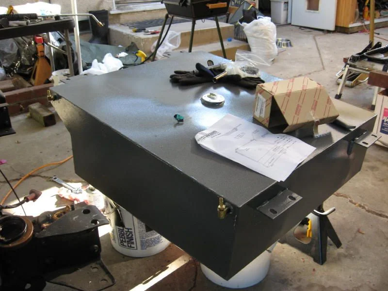

I'm getting ready to lengthen the Sender arm -- Weren't you worried that welding the ARM would heat damage the sender unit ? Or that wasn't an issue ?
So far I've found the holes for the Sender to be off - no big deal there, but as you say, !#%&^!!* for a $925 part! Stinking MAF -- I hope the body mounting holes are right on this one (for an FJ60) ...
Build quality seems to be good -- Hope it holds up. :D
S.
welding the sender arm
spike strip, i wasn't concerned about the heat affecting the sender. there's only 10mm of overlap that needed to be welded on both ends of the extender peice. plus the material isn't to thick so you don't need alot of juice coming from the welder. as far as the sender holes being off, the sender has a peticular bolt patern on a FJ62. i didn't notice it at first but when i through the seal on i realized it. so check it out before you start to modify.
i paid $730 for mine about a year ago.
ad20k, i had to install the shakles backwards, the springs had to much of an arch to install them the right way. also the exhaust is in the way on the driver side. i plan on turning them around after some exhaust mods.
X2, from someone who just had to flip his shackles so that the anti-inversion bar would actually do something.:bang:
