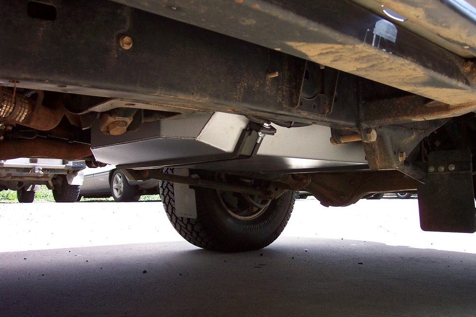

This pic is from the Long Range Automotive website for the 150L replacement tank. It does look like it hangs down a few inches, but the angle could make it seem more than it is. I'm very interested in this main tank replacement option, but like you, am wondering how far past the frame rails it goes.

This is the best photo of TLC100IFSEFR that I have seen. We brought one of these in on the last shipment and it is getting installed in the next week or two. Will ask shop for photos.
