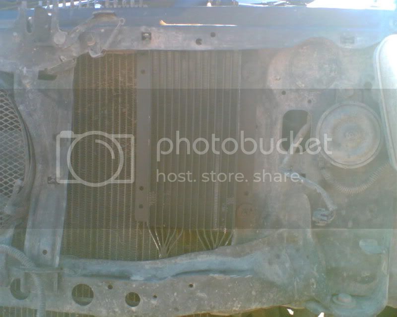

thanks boyo thats EXACTLY how i wanted to do mine, i found that image on goodle search and got that im my mind, its super tidy, good job! :clap: also thanks for the EGR advice ill do that now, ill block it off with a bolt or somthing. :cheers:
yeah i was going to take his advice, ive already done 4 of them and are working on a 5th and i really apricate the advice as he is much more knowledgeable than myself, im just a measly peon! but it seems as though i offended him :confused:, which wasnt my intention at all, seems that what i said didnt quit come thru in text as it would have thru speech, :doh: so ill try and rephrase... if i fit an EGT gauge how will it help? ive seen people say you use it like a tacho, but i dont realy understand how, surely if ur driving up a big hill and ur EGT is getting up there, u cant realy back off to bring it down especially on the highway? And how is buying a EGT gauge going to benifit me more than additional cooling equipment? (i hope thats better, i didnt mean to be ungrateful for advice or offend anyone!)
If i knew how to post more than 3 photos id show u the intercooler unit i have and am going to use, but im not sure how to have more than 3 attachments on my profile (im NOOB) thanks for all advice so far people.
nice, i just read ur write up and im going to follow it word for word, good job. love the bit about the girlfriend lol, mine would probably manage to take her arm off though! im even going to use the same scoop (trooper=bighorn over here) i thnk my cooler is alot smaller, it measures

the only problem is ive not had a body lift (yet) only 50mm spring lift, so im going to have to try and make it fit without that additional room, wich may be and issue...
A body lift will allow air to flow past and around the tranny. The autobox is a very close fit in the tunnel, and heat build up is an issue. A 1'' body lift is very easy to do, and quick too.
Fit an additional tranny cooler - they only cost about £20 on ebay. After I fitted mine, I never heard the aux. fan come on - which it always did beforehand.
Rip into your truck
Fit neatly in front of radiator

EDIT - Without a body lift, the intercooler will probably sit on top of the oil filler. Fit decent quality spring clips and you will be able to pull the cooler off quite easily to allow oil fills.
