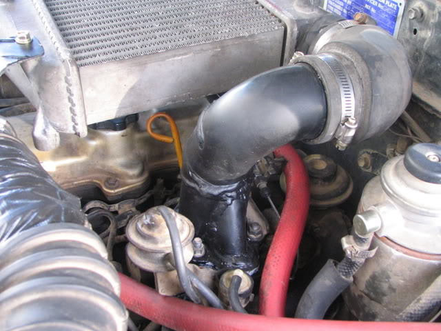

haha ive not done enough off roading to suss out my MPG then, but i imagine it would be turd lol. the diesel loves hauling the 2 tonne lump over stuff haha NOT. heres the intercooler im using, just removing the plastic LHS pipe (it unbolts from the top tank) and put in a straight flange then cut down the RHS pipe and use some sillycone joiners. and do the tedious task of getting in there with some tweezers and straighten out some finnage.

If you have any R32 Skylines over your way you could fit one of their factory coolers that they usually throw away when upgrading, this is with a 2" body lift and would be tighter without it but should still fit plus heat soak from the engine would be a problem when slow 4WDing.
Will need both of them from the skyline (1 on each side), then swap over 1 end tank (gently prise back tabs then push back into place) so you have the same shape end tank on both ends facing different directions.

nice job DJ, yeah im in NZ we have R32s, ive owned 2 lol. i was thinking about using a skyline core but didnt know u could flip the end tanks like that and i didnt wanna pay 2 have the flanges moved etc, there a dime a dozen over here n u can get them for like NZ$10. ill post a thread for my intercooler job once ive got all the bits, ive just gotta get the silicone elbows
