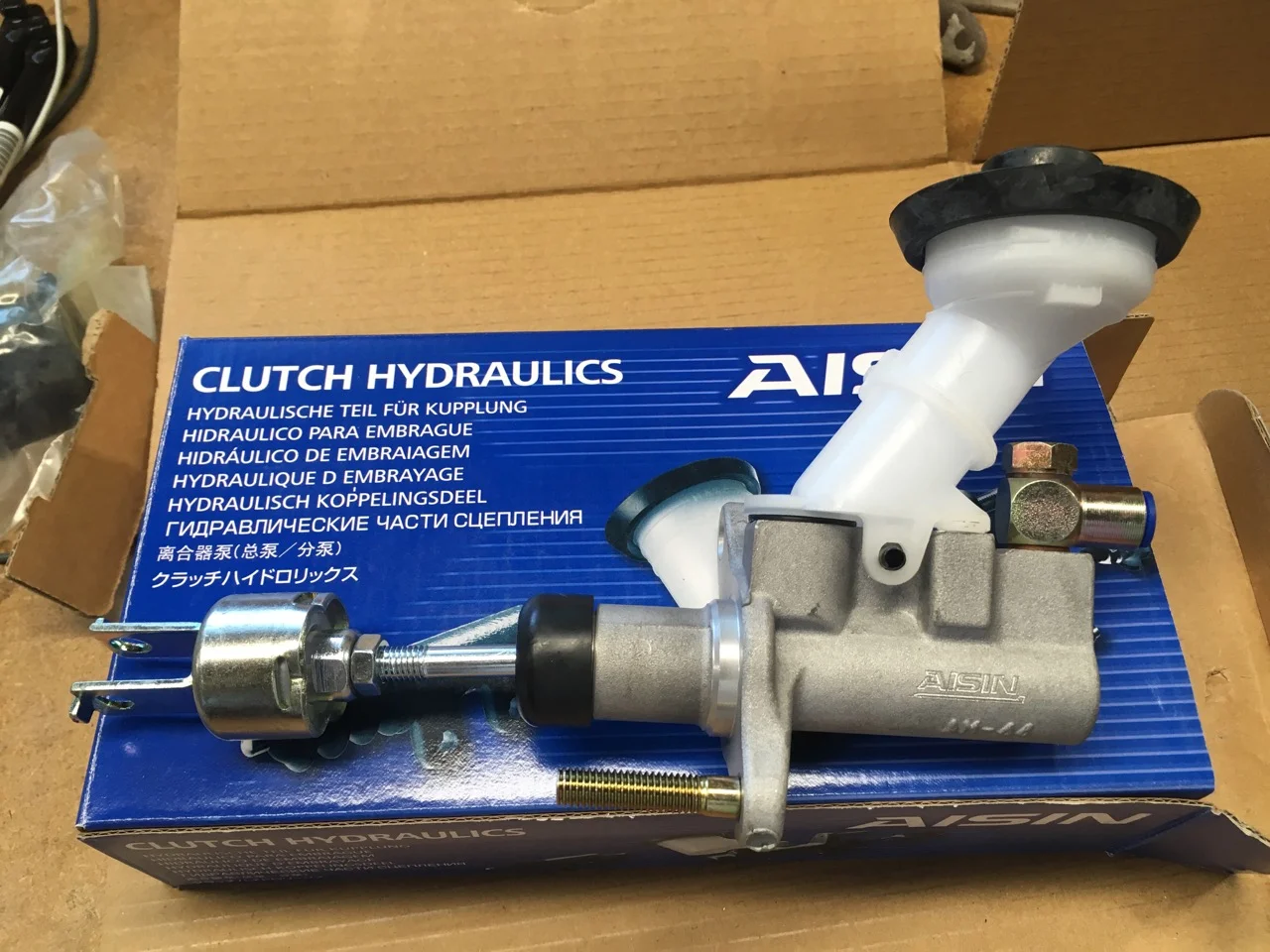

I replaced my master cylinder last summer, the parts are still around. I used an Aisin master cylinder, PN CMT132A. Also, rebuild kits for the master are available (I have one sitting in a box). The internal parts of the master cylinder are the same dimensions as the 1990's 3.4 V6 parts that were available Stateside, and the same goes for the slave cylinder. I don't know if new complete slaves are available, but a rebuild kit should be.

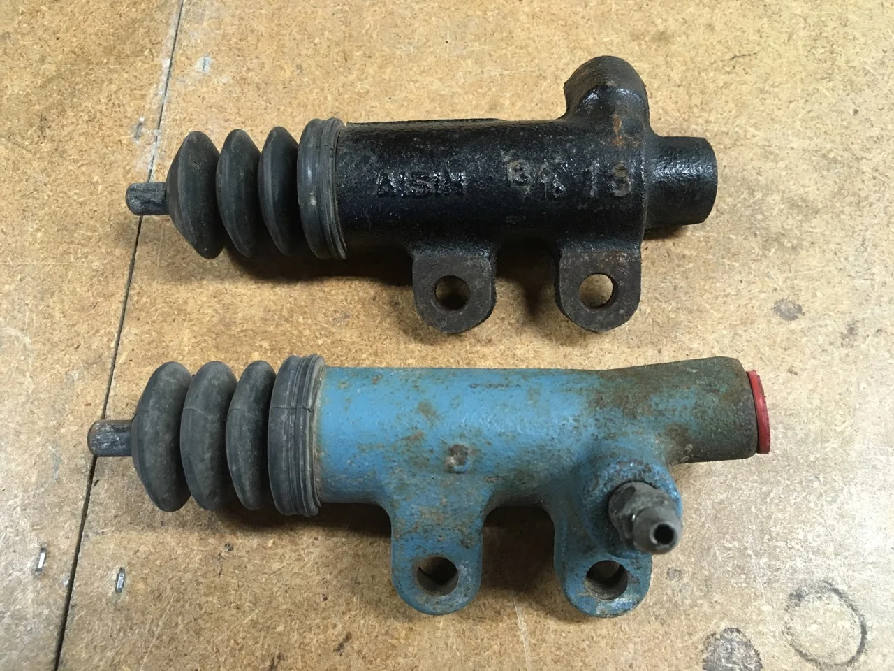

Here is my original slave cylinder next to one from a late '90's 4Runner V6. Bore and stroke are both identical, the only differences are the locations of the mounting ears, clutch hose port and bleed valve.

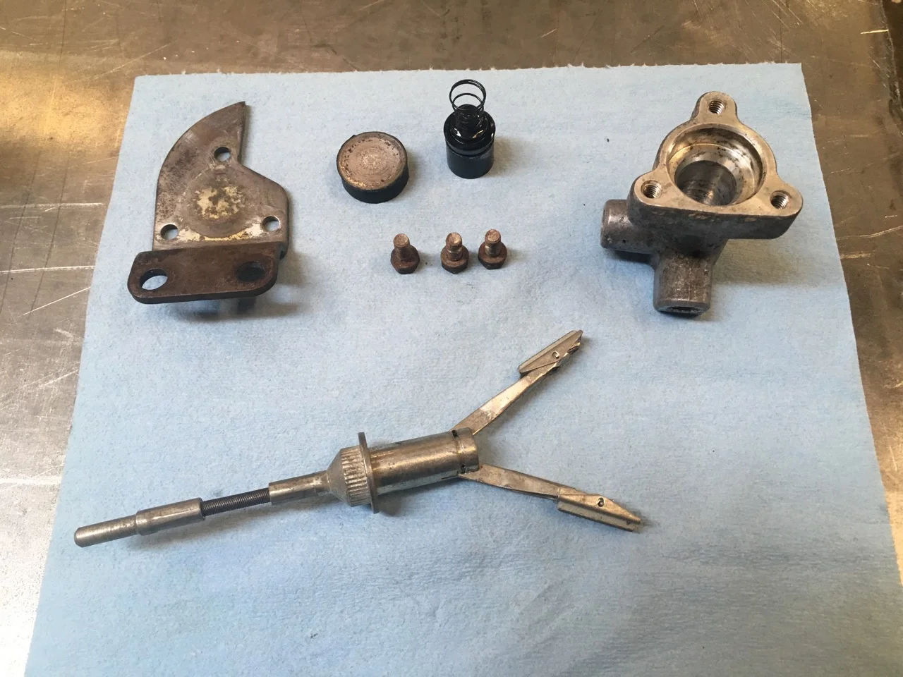

While you have the system apart it is probably a good idea to take the accumulator apart and clean it out inside. Mine was pretty grimy after nearly 30 years, I made a new gasket for it and used a brake cylinder hone to clean up the deposits in the bore.

The master cylinder is a direct replacement, identical to the original. Aisin was an OE manufacturer for Toyota, so I wouldn't be surprised if the original master was actually an Aisin as well. My Prado is a '91.
