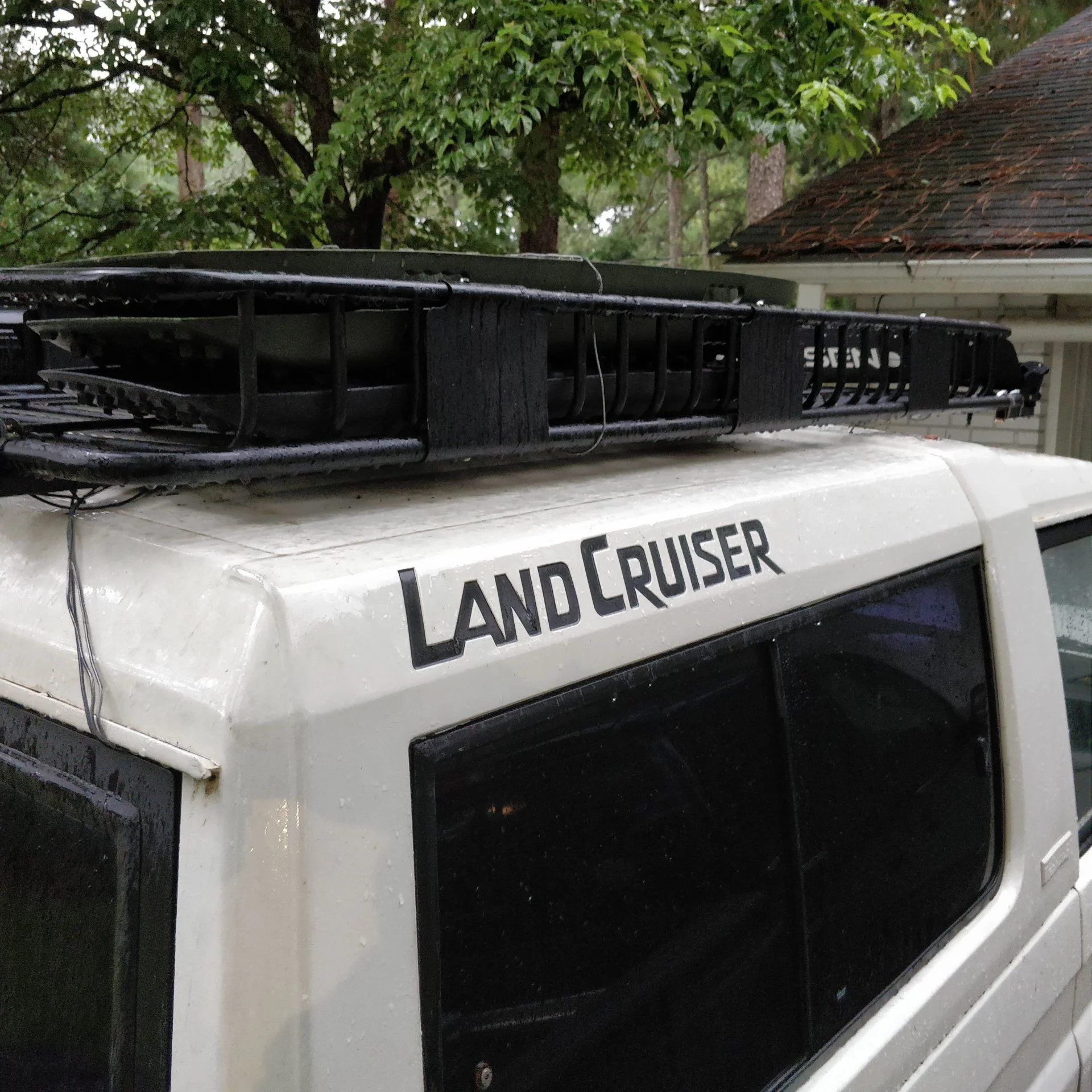

I have a bj73 with an FRP top. I bought an inexpensive 84-inch arksen roof rack off of Amazon for less than $200. I shortened it 6in to fit the bj73 top. I bought two sticks unistrut galvanized channel from Lowe's. It's next to the conduit in the electrical section. this channel was then cut to the length of the roof rack and bolted to the bottom of the roof rack using standard conduit clamps. This stiffens the roof rack and spreads out the load. currently it is held to the roof with four bolts that go straight through the top of the roof. thick rubber washers, fender washers, and copious amounts of RTV we're used to bond this to the roof. There are no leaks. I have not however loaded it beyond capacity of the roof rack other than me walking on it when it was loaded down. Using a heavy bead of RTV the full length of the unistrut gluing it to the top of the roof in addition to bolting it down would truly help spread the load and less than some of the creaking when it vibrates but I have not done this yet.
