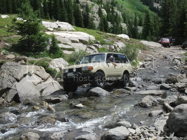

Lined my 80 Tan

I did mine two years ago and it looks new. Big thing is to get a product with a UV protectant, or you may not like it much in a couple of years. Does add quite a bit of cost.
Outside of physical damage, I am not sure what would go wrong with a cured, UV protected, poly coating as long as you prepped correctly.

Not yet. I literally just did this a week ago. I'll be wheelin' for 4 days next weekend, and I'll report back how it holds up.
:steer:
The one mistake I made with my 40 was wheeling it less than 24 hours after aplication to the rear doors and a few other spots. These stained with the mud that got on it. Yes, the instructions say not to do what I did. No I didin't follow the instructions....
You're more than a week, so should be golden, assuming your directions are simular to the ones I didn't follow with durabak. Flares on 80 have held up much better color wise due to following instructions and stuff like that.
Yeah, full cure with the Al's is 72 hours. I should be good to go!

I tend to keep things easy.
Sanded.
Primed with rustoleum primer.
Painted with rustoleum gloss black.
Cleared with rustoleum clear.

3 gallons and a bit more, I believe it was sprayed. not rolled. will find out from local Rhinoline shop that did the panels etc.
Not including engine bay or door jambs... added weight was significant. I might ask owner to do a weigh scale test...
havent looked into charicteristics of Rhinoline but I believe it is Poly and maybe other compounds.
It was quite thick I will admit.
:cheers:
When I rolled on my Durabak in three coats it was only 3 gallons and ~30 lbs. I'm not sure how you manage to use more than 3 gallons and how you get polyurethane with rubber bits to weigh a whole lot?
I don't think the added weight would be more the than the weight of three gallons, unless Al started to put black holes in the mix.

No this is a great product for all of the above. Goes on much thicker than the more well know DIY kits. There are no ruff particles in the mix like herculiner or the like. This is a great solution for lining the interior of your 80 too. Not as soft as carpet though:D
How's the noise factor inside once the carpet/liner is removed and it has been sprayed?
:doh:I'm a little behind. That's what a weekend of wheelin' will do!
:hhmm:Hmmmm... Black Holes?
We didn't line the inside. Just the outside. I can tell you though that the noise inside is noticably less even with the mudders on than it was before. Also, we lined the wheel wells with black liner and it keeps the rock noise down too (rocks hitting the wheel wells and body).

Ok, status update:
I ran Holy Cross this weekend. I'll get more pics up tonight.
Stock on 285's
There were rigs there with up to 49" tires. I did pretty well IMO...
Nay hit the nail on the head- This is the EXACT same color as our roads out here. I tried all weekend to get the darn thing dirty, but it wouldn't ever show it. I'll get pics up tonight of what I mean.
Durability? Awesome. Amazingly, and somewhat disappointingly, the body didn't touch any rocks this trip, it did touch plenty of trees though. We ran Boulder Mountain and the branches were scraping both sides like crazy! But no scratches on the liner! The truck bumped a tree and it left a dark spot on the passenger side. I think it's just sap, but it wouldn't come off in the pressure wash. I'll get a pick and try to clean it another way.
