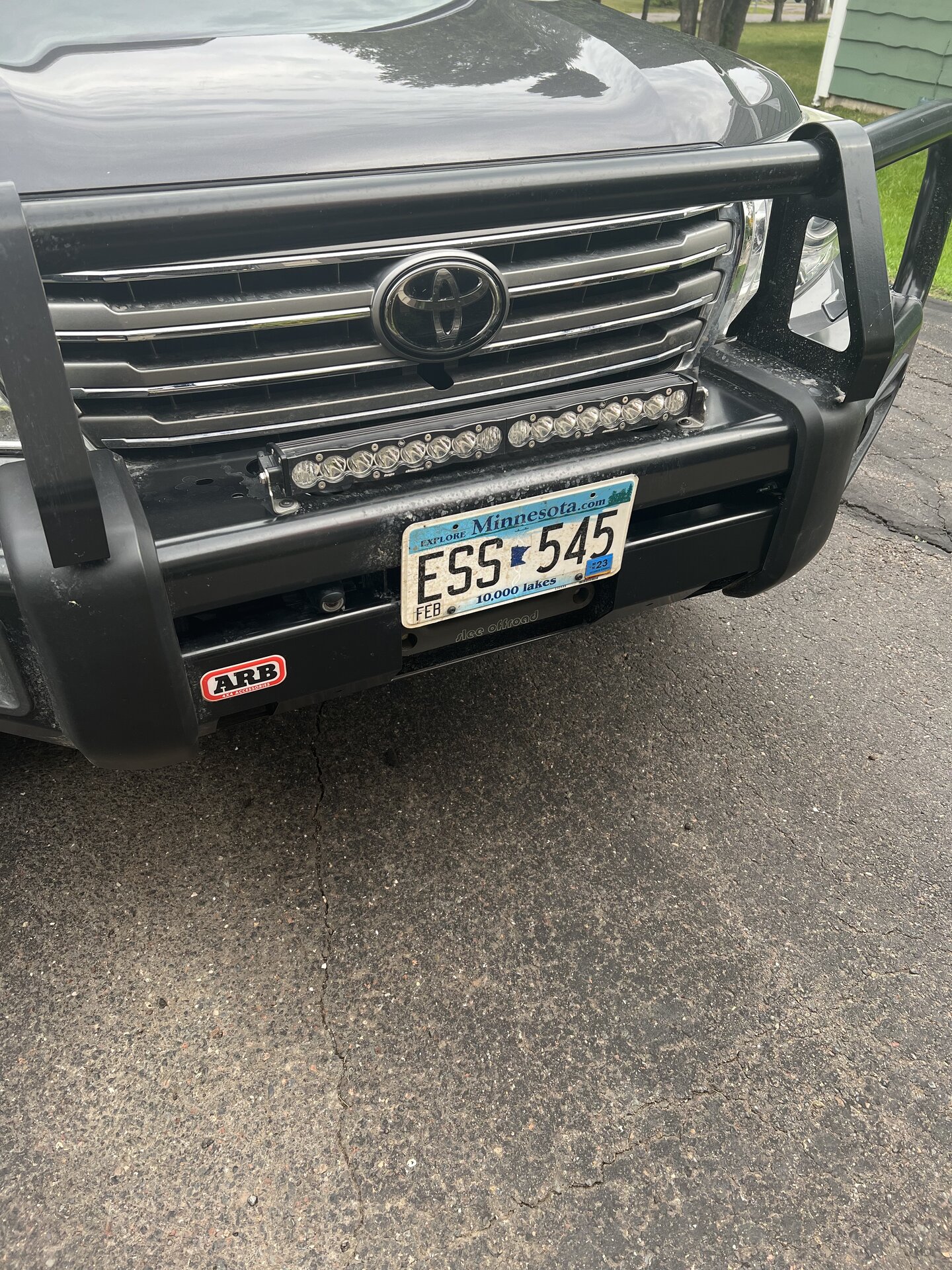

Hey fellas,
Kind of a dumb question and I didn’t want to hi-Jack the other light threads…
I had the Toyota OEM fogs on my 2014 LC and they just weren’t doing it for me. So I had my local shop put in new LED bulbs and they were 100 times better.
However, when I recently had my ARB front bumper installed, the OEM lights no longer fit, so I had to use ARB’s alternative, which aren’t that great.
I also had about a 14’ lightbar installed on the bumper (on the flat portion in the center in front of the grille; not on top of the rail).
When I use the light bar, I tend to blind other drivers.
After all that long-winded backstory:
Can I simply “aim” my light bar lower and use it as a quasi-fog? Is it that simple, or is there some kind of calibration involved?
Thanks for your patience!
Generally you want your fog lights to be amber in color, which is better at reducing glare off the fog/snow in front of the vehicle. Also you’d want a sharp beam cutoff at the level of the light, in an attempt to keep the pattern low illuminating the road but preferably under the fog, again to reduce glare in front of the vehicle.
Your bar won’t have the correct pattern, even if you aim it down, but may be amber?
Short answer: No.
Technically you can wire it up, but DOT-approved fog lights have a sharp cutoff in order to ensure they don’t blind other drivers. Driving with the light bar on is illegal and can get you a ticket. A regular light bar sprays light everywhere and will blind incoming drivers. Don’t be that douchebag.

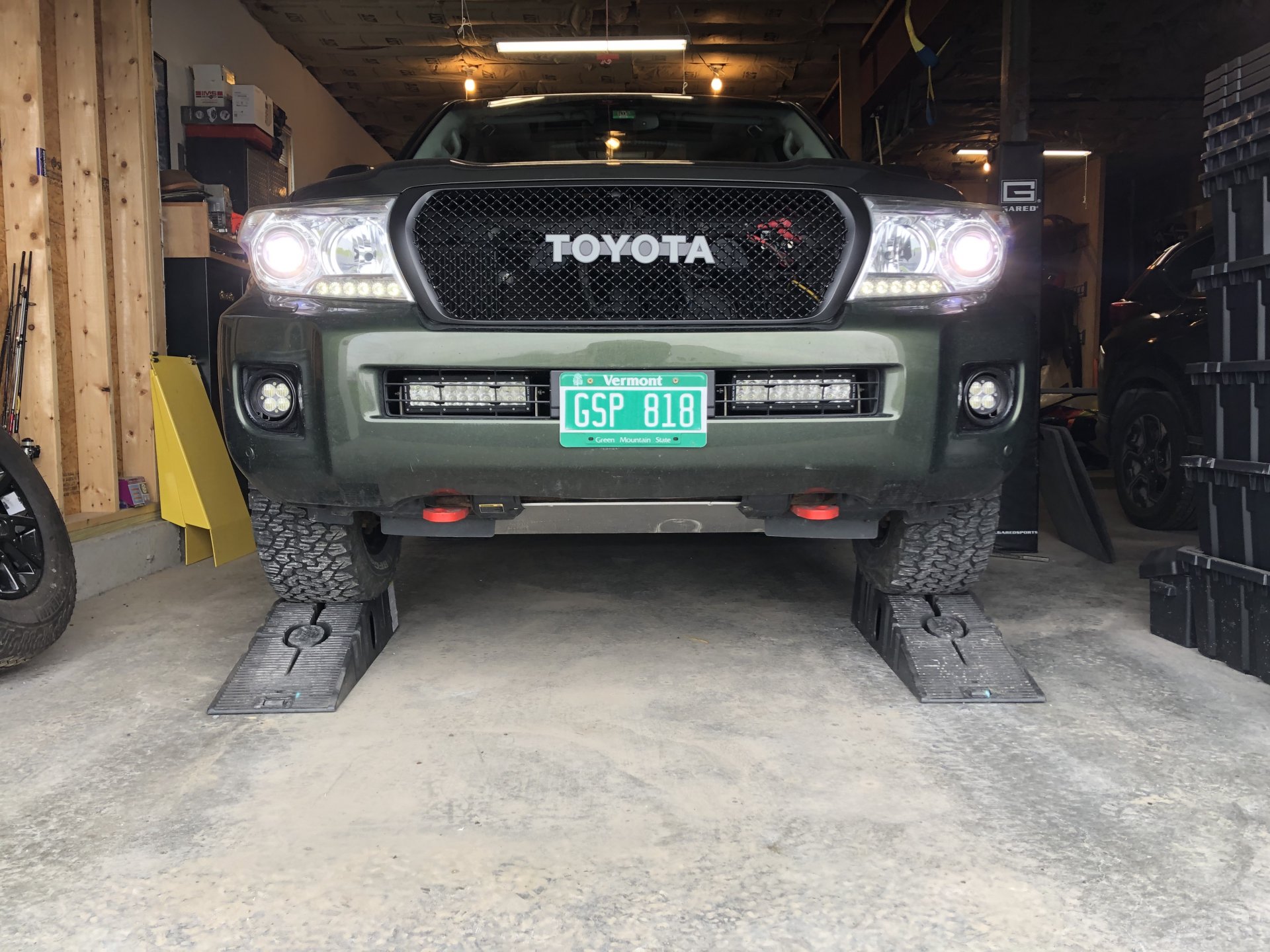

I just went through this. None bolt in directly, at least for 08-15 Landcruisers. 13-15 LX got lucky and has a smaller fog lamp housing which shares dimensions with some tacomas.

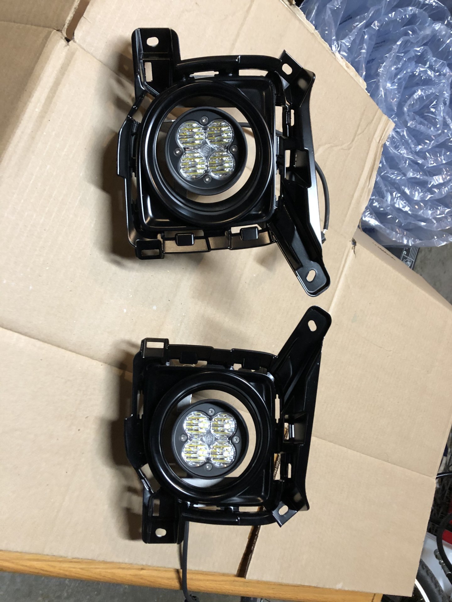

I got some Diode Dynamics fogs recently and plan to build adapter brackets to make them slot into the stock 2013 spots.. but that'll be a project for a couple months from now. They wouldn't be difficult.. some small strips of metal with two 90° bends in them. IIRC @CharlieS had a shop fab up some brackets to accomplish the same thing, if you want to do some digging for the pictures.

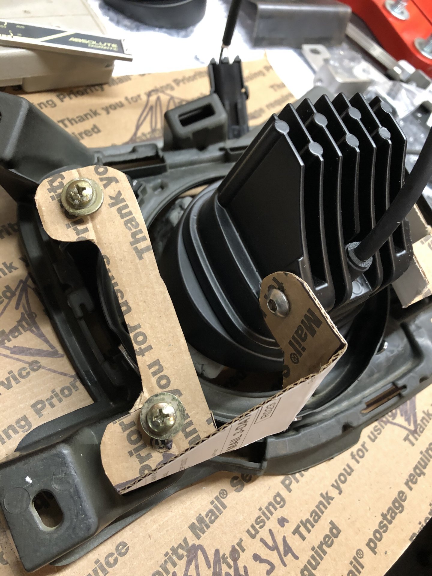

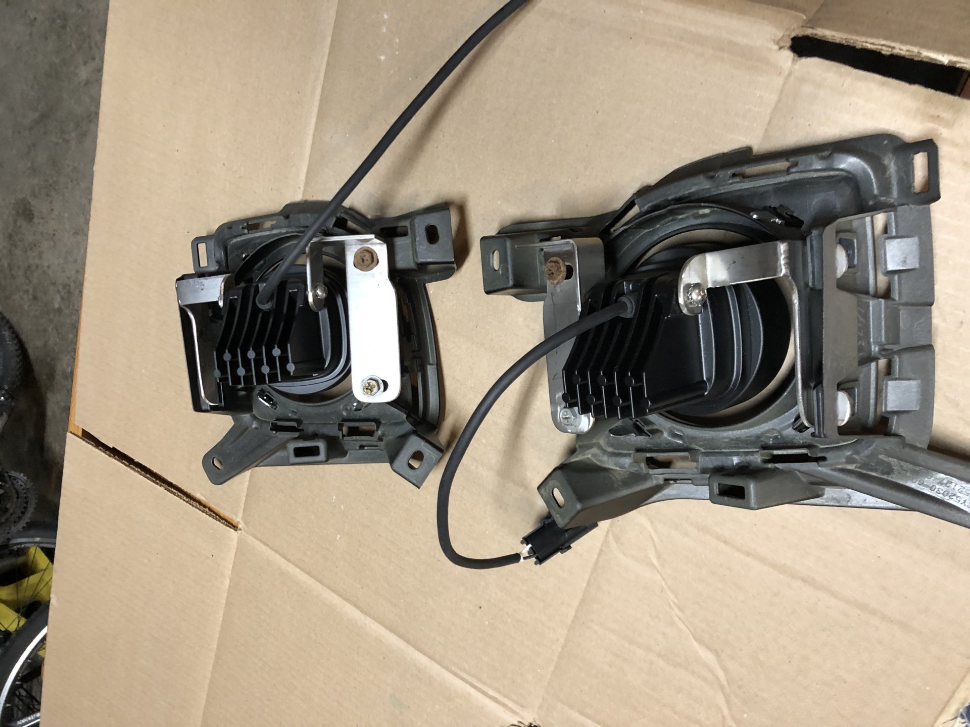

Yes, I did. I've posted pictures as you mentioned. I did some CAD (cardboard aided design:)) templates and brought them to a local metal shop and they built them out of stainless steel. They were expensive for what they were - it was all shop labor expense, and a tiny bit of materials. I sent the cardboard bracket templates to another 'mudder who was going to look into producing them. Guess that didn't work out.

Thanks for posting the details.
Did you strip the chrome before painting the surrounds? If so how?

Thanks for all the good info. I figured it was better to ask first and assumed that it probably wasn’t that simple. I’ve attached a photo below for reference.

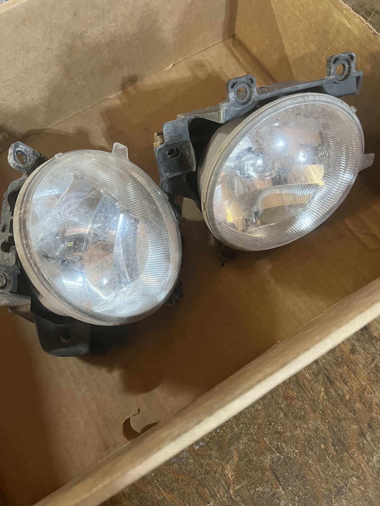

I also added some pics of the OEM lights that were removed that have the LED bulbs. They are crazy bright. If anyone wants them, let me know.

In December I finally got around to the fog lamp project I teased above for 13-15 LC. Made out of 1/8" aluminum strap available at a hardware store. I did try to 3D scan these for printing out of plastic but had a lot of trouble getting a good scan.
