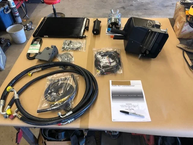

It has taken me a long time but I finally installed one of the aftermarket ac kits that I have been importing for some time now .Having been around cruisers and mainly diesel version 40/61/70 series I think it is safe to say that no 2 cruisers are exactly the same and toyota changes details on them on what looks like a daily basis so some details might be different on your install.
I installed this on a 1990 HZJ73 that will soon be going to a well respected Mud member , this cruiser was sold originally in the Netherlands and came with no rear seat mounts and the FRP top without windows specific for that market.

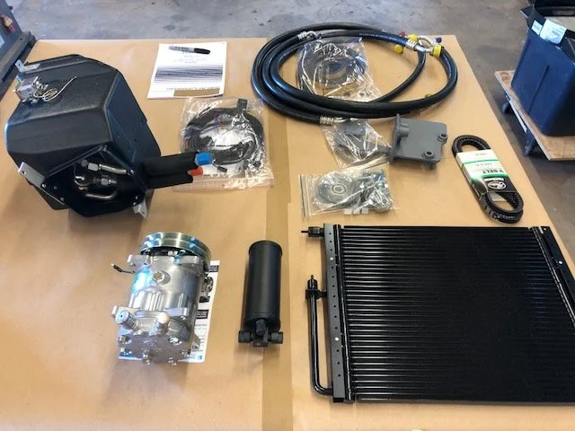

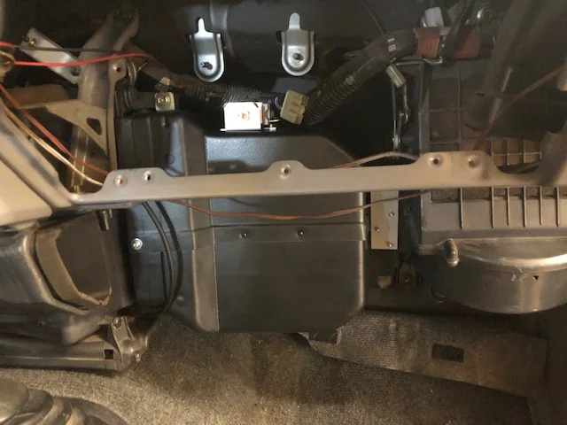

The complete installation of the kit took me around 2 and a half hours and the kit comes with a real nice instruction manual in 4 languages , the manual has a template to drill in the firewall for passing the lines but this one already had those holes from the factory and I just had to remove the rubber plug .

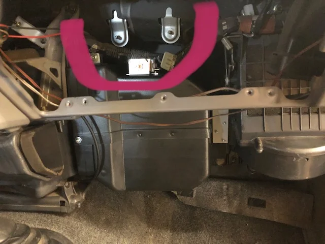

Condensor box fits nicely under the dash and most people wouldnt even know that this is a aftermarket unit rather then oem

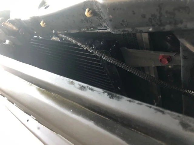

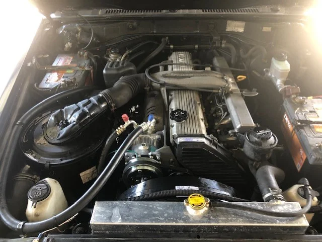

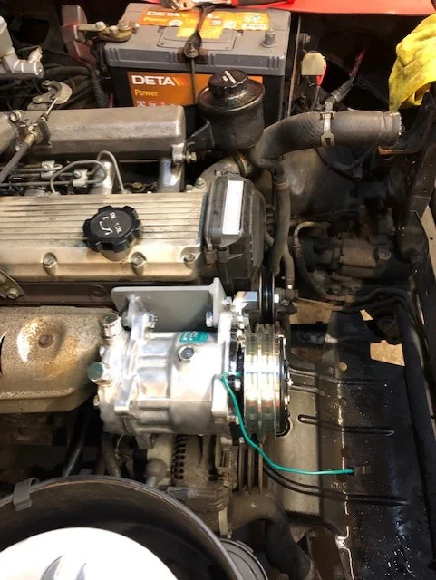

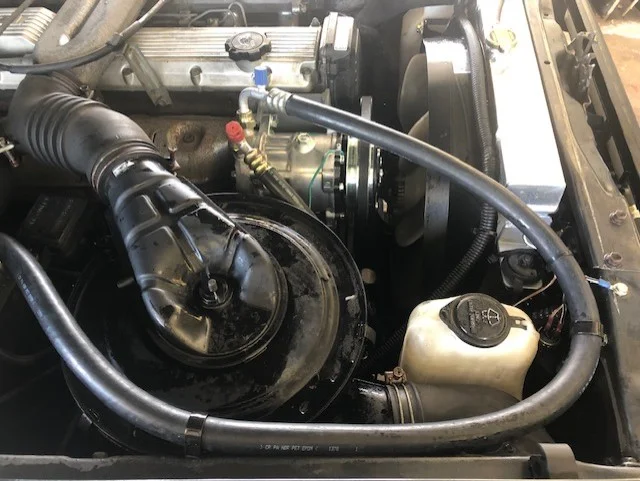

After this was done I started on bolting up the bracket that holds the compressor and I did had to grind a bit off one off the spacers to get all the mounting holes to line up perfectly , pretty simple to see once you hold it next to the engine, after the bracket was installed I bolted the compressor on to it and started laying the lines out and put the condensor in front of the radiator and drilled a hole in the radiator support to have easier acces to bolt it to the condensor , this is not mentioned in the manual as at the time the manual was made in the 90's some parts where slightly different and no longer available and the new parts where never included in the manual . The on off switch is a different model then what was used back in the day also so using logic is preffered instead of following the supplied outdated schematic.
BTW radiator does not need to be removed for this but I was changing out the timing belt and water pump at the same time on this one .
After I hooked everything up I drove it to the nearest shop to vacuum and charge the system and it works flawless , just as a guide line my local shop charged me 95$ for the 790 gram of R134 and the additional oil that they added to the system.

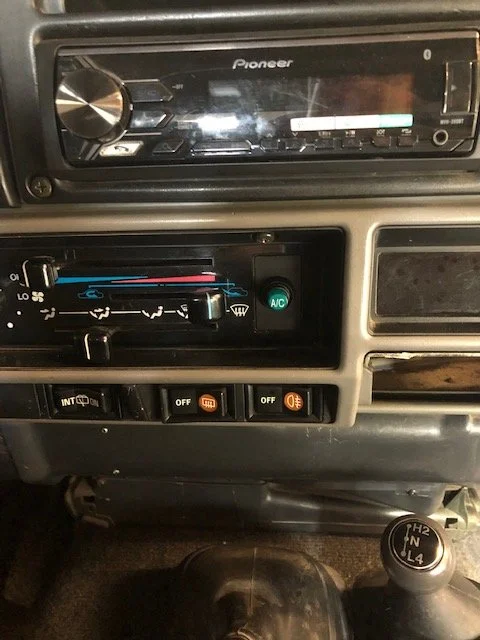

Is there a separate cooling temperature control in this A/C kit (like in OEM)? I can see there is the main A/C switch on one of the pictures. Does it mean that when it's on it always works with full power and you can control the temperature only by means of fan speed and/or hot/cold air mix lever/slider?
Hi,
You mix the temp by adding warm air to the system.
