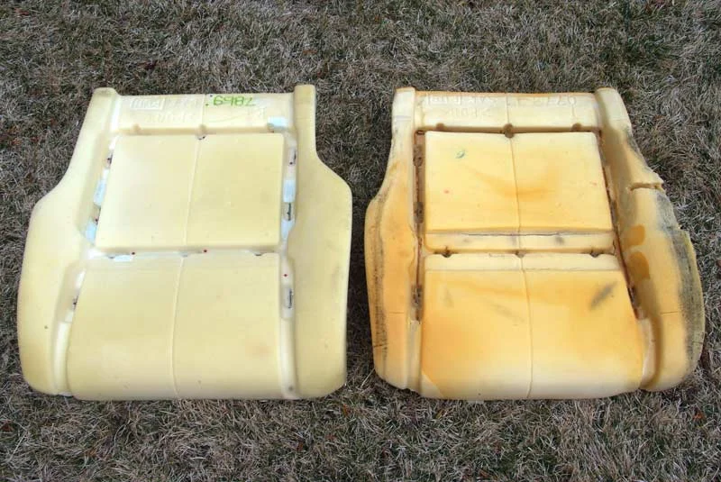

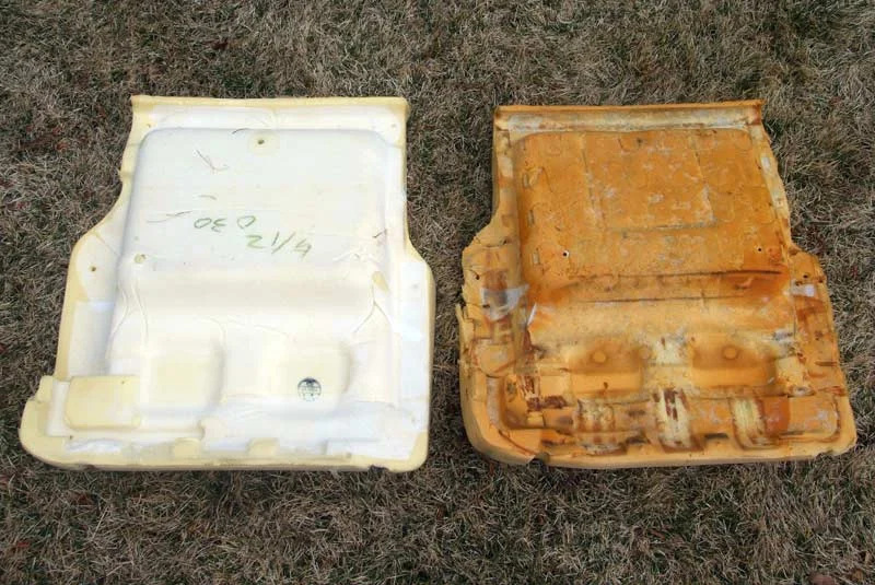

As far as I can tell the Lexus seat foam is more finished and softer. The Toyota foam appears to be heat set and a touch firmer. The foam is more rigid with a harder shell to it on the Toyota version if that makes sense.
71512-60070 Lexus Front seat bottom - driver (US)
71511-60070 Lexus Front seat bottom - passenger (US)
71551-60140 Toyota Front seat back - driver (US)

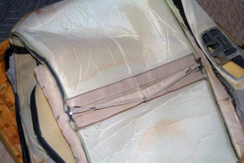

Ok, so in the first pic, on the left, we have a sample of the Lexus seat foam. The foam on the right is the Toyota version.

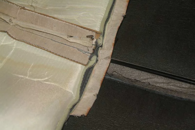

The reason the Toyota foam has that relief cut out the middle of the seat bottom is that there is a plastic support sewn into the leather for the rib that you see in all Toyota seats. These are on the seat bottom and the seat back.
For those installing the replacement leather from AATLAS1X, his have a much smaller band for the ribbing. The difference is about an inch. Romer installed the Toyota version over Lexus seat foam and hasn't mentioned having an issue with it. I will cut a small relief out of the foam but it will not be as large as the Toyota one.
Lexus = no rib
Toyota = rib

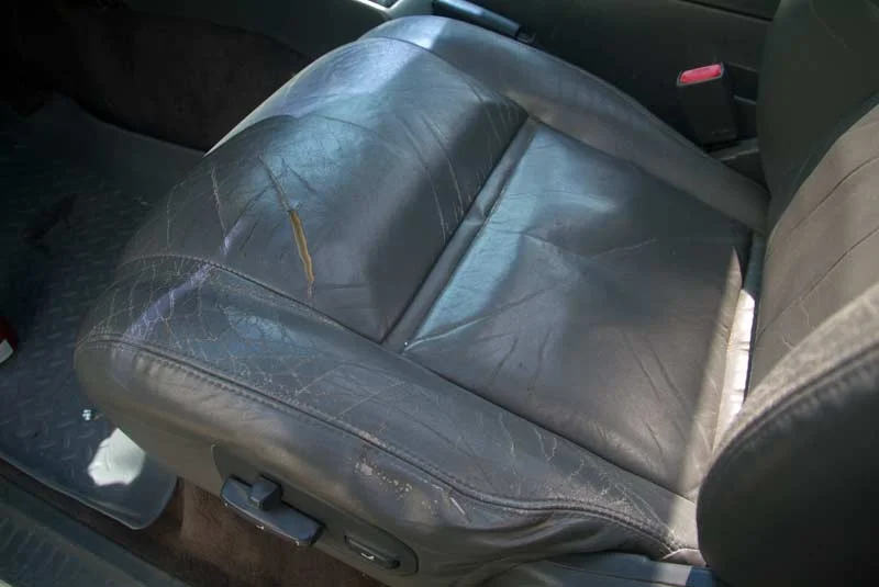

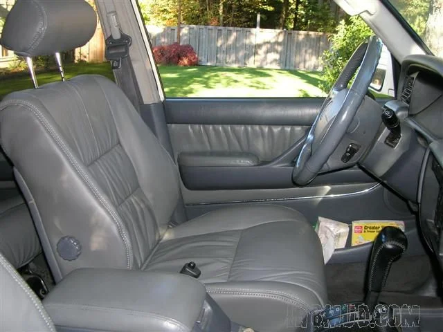

Good lord I need to get the new leather from Shane (AATLAS1X) installed sooner than I thought....the picture of my seat bottom is just sad
I just replaced my sad manual seats (dealer-installed leather that was completely destroyed) with a very newish set of Lexus seats. I cannot believe how much more comfortable they are. I seem to sit higher, too, which is handy on the trails.
Thanks Mike for doing the legwork. I am thinking of using Lexus foam in my Toyota seat bottom. So, all I have to do is cut a small slit in the Lexus bottom foam for the leather "plastic support" to go through and attach via hog rings?
