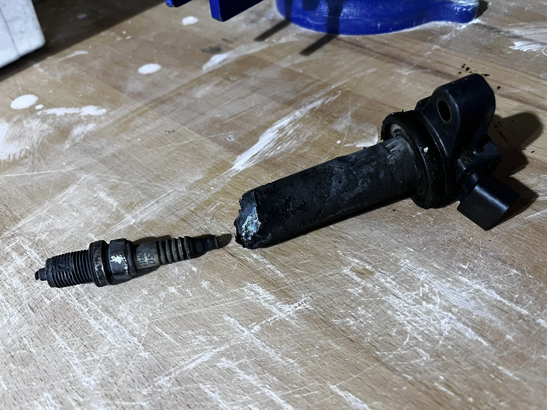

welp, looks like I found the problem. Anyone seen anything like this? Spark plug was loose, and the end of the coil pack is gone. I vacuumed it out as much as I could and tried to put a new plug in, but I think the threads are messed up. My fear is that some of the debris from the coil pack is in the block.
Whats next, shop? I guess they would try to re-tap the plug hole.
Thoughts?
View attachment 3507004View attachment 3507004
Thoughts?
There are some threads regarding blow out of loose plugs.
You can do a time-sert or helicoil repair with the head on.
It's been running like that for a while so if it's been running well up till now I'd say you should be ok and that no damage was done within the combustion chamber. You can borescope it to verify though. Me personally, I'd time-sert it and go.
