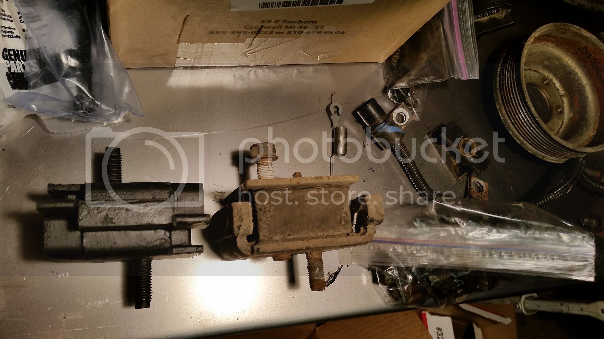

Had 20min the other night and compared the 1st Gen cummins engine mounts I got on rock auto with the Toyota ones. They are almost identical stud spacing thickness and overall size. So they should work great.
That's an important part of the puzzle solved and at a budget price as well!
