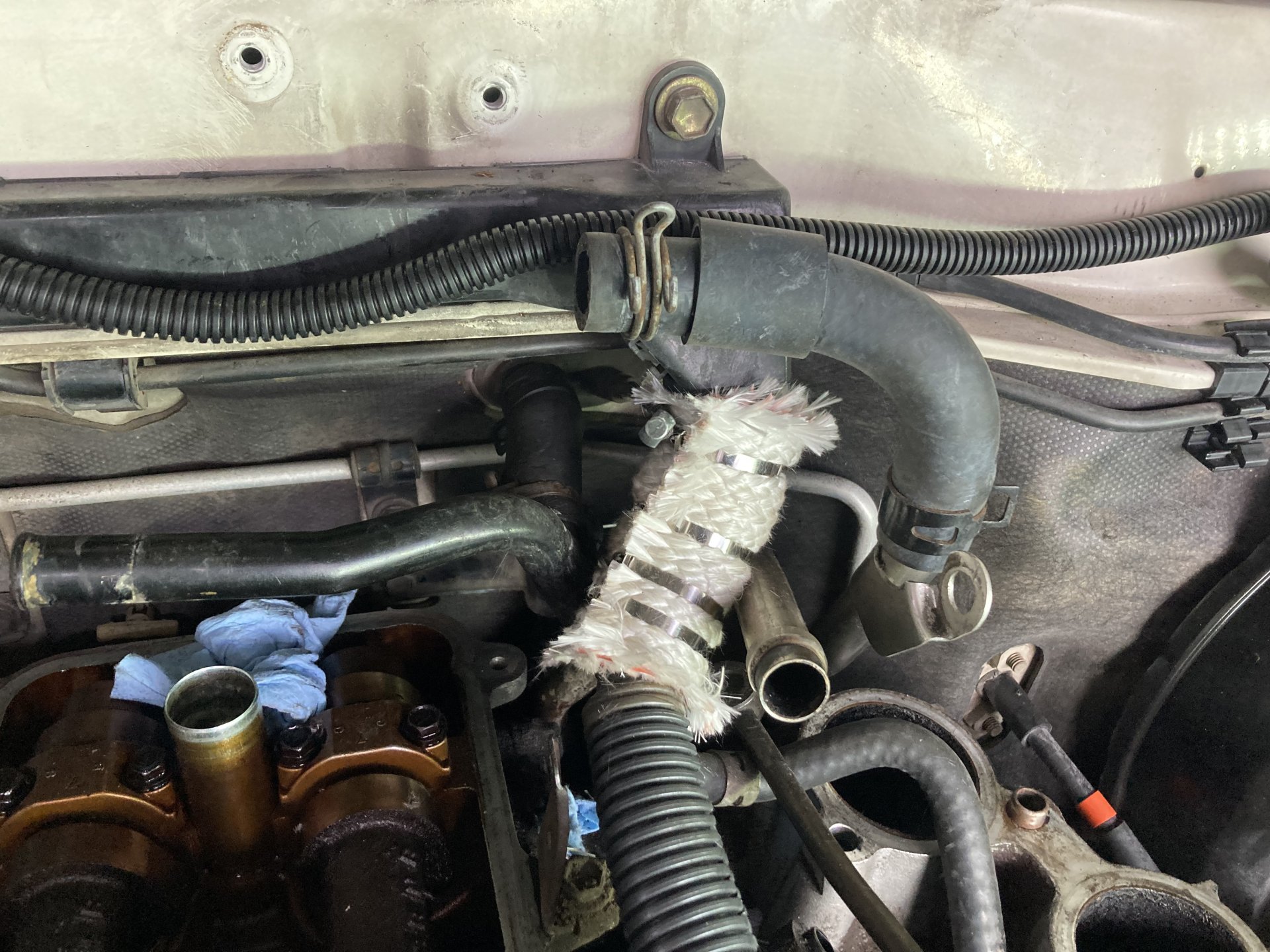

I finally had a chance to unwrap the main engine wire harness and have a look under the ultra cooked heat wrap. It literally disintegrated as I tried to unwrap it. I assumed the worst, but it looked intact. It may be brittle under the individual wire insulation, but no melting.
I wrapped the exposed wires in Tesa tape, what I used in my NSS repair to cover the individual wires.
Then with thanks to @FMC80 I was able to wrap the whole section in a fur coat.
A long while back Pell sent me a section of heat shield wrap, which has a cool name, which I have unfortunately forgotten. It was cut to size and all ready for me to wrap around and secure with stainless cable ties.
This was nice to wrap up…literally.:cool:
Greg,
One of us installed the firesleeve wrong and I think it's definitely not me (probably/maybe/lol). The orange goes on the outside and the furry fire-resistant blanket goes on the inside and protects your wires. Thoughts from you or anyone else?
Pell

Greg,
Pell
o_O But I like the way it looks better this way….
You are correct. I’ve got it inside out. Drat. I think it likely will provide plenty of heat protection this way, but I will fix it, I just need more SS cable ties. I’m really it sure why I thought it went furry side out, but it was intentional at the time! I claim no expertise here! Thanks for catching that and speaking up!
Greg, anytime my friend. I wrapped my harness, used metal zip-ties like you, then I trimmed/burnt the furry parts so it doesn't stick out like my pubes when I wear a banana hammock g-string.
