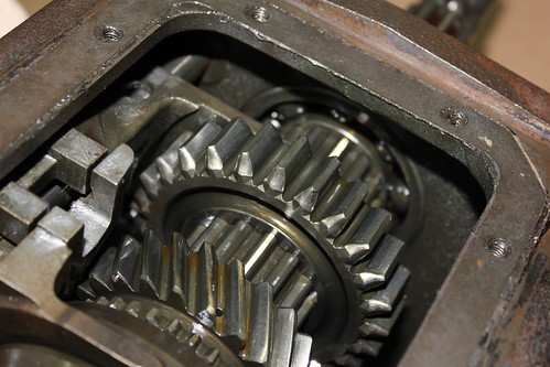

Also pulled the top cover off the transmission. The gears look pretty good compared to some that I've seen before. Does anyone see an issue with running these as is? I've got a gasket and seal kit but could not find a rebuild kit for this year (might not be looking hard enough though).

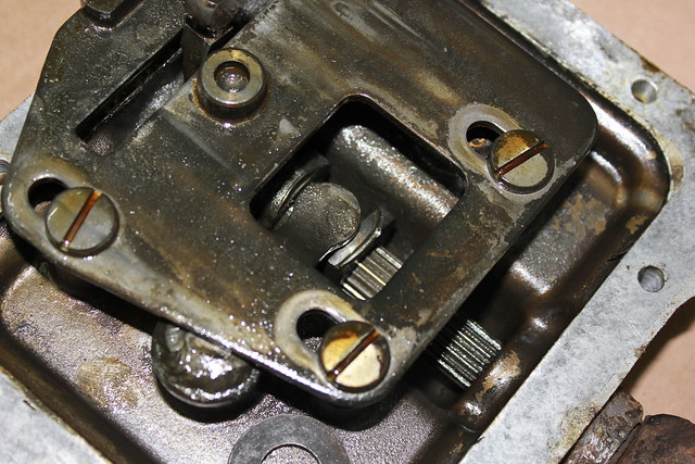

I will need another inner shift fork though (#29 in the SOR image). This one looks as if it was not aligned correctly. Would this be caused by not tightening the plate that moves back and forth (#14). If someone has a top plate or just this part for sale (#29), please PM me.

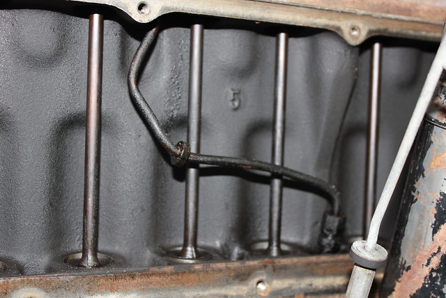

Also need a non bent to hell rocker oil tube. This one could work if it was the last one on the planet but might as well replace while the side cover is off. Please PM me if you have one that you'd part with!

Was able to find a better oil tube and another trans top cover!

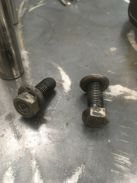

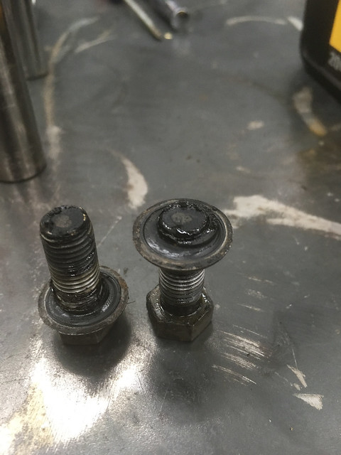

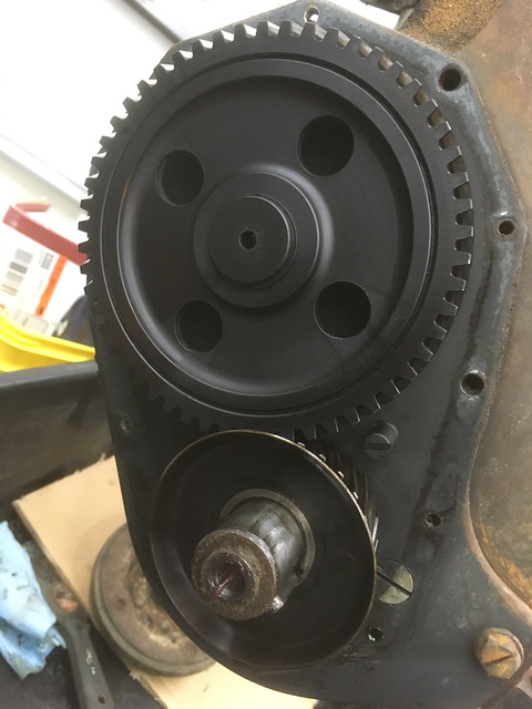

Pulled timing cover and the timing gears look great. I was surprised by the 'washers' on the two 14mm head cover bolts. I think I saw the same on another F135, maybe @Jason Reed build? I wonder if they were oem or a Toyota based remedy for those two bolts leaking?
