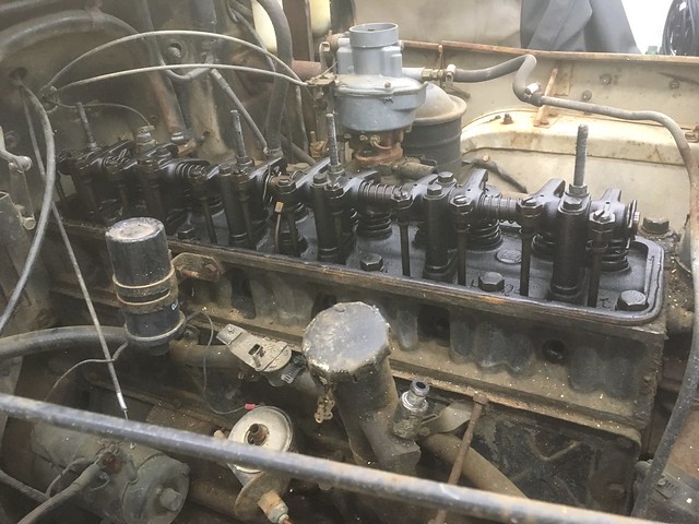

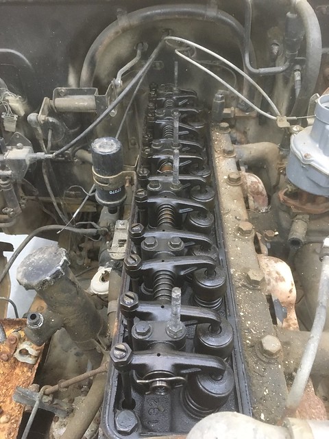

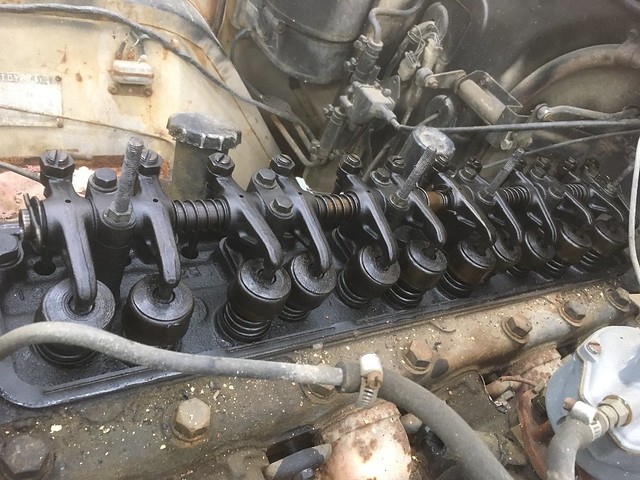

Pulled plugs, squirted some marvel oil into each cylinder and pulled the valve cover. So far so good...no glaring issues. The plugs might not have been F135 correct as the replacements I picked up are shorter. They weren't banged up though.
As long as the oil doesn't look to have any surprises and the engine rotates freely then I likely won't dig into it any further. I have no indications from the PO of any issues.
Dang valve cover was glued on, lol!
The engine in mine looked very much the same. Spun freely, so I poured oil over the valve train, and cranked it with the plugs out and fuel disconnected to get oil pressure up. Mine runs well now with fresh ignition bits, new fuel pump and filter, and a thorough rebuild of the carb. I suspect yours will be similar.

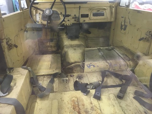

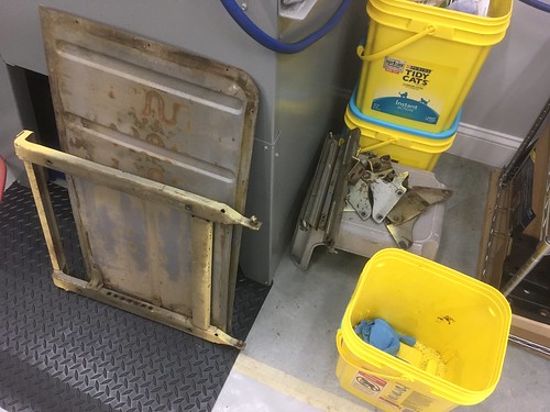

Pulled and tore down the front seats in preparation to drop them off at the blaster. I purchased a set of Spector covers and foam...assuming I can toss all the old foam/burlap padding?
Found 22 cents; pennies from '68 and '71 and dimes from '77 and '74. Was nice for each and every bolt to come loose with no issues. Maybe that's an omen of how this refresh will go!
Dropped seat frames off at the blaster earlier today. Should be ready next week.

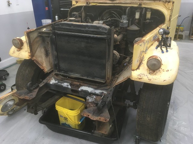

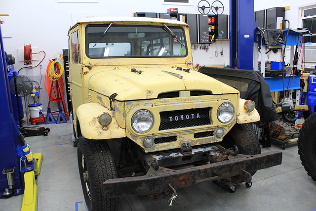

Continued tear down and broke 1 bolt...not bad. I have been soaking with Kroil for a couple weeks. Drained the rad and antifreeze was still green which was a plus.
It appears the rad is original and in OK shape minus some fins near the front top section. Am I better off to just bite the bullet and get a new oem or have this one cleaned? If I go new, should the current oem version fit? I think it's 4 vs 3 core like the current one.
I'm struggling with how deep I go on this one. My appetite for another frame off is minuscule at best. My plan was to clean, rewire, replace soft parts, pull drive train and clean/rebuild as needed. Am I making a huge mistake by not taking it just that much farther and paint the body??
No, you are not making a huge mistake by not taking it further and painting the body.
Leave the body as is.
