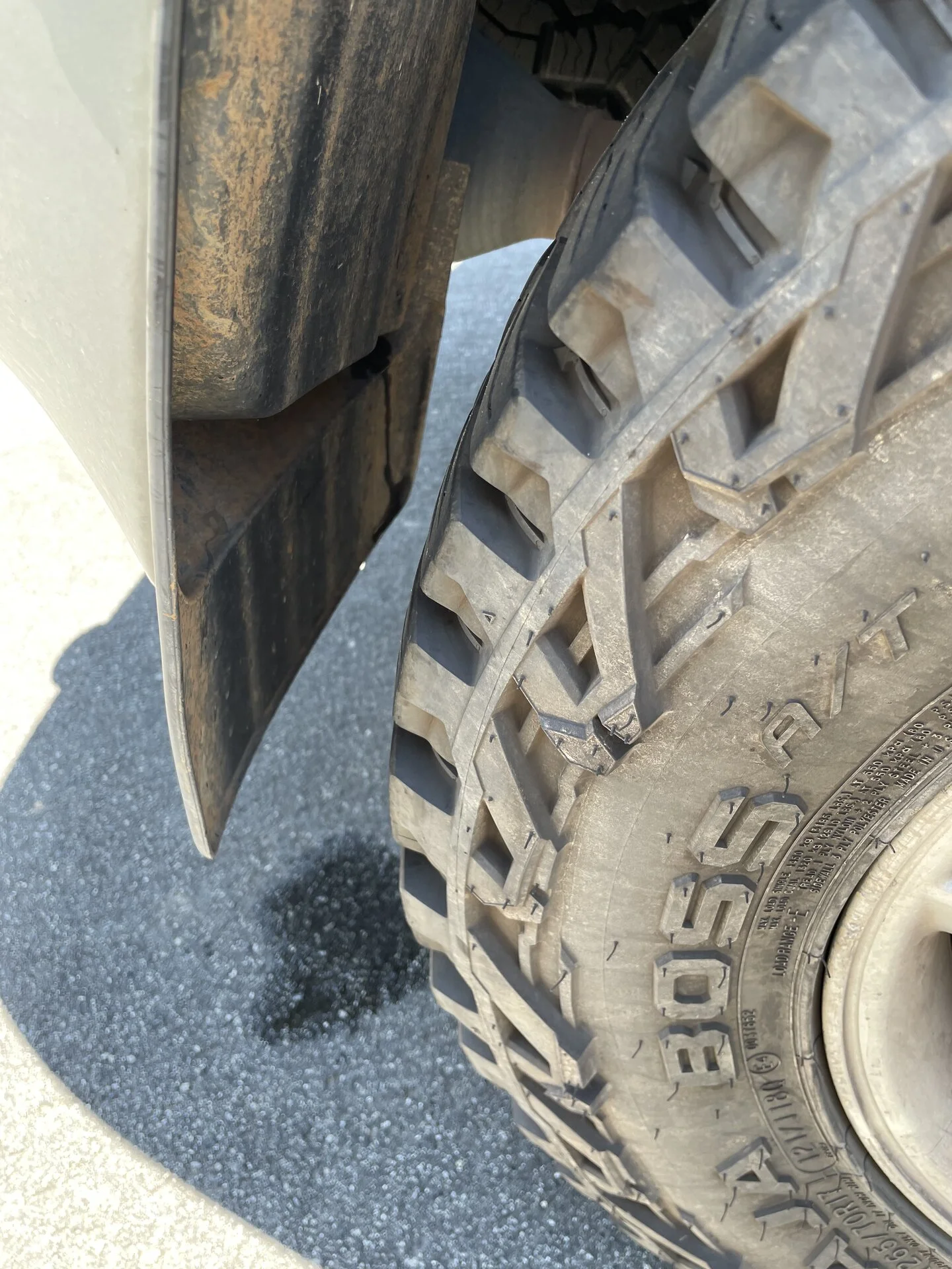

I noticed several times today when I parked that there was a leak at the rear passenger mud flap. Any idea what might cause that? It is hot and dry out so I wasn’t driving through any puddles. Thank you!

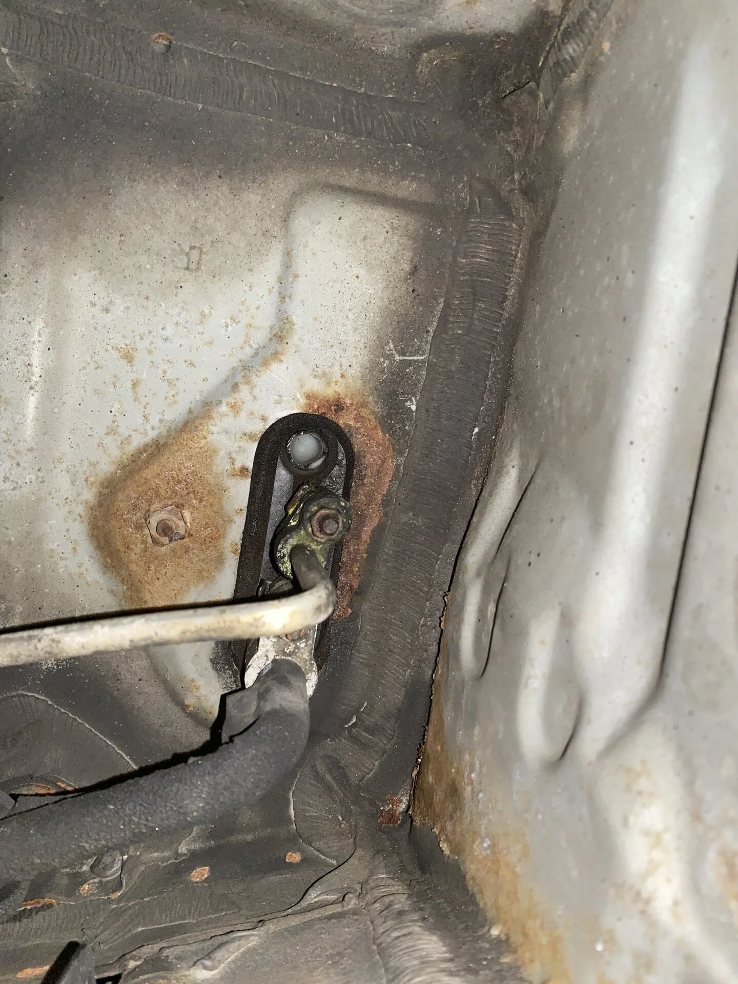

The rear AC hard lines go up into the body just behind and above the rear mudflap. I have not noticed mine leaking in that area but perhaps they are somehow related. You can look up in that area relatively easy, it's above the exhaust resonator.
I had a leak there, it was from the rear ac, and it was Freon, so check it out. I ended up blocking off the rear, because the connection there was rusted out.
