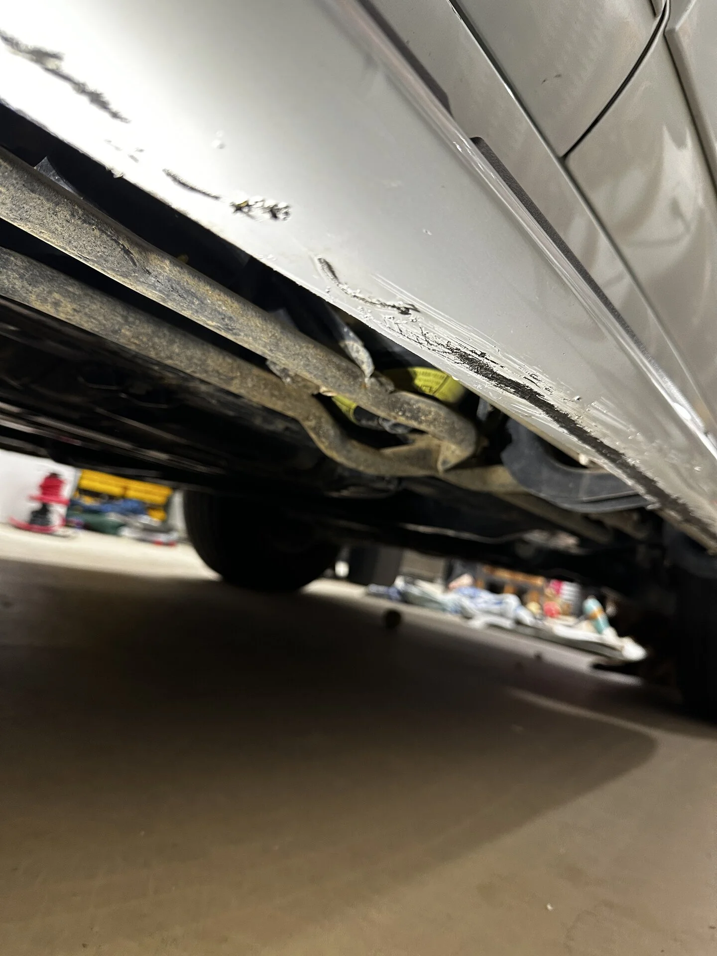

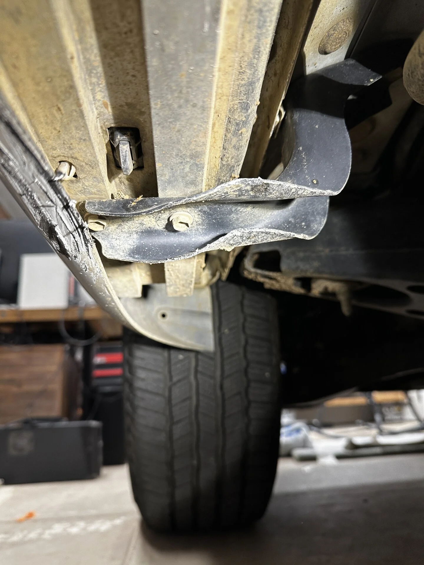

I was pretty impressed with the Taco on Miller Rock. Other than some pin strips, the only damage was some gentle contouring of the driver side rocker.
For a stock truck on mild 30” tires it did pretty well.

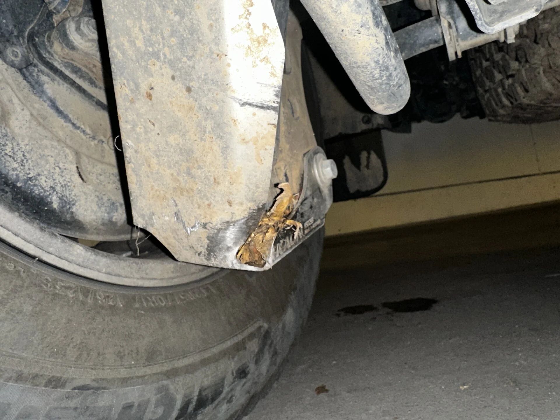

Ouchy:
Heh… Those are some serious chunks missing under there. 😳 Gotta love when armor earns its keep. We came out unscathed (Cole & I shared driving duties in his truck throughout), and there was only ONE hard use of armor fir us. It was one particular hit that surprised both Cole and I while I was driving. No damage, thanks to sliders, but was completely unseen by either of us. It happens… - I just paused, and we were both basically saying “What the bleep was that??!!??” But meh. It happens. Slider hits feel so abrupt when dropping hard onto their inner mount points. But I’ll take a loud, brief bang over a slow crunch any day. 😬
-Twas basically a hidden and abrupt front passenger drop, and I wonder if it was what carved the chunk out on your rig ( @Bullgump ).

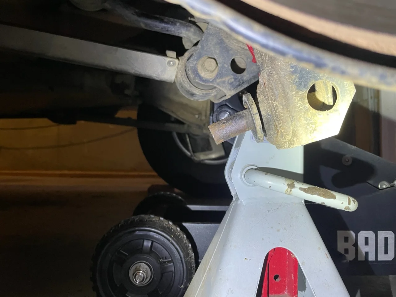

It is. And i.didnt notice till I did the mud removal and battle damage assessment today. The trail in which it happened is unknown but Miller is my guess. I went full send a couple times on that trail.
I've sent BB the pics and we spoke. New one will be on soon.
My rear shock guards are not BudBuilt (BB).
After LCDC IX, when my OME BP-51 rear shocks were being removed so they could be sent to ARB to rebuilt, damage to a rear shock mount was discovered.
Could a damaged rear shock mount be heated and straightened? Maybe...but the heat would weaken the rear shock mount. Would the straightened mount fail when on a trail like Fins & Things in Moab, UT? on Poughkeepsie Gulch in the San Juans, CO? on Black Bear Pass?
I do not run trails like 'Metal Masher' or 'Poison Spider' in Moab, but I am not willing to accept the risk that a straightened shock mount will fail on any off-road trail.
Unfortunately the shock mount is part of the rear axel housing assembly (42110-60A52).

I’d heat and straighten but I think worst case a decent shop could grind off the old mount and weld a coupling nut inside there as a replacement.
I’ve also seen a few people weld a bolt higher up to get more shock travel, so you could cut out the old one and do that and then your shock would mount up with a washer and a nut instead of a bolt.

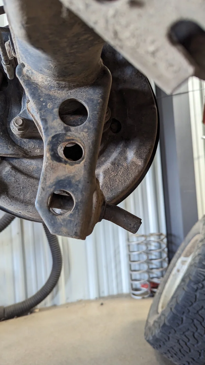

Hey @elkeye, just pulled my driver rear BP51 shock off and found this:
A slight bend. I was able to temporarily put my OEM shock back on. Not sure what I’ll do to fix it. Probably heat and bend it back. Tempted to just ignore and keep rolling but I do think the bend doesn’t make the bushing very happy.
