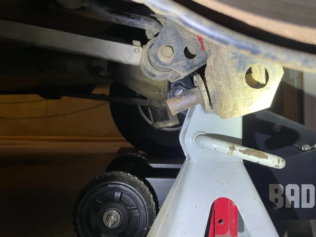

Hey @elkeye, just pulled my driver rear BP51 shock off and found this:
A slight bend. I was able to temporarily put my OEM shock back on. Not sure what I’ll do to fix it. Probably heat and bend it back. Tempted to just ignore and keep rolling but I do think the bend doesn’t make the bushing very happy.
Amazing you managed to bend it.
Personally, I think bending it back sounds reasonable. -Not a life and death failure point. Just a bummer.

My guess is that I bent it before I put the BB guards on. Not quite sure how to bend it back. Sure I can heat it but I don’t really want to hammer on it and bang it all up. I’m thinking maybe bore a hole on a bar and use the bar as a lever? Or maybe make a metal bushing to slide over the pin and hammer on it?

The rear shock mount, like a coupling nut, has inside threads that may get damaged when trying to bend the mount back.
One idea to bend it back was to heat the mount and bend it back using a section of pipe (with a slightly larger inside diameter than the mount) as a lever. Keep our fingers crossed and hope for the best.
The question is how does the shock mount get bent downward?
Could the rear shocks have too soft of compression setting and bottom out … thereby allowing the shock mount to be pushed downward?

The pipe idea is what I meant by boring a hole in a bar. If the fit was snug enough, maybe it would keep the threaded hole round. Or maybe you could just thread a long bolt into the hole and use it as a lever to bend the mount back up.
As for how it got bent downward, I think I (we?) probably dragged the mount over a rock. If the shock bottomed out hard enough to bend the mount, I’d think that would have blown up the shock or bent the upper shock tower/mount.
These bent shock mounts are the reason we never made shock guards. We could not see a way to add that to the truck and not create a huge level point on the mounting stem when you hit the shock guard. I would rather deal with the bolt being damaged or worse case the shock vs. a new axle housing or trying to recreate a shock mount on the rear axle housing.

I've moved this topic to a separate thread and speculate there the bending could be related to the guard itself:
