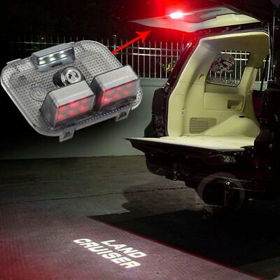

LC200 Rear Tailgate Cargo Interior Light DIY - Total Cost $26+tax

As to pricing, I ordered the lights that were referenced in the original post. I don't mind paying for leg work and creative content, within reason. But I have seen similar things on other threads on lighting, so I didn't think the mark-up was worth it to me and agreed with the original poster of this thread. Ordered the light (red) and switch, no sweat. They are here.

Doing the mod again in my latest LC. The final product. Cost a little higher as couldn't find single unit with white color LED being sold and had to get a set of two.
Where are you finding the white LED? I only see the blue and red on the amazon link. Or I will buy your extra if available.
