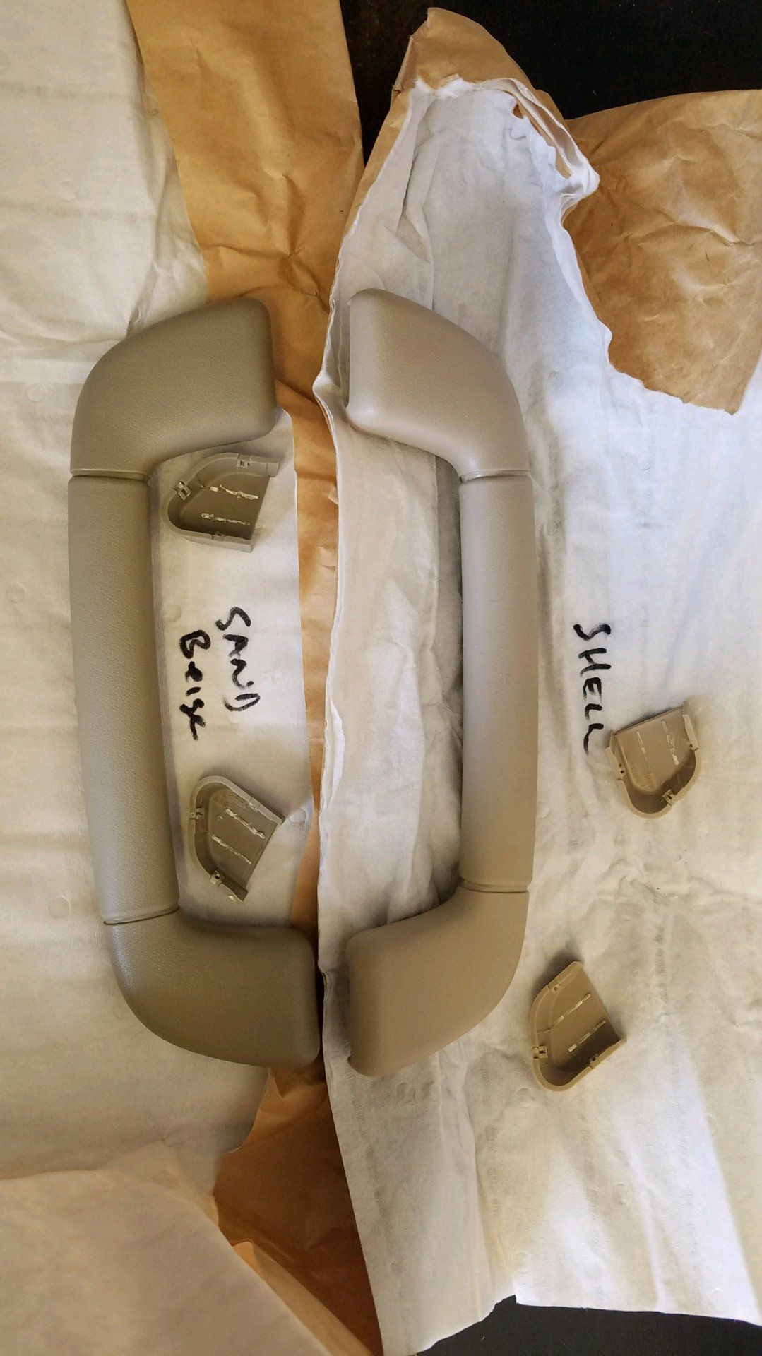

We've just assembled another 10 of the rear entry switch kits in various flavors and added the Shell color to our lineup. Let us know if you need a switch kit. Specs and details here: 200 Series Rear Exit/Handle Kit - Now Shipping!
Shell vs. Sand Beige for reference
