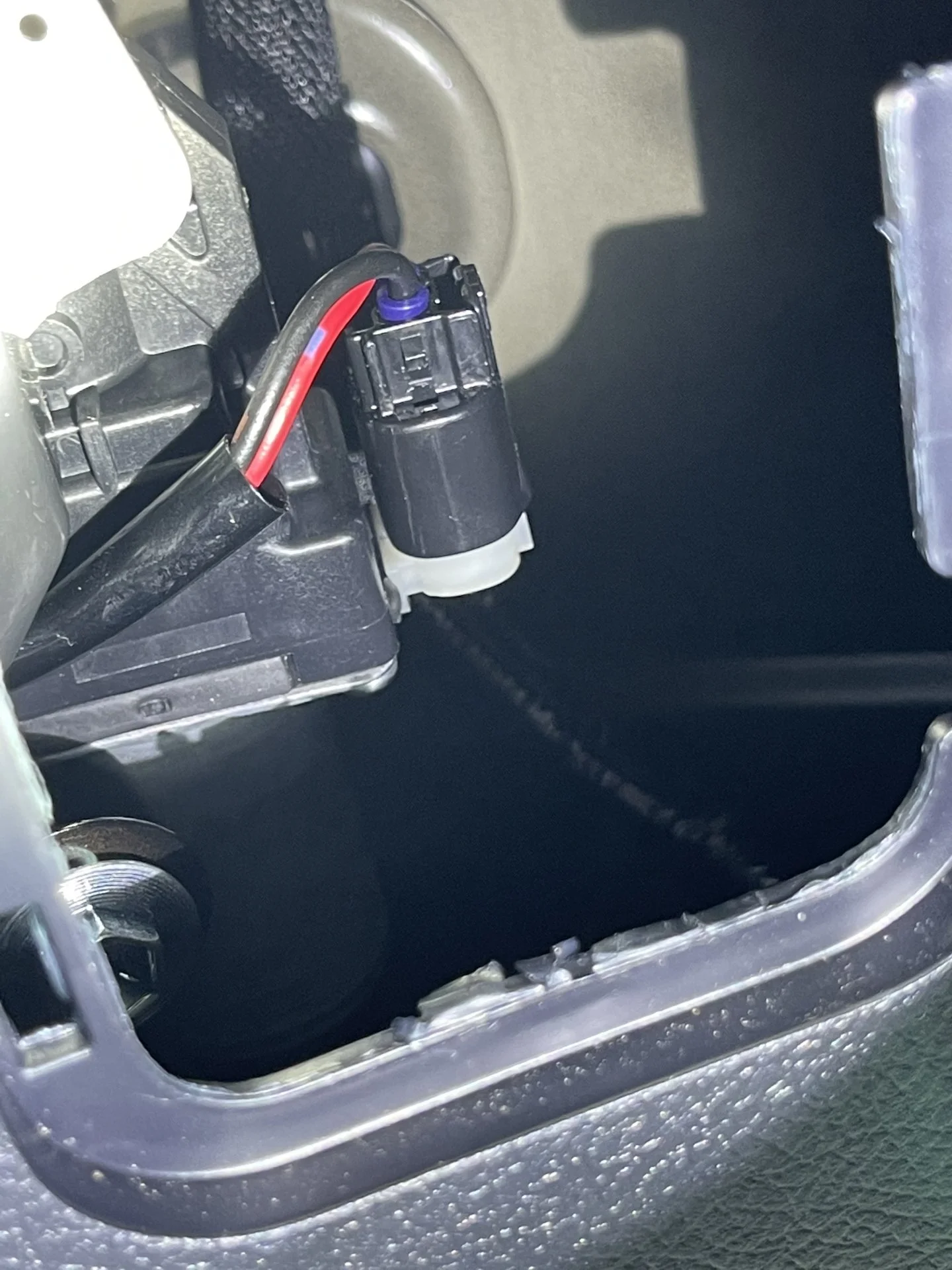

Purchased one of these for my 2017 Sahara. Very well made.
For the life of me I cannot get the tail gate switch out. No way I can push it out from the inside. Using trim kit removal levers from the outside I have it very loose but cannot pull or pull/push it out. I started applying force and heard a loud crack and the sound of plastic flying around inside the tailgate.
Before I resort to pulling the tailgate apart, does anyone have any ideas?
I did try to remove the plug and try to plug in the light leaving the switch in place, but can't quite get my hand in the right place.
Thanks
Nick
Hi Nick
It is only the center or “moving” part of the switch that you push out from the inside of the tailgate, not the entire switch housing including the outer flange section. It seems counterintuitive but if you push and wriggle just the center part where the plug joins the switch it will pop out and leave the outer flange section still firmly in the tailgate. Hope that helps. I confirm that it is a well-made awesome bit of kit once you get it connected and working!

Thanks cube. All sorted.

Now that cube helped me know how to remove the switch, it was a 5 minute install.

Thanks Brendan. Received my light. It took 5 minutes to install and looks great/works great. Hardest part was figuring out how best to remove the lift-gate close-door button. I was able to stick my phone in the hole and take a picture which showed where the tabs were and where to push for removal. Easy.

I found the best way to remove the switch fixture is to reach into opening and feel around the perimeter of the opening and feel for at least two tabs. Carefully push them out and fixture will easily be pushed out.
Don't feel like the lone ranger. I broke mine too during my first attempt to remove it.
