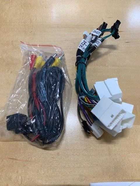

Sounds like you need to have the vendor send you the "high end version" cable. Mine didn't work at all without that cable. However, it would control the "rear" on/off control.

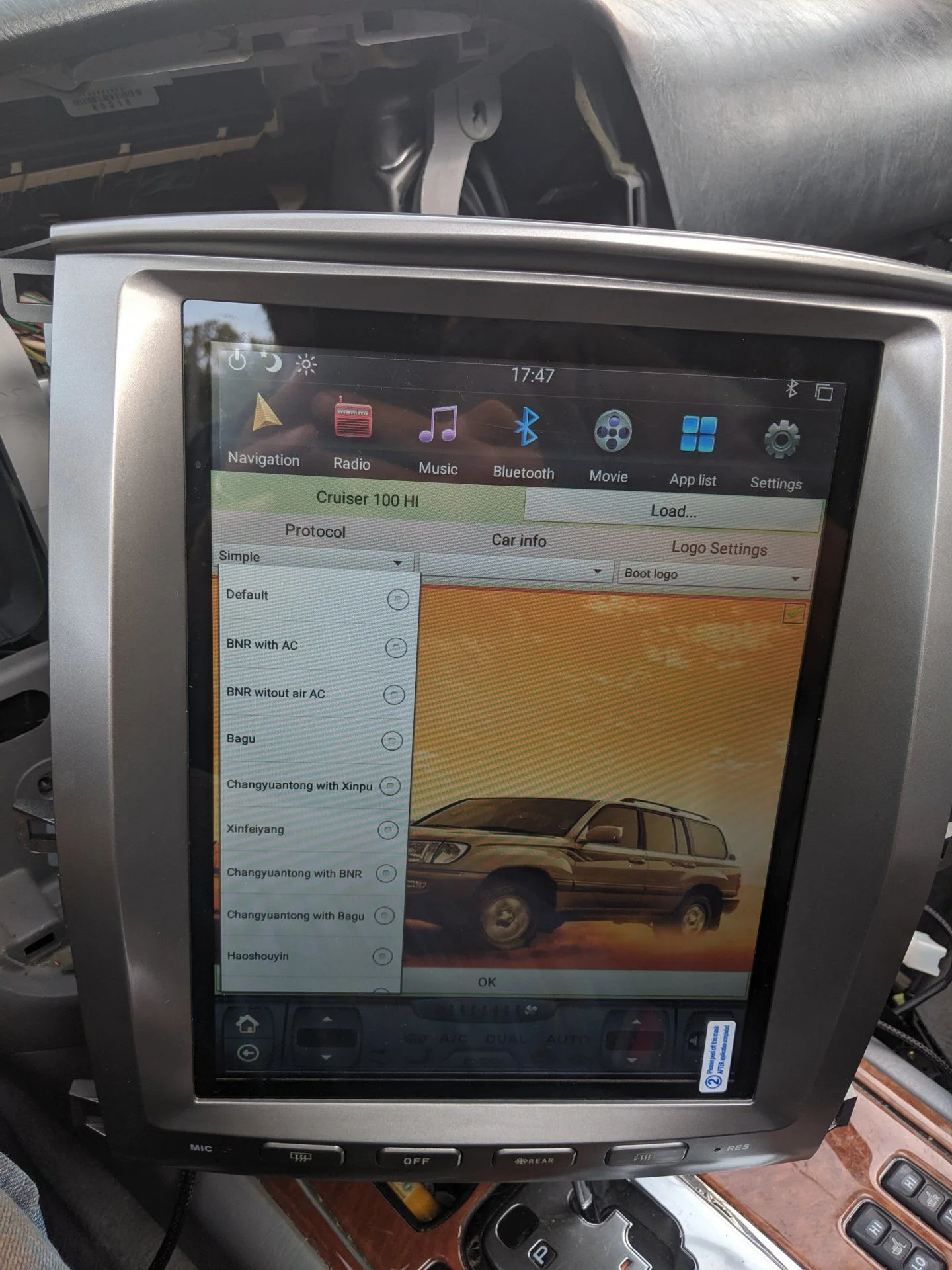

Hey guys. Need some help here. Purchased the PX6 version from AliExpress and received it a couple days ago (knowing the common issues that most have had and have been able to sort out).
Got it installed yesterday and was stoked to have climate control back for the first time in about 4 months! However, no volume/sound on any platform. Other minor issues like no rear climate control (would kick on sporadically for about five seconds at a time but couldn't adjust anything) and no backup camera which is an easy fix.
In an attempt to remedy the lack of sound, I followed @mistered123's instructions to splice together the various stereo and amp wires. Unfortunately, in my case, this did absolutely nothing. Still no sound whatsoever.
As a last resort, I did a factory reset thinking it might help. The complete opposite happened and I'm now left without climate control once again!

After you reset to factory settings did you go into the menu and reset it to the proper Land cruiser car type? Might be worth a shot.
This sounds promising. It's still set to Cruiser 100 HI. However, I have no idea what 'Protocol' to set it to for a 2004 Land Cruiser. Any idea what yours is set to?
I believe that's the wire harness I have. It's ZF-1301S

I HAVE CLIMATE CONTROL! Thanks so much to @Wetwillie for directing me back to the car type settings! Protocol 'BNR with AC' worked for me. Be sure to go back a screen and click 'Save and Restart' to reboot your head unit with the new protocol.
Would be curious to see if anyone has their climate control working on a different protocol. Everything works except my rear air adjustments. Can turn on/off but can't adjust anything. Not at all a deal breaker for me. This is probably the furthest I'll look into it.
