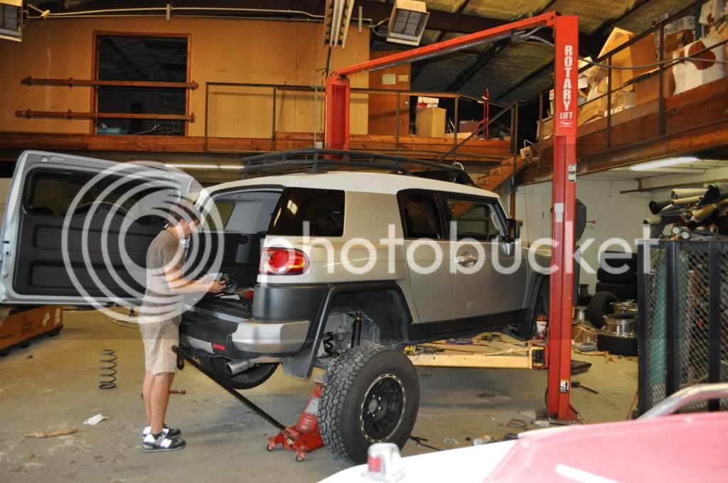

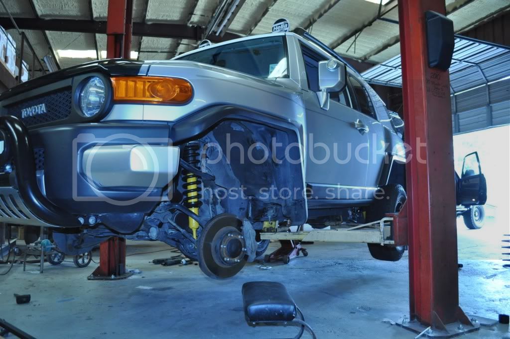

I removed my OME suspension from the FJC to sell and on Saturday installed an OME suspension (different one ;)) for a local member, Hodges. Turns out, i somehow know his brother from back in the day and he and i were friends with a lot of the same people in high school. I even had his bands sticker on my guitar, haha.
Parts
Had to modify his stock skid a little bit so that it would fit with his bull bar. Some sawzall and grinder wheel later here is what was left. I tried to convince him he needs a "real" bumper :jester:
Some shots Hodges got of me being a dirt covered mechanic. And to think my other job is as a Physicist, haha.
Note to self:
Never install a front suspension again without a tierod puller!!!
It is a PITA to remove/install the front coilover. It's doable though after a lot of trial and error. However, when installing my stock suspension, no go. Had the stock bottle jack on the UCA pushing down with the base upside down against the inner fender with the load spread on a piece of wood. Still no go. Unbolted the front diff to allow more droop, no go. Went bought a tierod puller and disconnected the UCA from the spindle. The coilovers installed in about 20 minutes using this.

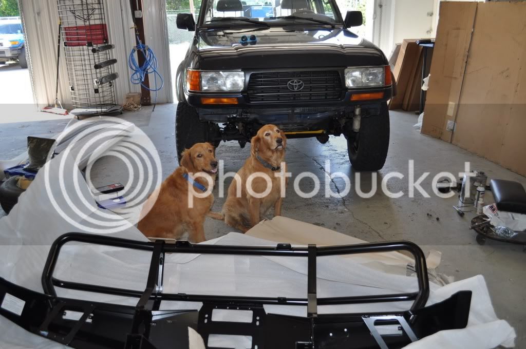

ARB IS ON!
Getting started.
Part of packaging removed.
Bumper off, re-tapped all weld nuts to ensure they are clean and grinded, painted.
Also, my pooch and my parents pooch who i am watching while they are on a road trip across the country.
Done with lights (Light Force not wired up yet, didn't have the time this afternoon)
And the pooches ready for the ride home :)
