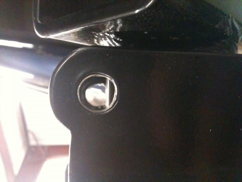

Install went alright but i do have some issues.
-One of the 12mm weldnuts is stripped so i need to fix that. Probably gonna run a 1/2-20 tap and get a grade 8 SAE bolt rather than going to a 14mm sized bolt and having to possibly enlarge the whole on the bumper, also not sure if the weld nut is big enough to drill/tap to a 14mm.
-The tire swingout holder piece sits too close to the tailgate to mount the hi-lift on. The mount for the hi-lift sits too close that is. If the mount wasn't there i am sure it'd be fine.
-The way the holder mounts to the vertical section is with two bolts that clamp it in place. The bolt holes are not high enough to get bolts through. I could take a file to this section.
I just emailed Luke at 4x4 labs about these issues and will be waiting to hear back from him on how to proceed.
My only guess is that the vertical section of the tire carrier is not slanted away far enough or it wasn't built to also accept the hi-lift holder as well.

Here are some though.
These are just iphone pics, the real pics are on my DSLR and i won't have those up for a few days.
You can see how i have the exhaust re-routed as well. I got a little painting crazy and also POR-15'ed the exhaust tip. Not sure why the pictures got rotated sideways.
It looks like your upright for the spare tire sits much closer to the tailgate than mine. I'll try to get some pics taken tomorrow and post them for reference.
The two bolts holding the spare tire attachment were a pain to drive through on mine as well, the powder coat was too thick making the fit too tight. I drove mine in place with a hammer and just barely threaded them through.

Just heard back from Luke at 4x4 Labs.
The upright section i received was for the tire carrier without a hi-lift mount. The one for the hi-lift mount is at more of an angle to allow room for the hi-lift jack. I thought this as well because in the pictures the tire on the mount was vertical. On mine, if i were to mount the tire the tire would be at a big angle. So the additional angle of the upright would make the tire sit more vertical.
Luke said he is going to ship me the correct upright right away.

Still waiting on the correct upright for the rear swing out. I checked the angle on the upright and Luke told me that the one with-out the hi-lift holder should be right at 78* w.r.t. horizontal and the hi-lift upright should be 72* w.r.t. horizontal. Sure enough, my protractor measured mine at roughly 80*. New one should be here in a few days. Hopefully Luke will offer me a slight discount on the can holder, but who knows.
