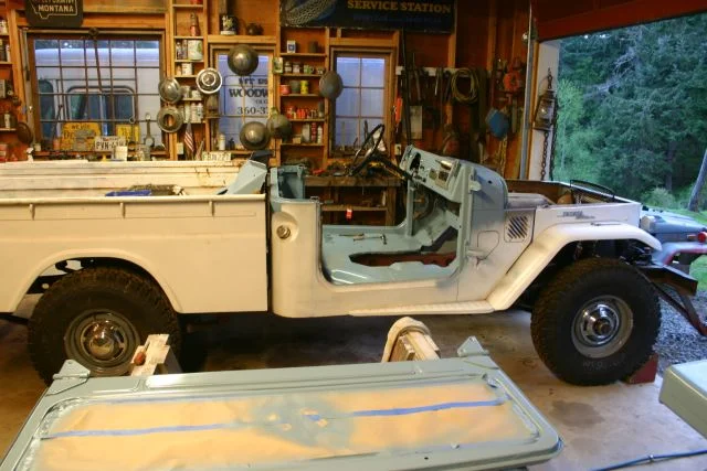

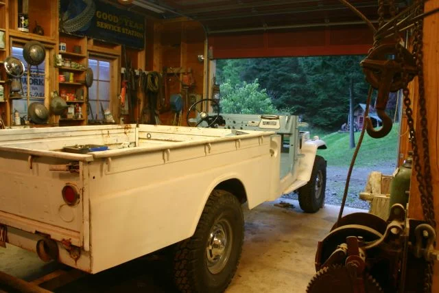

So yesterday right after work, I pulled the bed off and started cleaning the frame. Then last night I got out the torch and loosened all the bolts holding the fenders and bib, then put them back finger tight. I also did the same thing to the front axle, as I will be using the disc front end from the donor. I am just not ready to have my new truck reduced to a pile of parts just yet, so tomorrow I will start parting out the '76.I will need the pto drive gear for the 4 sp and I am unsure what kind of booster and master to use for the brakes. And what adapter is best? I have the master cyl from the 76 donor. From what I've read, this may interfere with the carb on the 2f. As far as the sequence, it seems I want to bolt the disc front end in first, then the engine/tranny, then the new master cyl last, because of clearance issues.

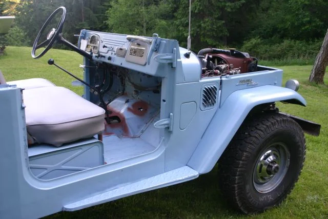

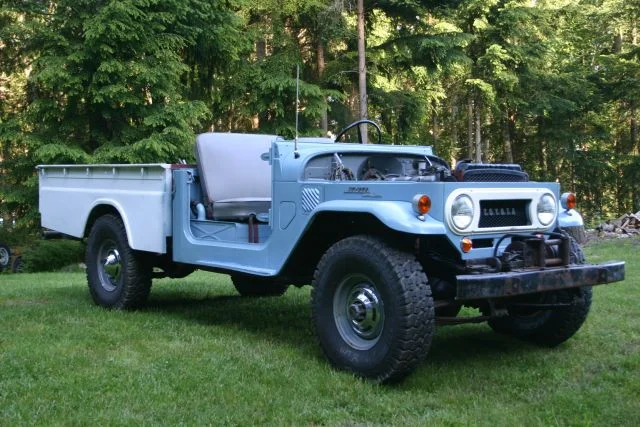

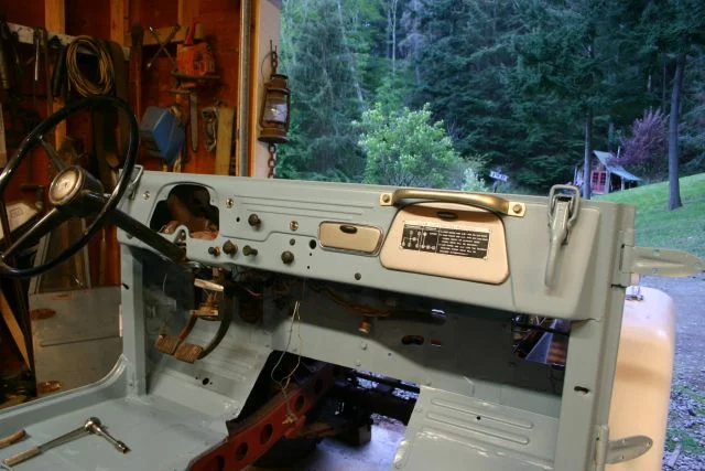

A bit of an update... I was gonna just 'freshen it up a bit' and drop an engine in it. Yeah right. So, Ive been spending money like a drunken sailor, and I'm not even a sailor. I'm ready to do the engine swap this weekend, and spotcruiser has offered to lend me a hand and some tech support as we'll need to split the tranny and xfer to install a pto drive gear. This is by no means a professional restoration, but all the rust was addressed and it's pretty good now. Used sor replacement fenders, the aprons and running boards from my '76 donor. Brakes still drums on all corners, but everything new. Lots of work on the pto winch, as well. I wrestled with the paint color and horizontal blue (still think it was supposed to be horizon blue, but it was lost in translation)won out, because i love it, and it was the original color. I made my own batch from rustoleum. Some gloss, some flat. It's a good match and looks like oxidized paint. It certainly hides my :beer:bodywork better than a high gloss job....The bed is just setting on 4 studs, and I'll work on it outside if the weather ever improves. Where's that global warming they've been predicting anyhow? I am really enjoying this project, and specially now that I am putting parts back together, I can see some light at the end of the tunnel.
