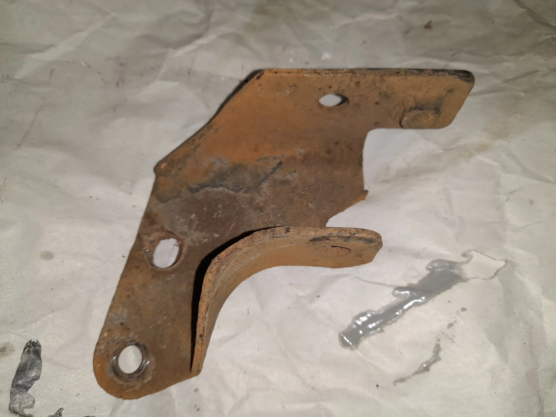

I'm looking for a picture, if possible, of one of the PTO drive shaft pillow block brackets from a late 60 Series.
There seem to be multiple arrangements of drive shafts and brackets. I'm not sure when the change occurred, probably late 87 with the facelift, but I have seen an early (1984ish) HJ60 with a single drive shaft, but later models with three separate driveshafts.
This is the front bracket, which mounts to the LH chassis rail not far behind where the drive shaft passes through a front chassis brace (open C section). I have just taken this off a 1989 BJ60. The other bracket is missing.
My question is: What does the other bracket look like? According to the EPC, it does not have separate bolts which makes me think it bolts to an existing joint, such as the clutch housing to engine bolts - but that may be wrong.
I would really appreciate a picture of this bracket, in case you have it.

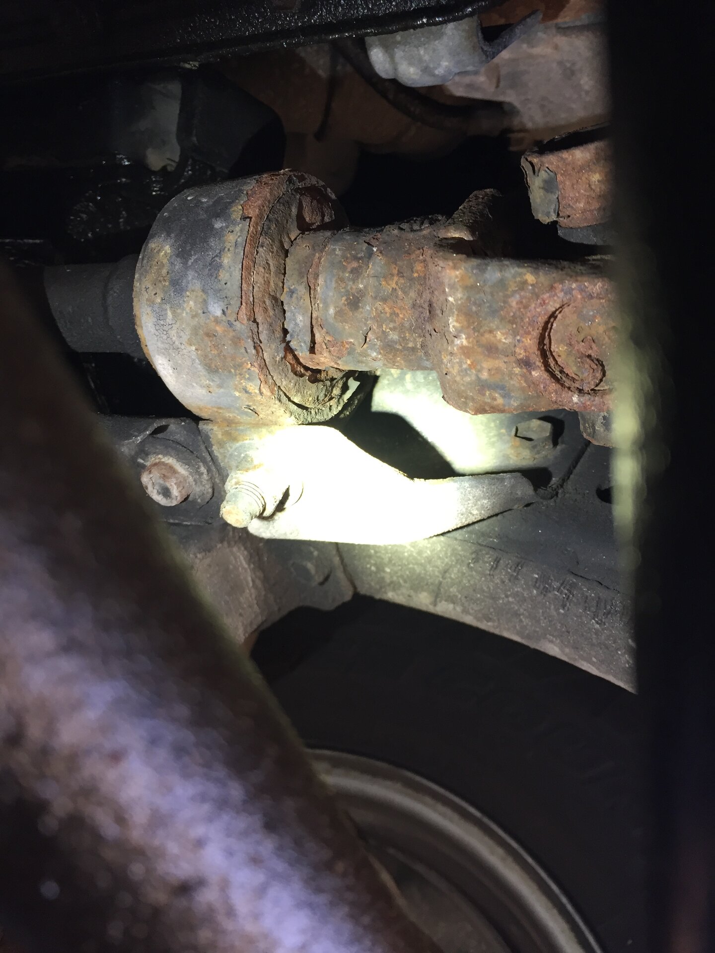

Hey man, lousy pic my apologies, I’m in hotel lot with a dying flashlight. This is a bracket about 20 inches from the last shaft into the transfer. It’s on the LH frame rail, and from there towards the front it’s in a narrow tray hooked to the rail.
88 sixty one JDM. If that’s it, I can get better shots w/ daylight tomorrow

Thank you very much - what model is this on?

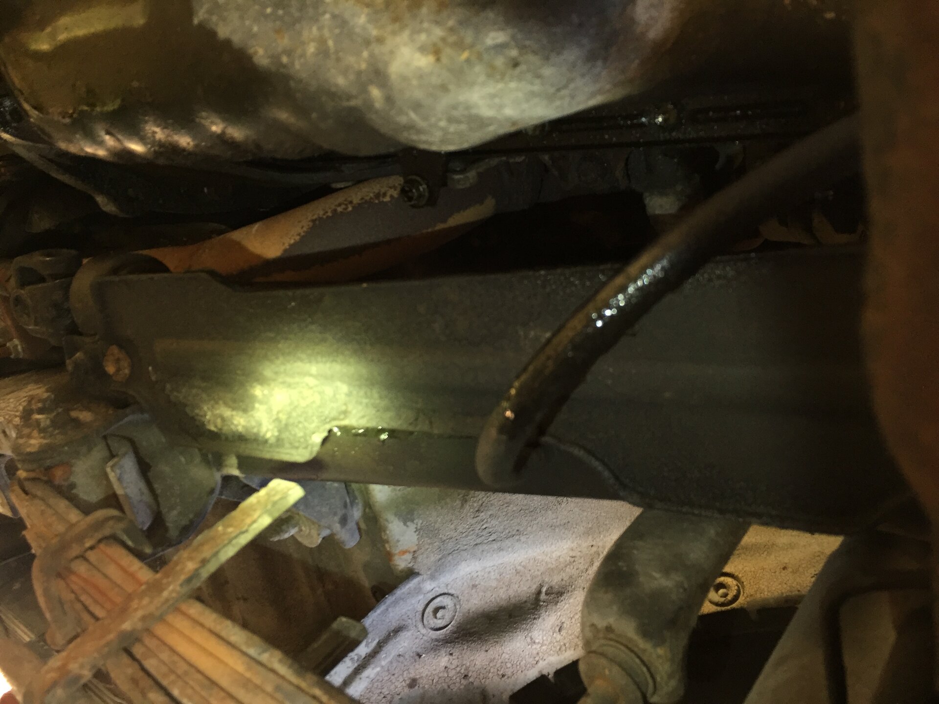

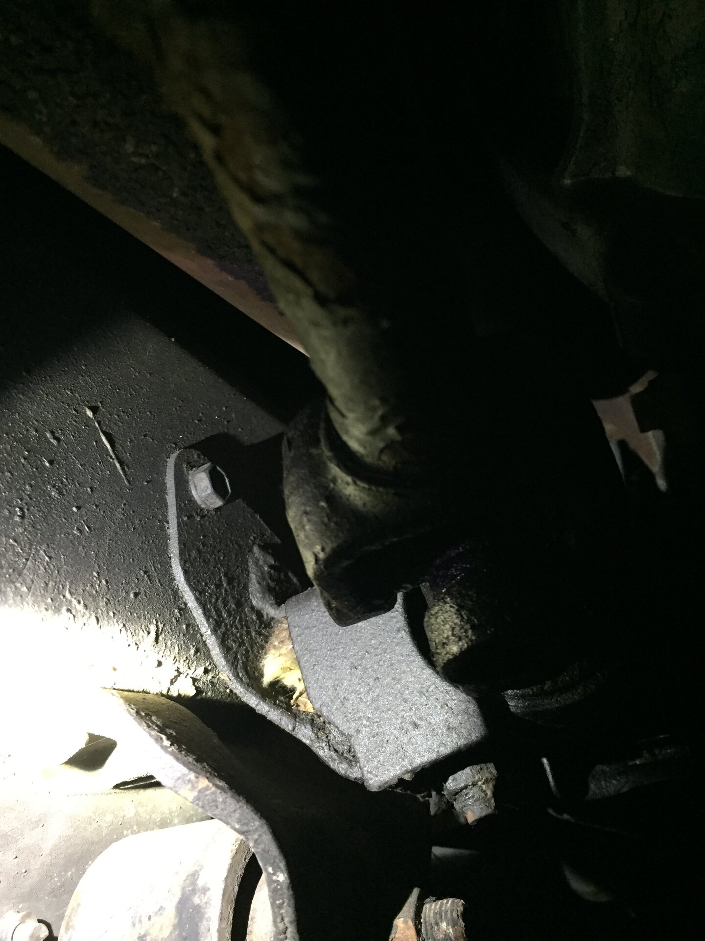

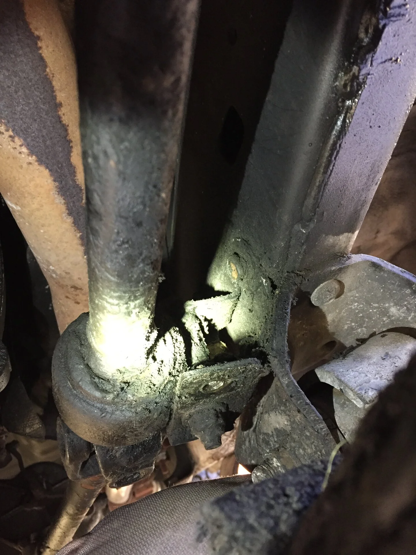

More pics- better shot of bracket near transfer, the protection plate, the bracket past the plate at the next shaft. Hope this helps
Wow, thanks for the pictures, appreciate the effort made!
I never knew that the HJ61s had a protective plate there. Seems the BJ60 did not get this. Now I want one!
