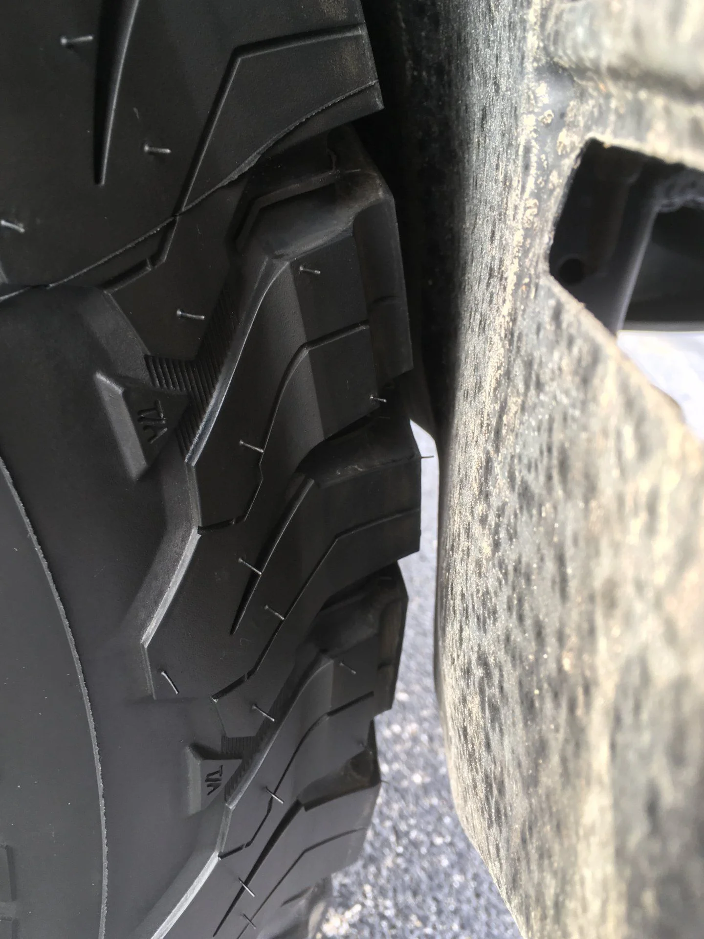

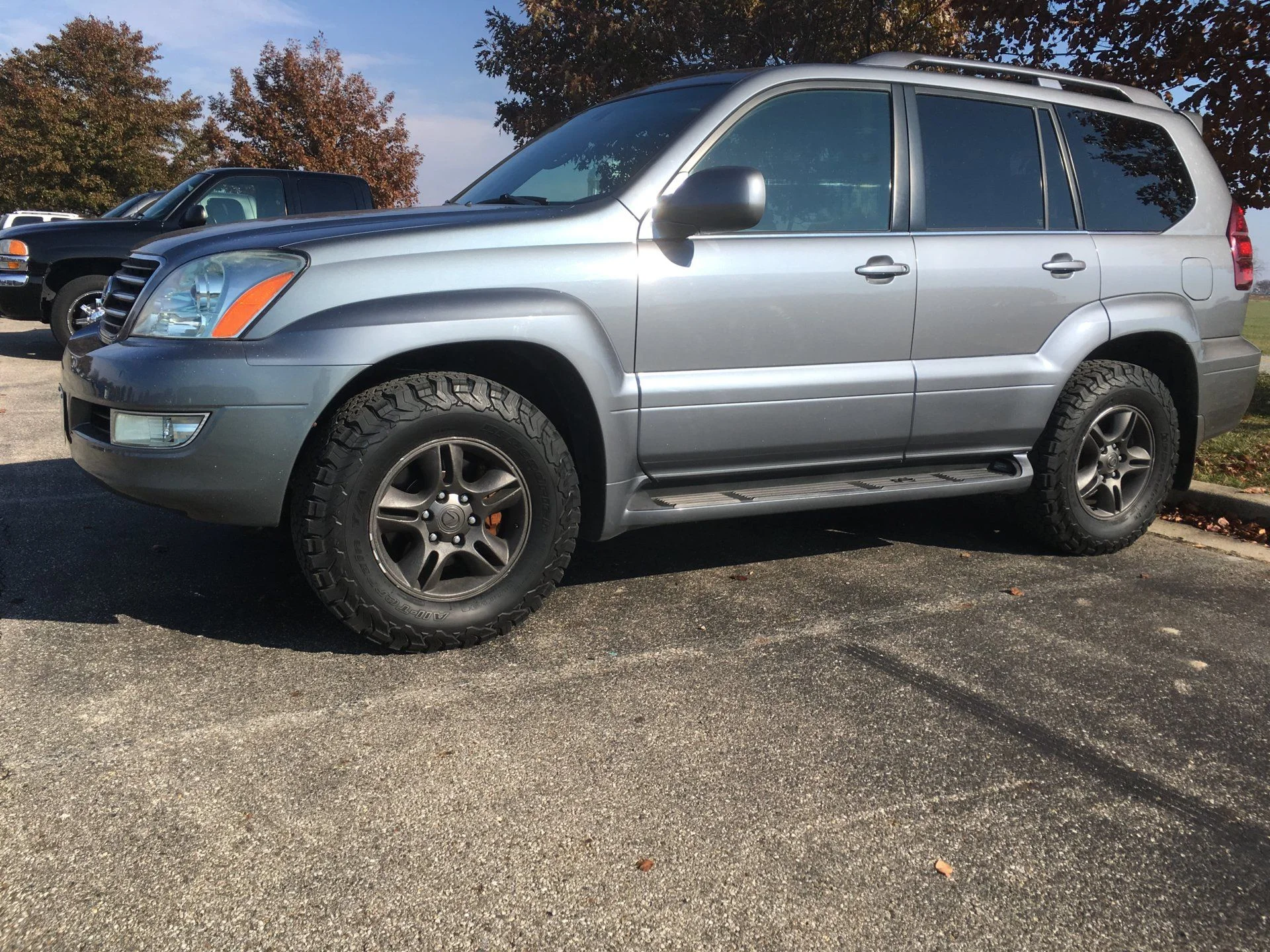

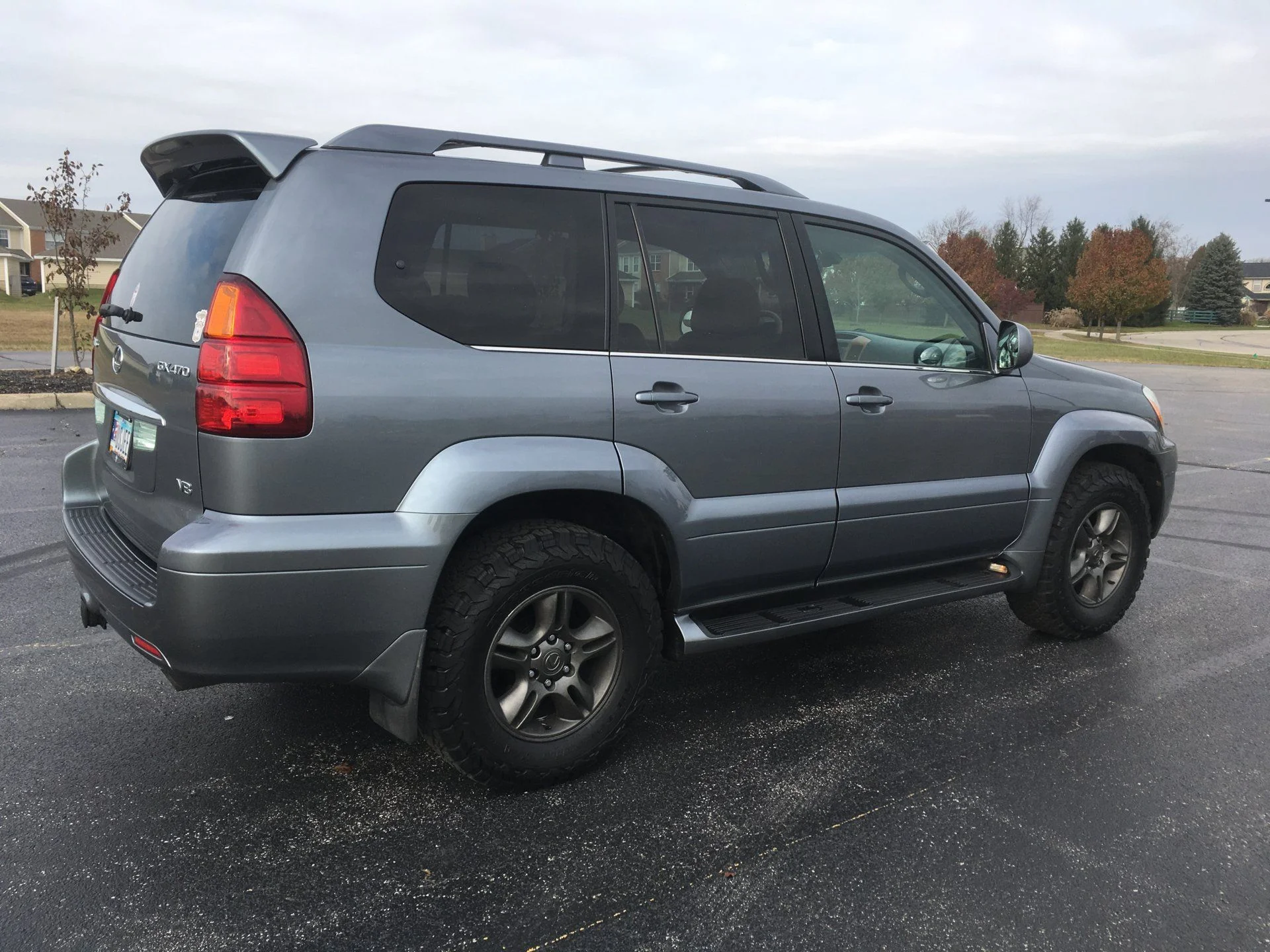

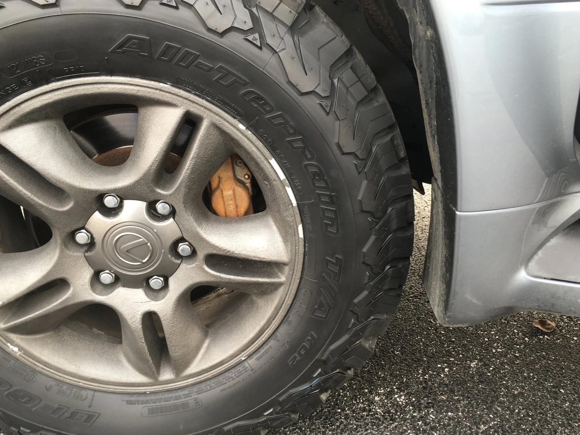

Just got new BFG KO2’s. Went with LT 265 70 17 on stock wheels and lift. No rubbing on full turn lock to lock. Only had about 1/8” clearance on the front passenger side. Was able to use my used BFG Rugged Terrain LT 265 70 17 from my FJC for my spare tire. I had 1/4” clearance fully aired up in the spare tire rack underneath. Don’t know how you could possibly go bigger without mods. MPG went from 18 to 16.5-17 on the first 100 miles.

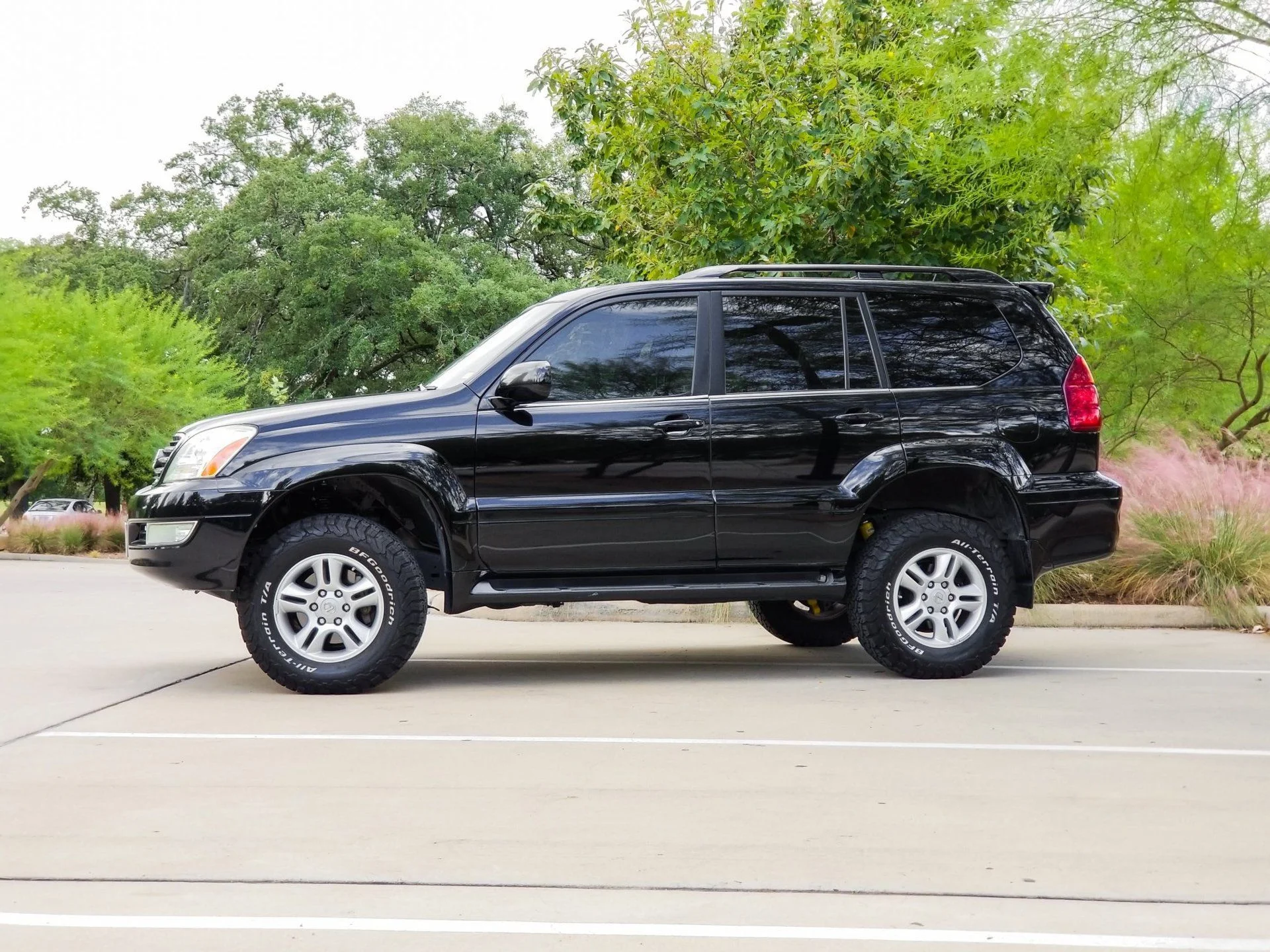

Went with the same same size(Nitto TG’s) and agree it’s perfect for stock. But I’ve got a lift on the way and I’m starting to somewhat regret my decision. But having seen some pics with a similar lift and shoes, I’m feeling ok about it for the time being.
Case in point. Here is a fella’s GX from GXOR with a Dobinson 2.5” lift and 265/70/17s. I think it looks really good with a nice balanced stance. Can’t remember his name but, I saved his photo for reference for my build.

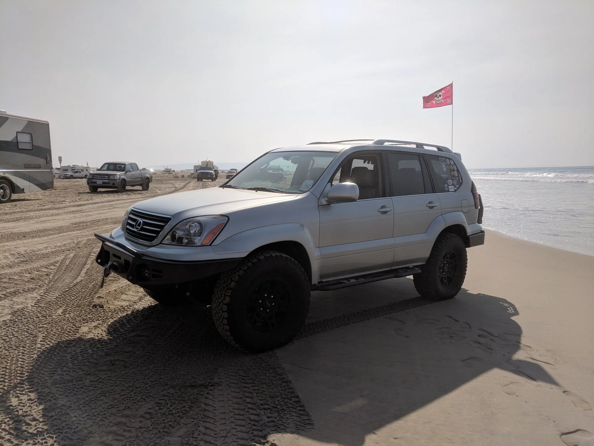

Not stock lift but just for comparison.
315/70R17 with OME lift. Lots of fender trim and body mount chop. Rubs a bit on full lock.

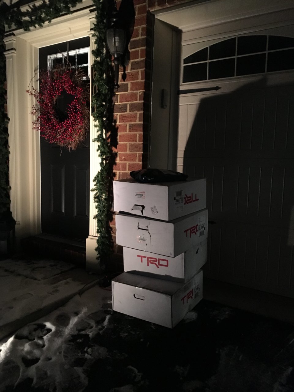

Rims came today. Does anyone know if I can run non-TPMS valves stems?
