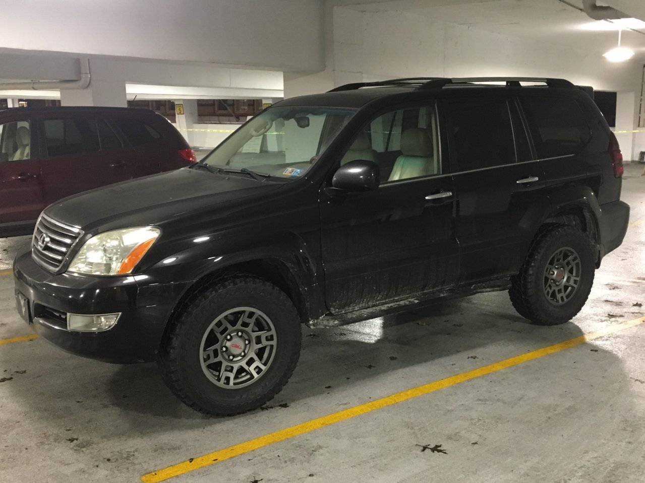

I had these mounted last night.
I did have to do the fender liner mod to get the 275s fit. It took 20 minutes in my freezing cold garage, so not very difficult. Video here:
My initial assessment after driving them home last night and then to the city this morning is they feel heavy. The ride itself didn’t change much (no jarring or stiffness), but I can really feel them when I brake and turn the wheel... especially when changing lanes on the highway. They also wander a little bit on the highway. I don’t remember my E rated BFGs on my TJ feeling this noticeably heavy, but it was a solid axel and I did have a beefed up steering stabilizer, so maybe that’s why. The suspension on my TJ was also much stiffer, so I’m guessing stiffer suspension on the GX will help as well.
It’s not unbearable as it is, but something I’ll have to get used to. No more 85mpg during rush hour for me.
Thanks for the update. Its a big tire for the IFS. It makes the suspension, brakes and all the components work a little harder. How did the MPG change? Let's see some pics when you get a chance.
275/70r17 S/T Maxx on TRD Pro wheels (+4mm offset vs +25mm offset factory). Factory suspension. Factory UCAs. No lift. Factory running boards removed (SSO sliders installed). Front wheel well liners moved forward (see below). No rubbing. At least 2” between the tire and the UCA. About .5” clearance on the cab mount when the wheel turns and the same amount on the front wheel well liner.

Looks sweet. Love those wheels. Looks nice with the black GX. Thanks for the info on the set up.
@joabmc I bumped up the pressure and put a few hundred miles on them and they settled down considerably. The wandering is gone. They’re still heavy haha but I got used to it q

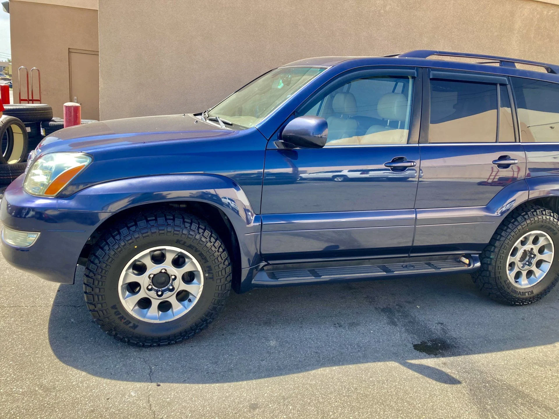

My MK6's finally arrived in Tokyo 4 months late but just in time before we see any snow. Went with 17x9 ±0 so about an inch wider on either side than your TRD's (4mm is negligible!) I have 275/70/17 BFG KO II going on them. I was pretty sure that fender liner trimming would be needed but the only local shop that I trust and has a machine big enough to mount/balance the tires...let's just say I'm probably going to have to drive home and mod the fenders after. (or before if it's bad enough)

Forgot to mention why I ask, bone stock suspension...no clue if the Prado fender liners and such will be much different than the GX. (My GX front, hood arrived over the break but still awaiting the running boards and MPD fenders)
